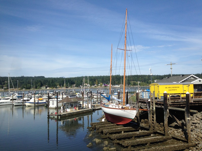

I'm really fascinated by the pictures of the boat on there sides.
24,797
Boats on their side is called careening the boat. Often used to work on the bottom i.e. cleaning.
Run boat into shallow water. Let tide go out and clean bottom as boat rolls on side.
There are some places that use Tide Grids to secure the boat so that the bottom can be cleaned.

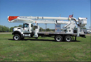

Another option is rent one of these:
Seriously, aerial lifts can be rented by the day https://www.bigrentz.com/equipment-...45-ft-articulating-boom-lift-diesel-dual-fuel just an example for about $300/day.

Home depot rents a trailerable boom lift. 35' high thou and you would need to put boat on a bulkhead next to parking lot to work on it
