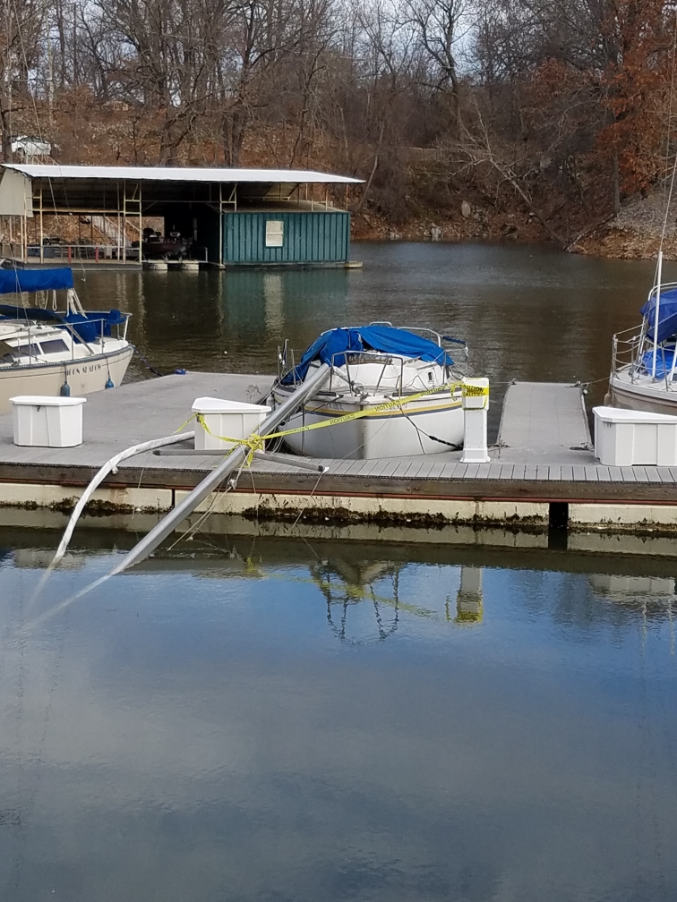

An S2 was demasted. How did this happen? All I can figure is that we had lots of waves in the marina causing the boom to swing with such force that the backstay failed. I would not have thought that was even possible.

Here is a pix of the S2 I think it's a 29 footer.

It will be interesting and instructive to see what broke on the dismasted S2. A reminder to everyone to check their rigging!

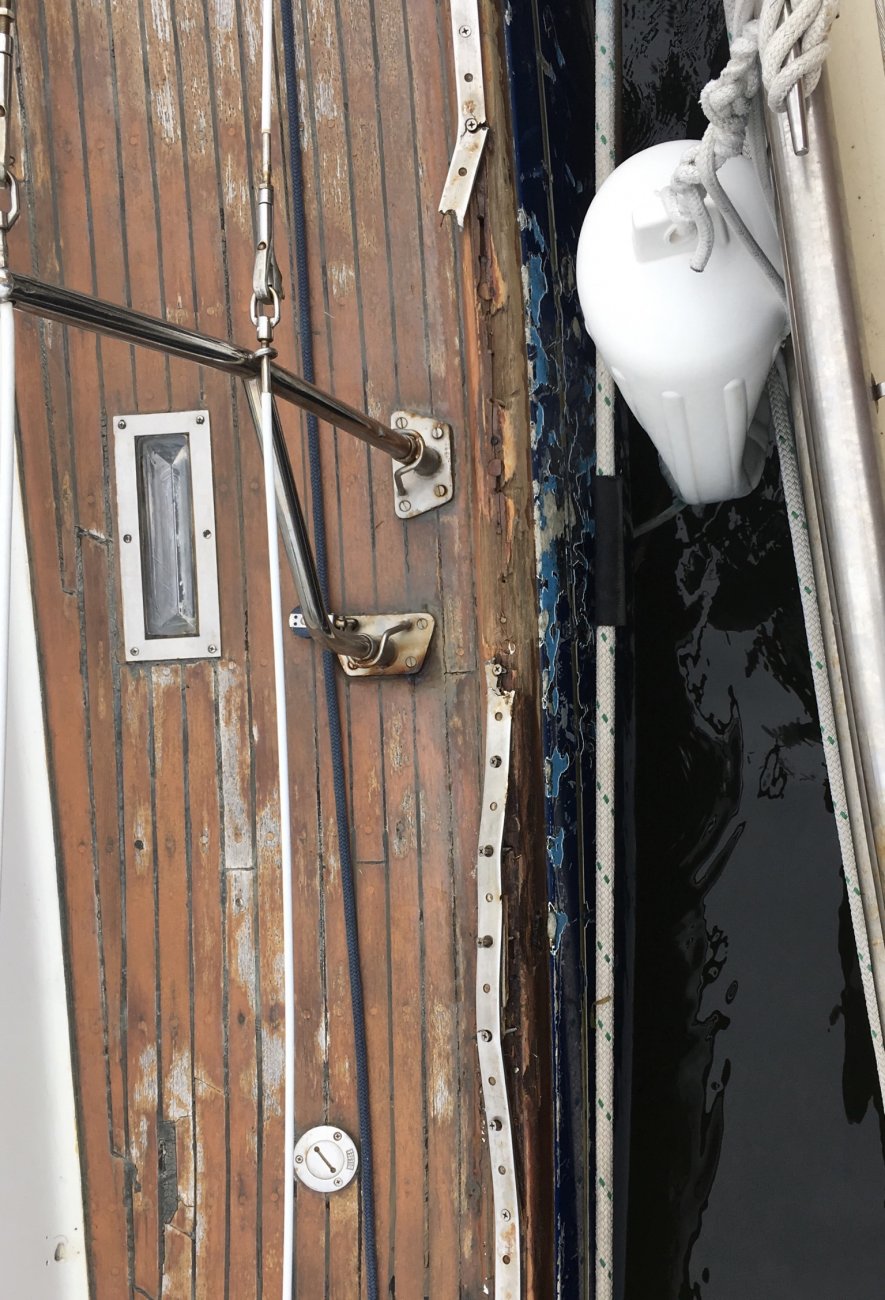

After IrMaria, here in the Virgin Islands, we found the damage in this photo on the boat next to us:
That damage was done against our side, BELOW THE WATERLINE! It’s gunwale was hitting below our waterline. They say the winds was so strong that the boats in the marina were laying over on their sides, with the masts nearly horizontal. We displace nearly 40 tons, and it was doing that with bare poles. They were reporting winds over 225mph, and up in the BVIs, there were reports of 275+. I believe we were seeing tornadic action along the coastlines during the hurricanes. We had 19 lines on the boat, plus 2 anchors Across the fairway with the 5/8” chains stretched tight to keep us off the dock. Several cleats in the marina were pulled out of the concrete, and even more that just broke off. The boat pictured above had single stern lines, the far one of which parted. Storms are indeed a bitch.

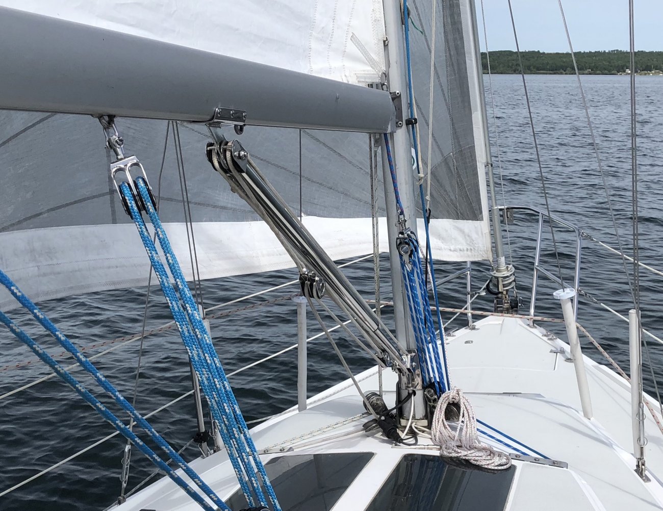

Have a look at the rigid versions from Garhauer. You might be even more surprised. We got the smallest one for the 270 and never looked back.

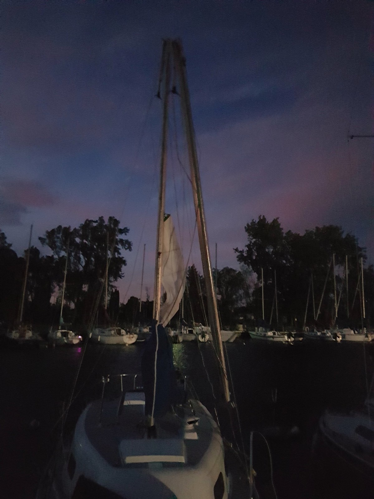

We had a nasty storm a year and a half ago with a fair bit of damage. One boat was sunk while sailing, several dock pods were moved, mine about 20 feet which broke my power cord. My boat and the C&C115 I race on both had bent stantions from being blown over into the dock. There was one mast broken (probably upper shroud failure)

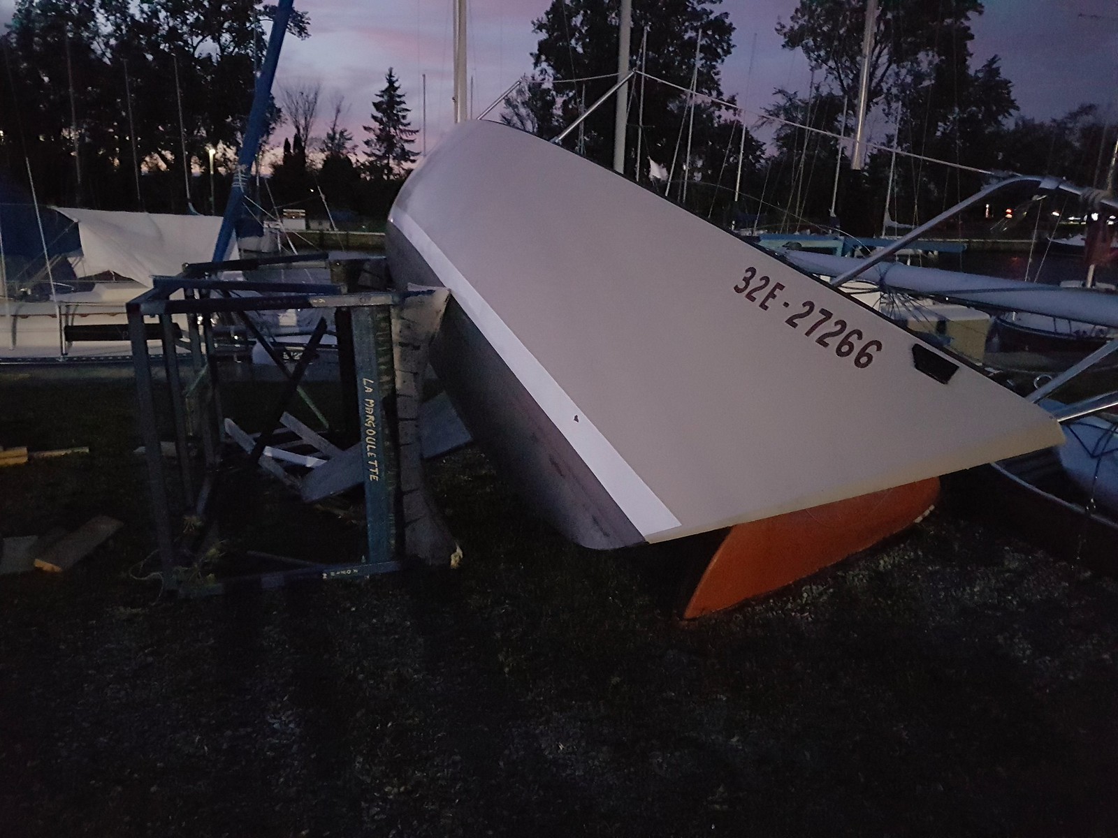

And a couple of boats on the hard were blown over.
