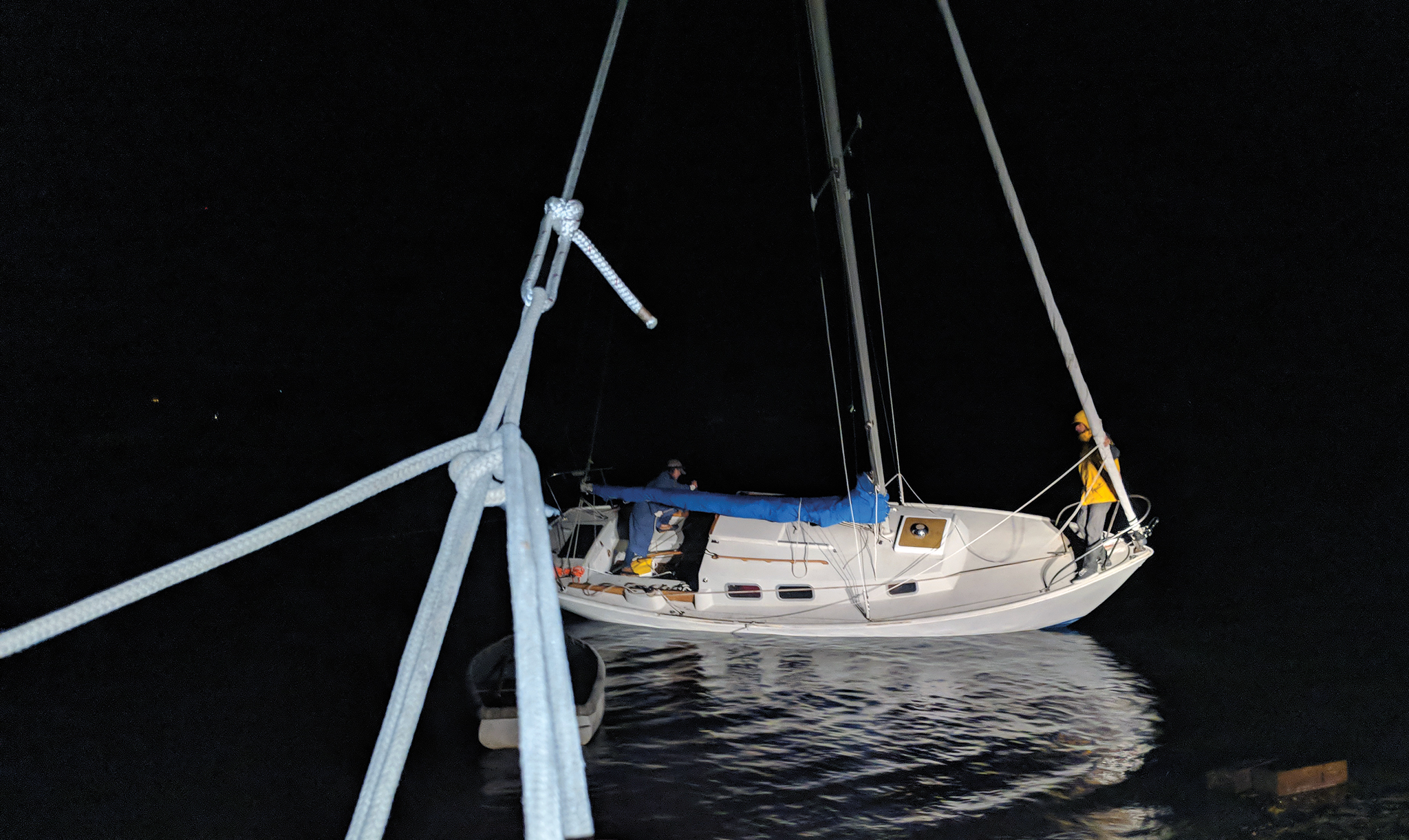

Will - thanks for the idea and especially the pictures. I think I'll pass on healing my boat that far over though. It is a cool idea.
