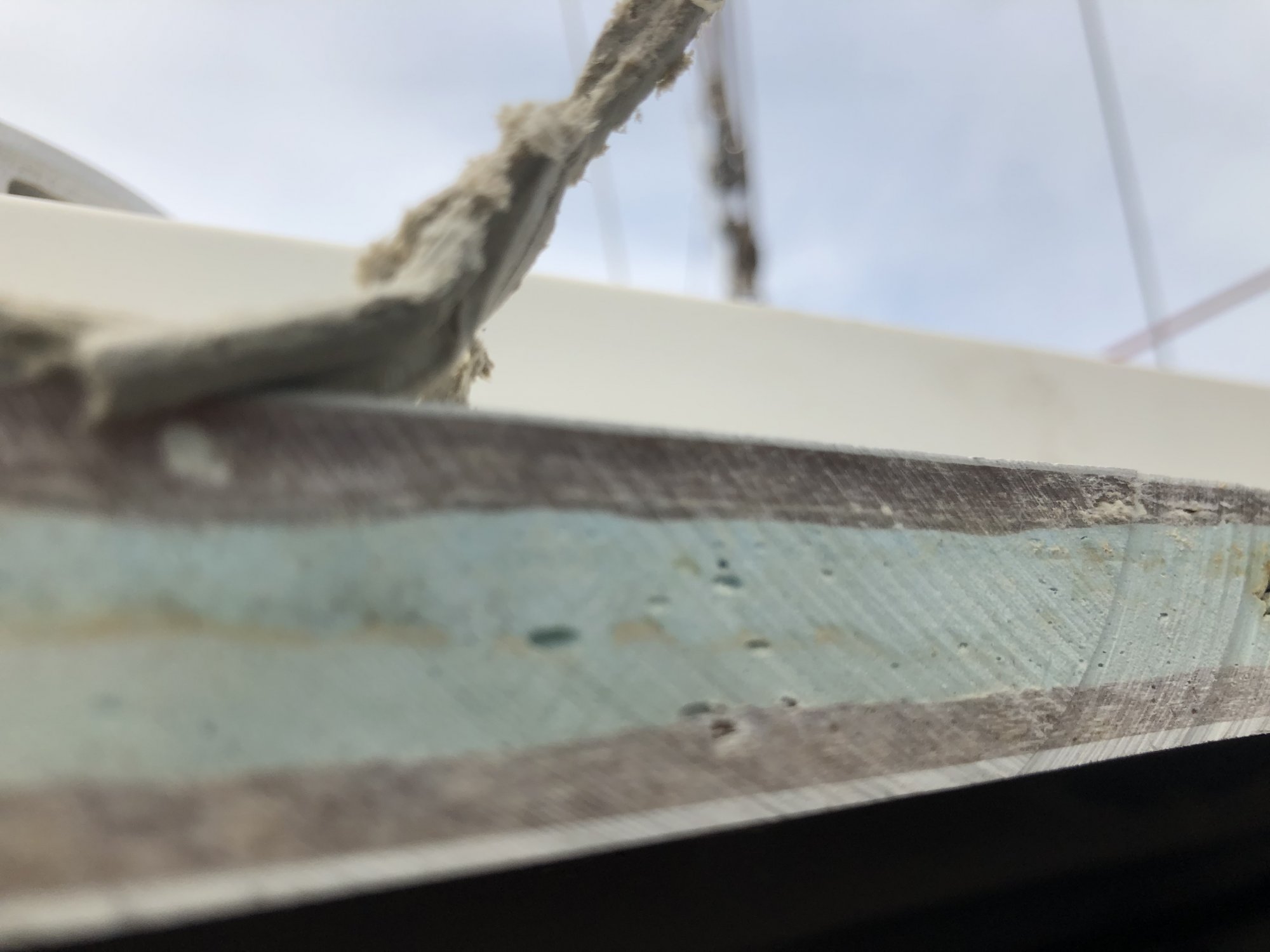

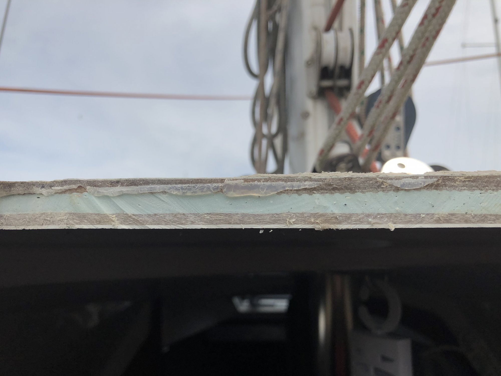

I think the deck is cored with some sort of foam, so less prone to rot than balsa. I say that because when I pulled the main hatch, I found this...
