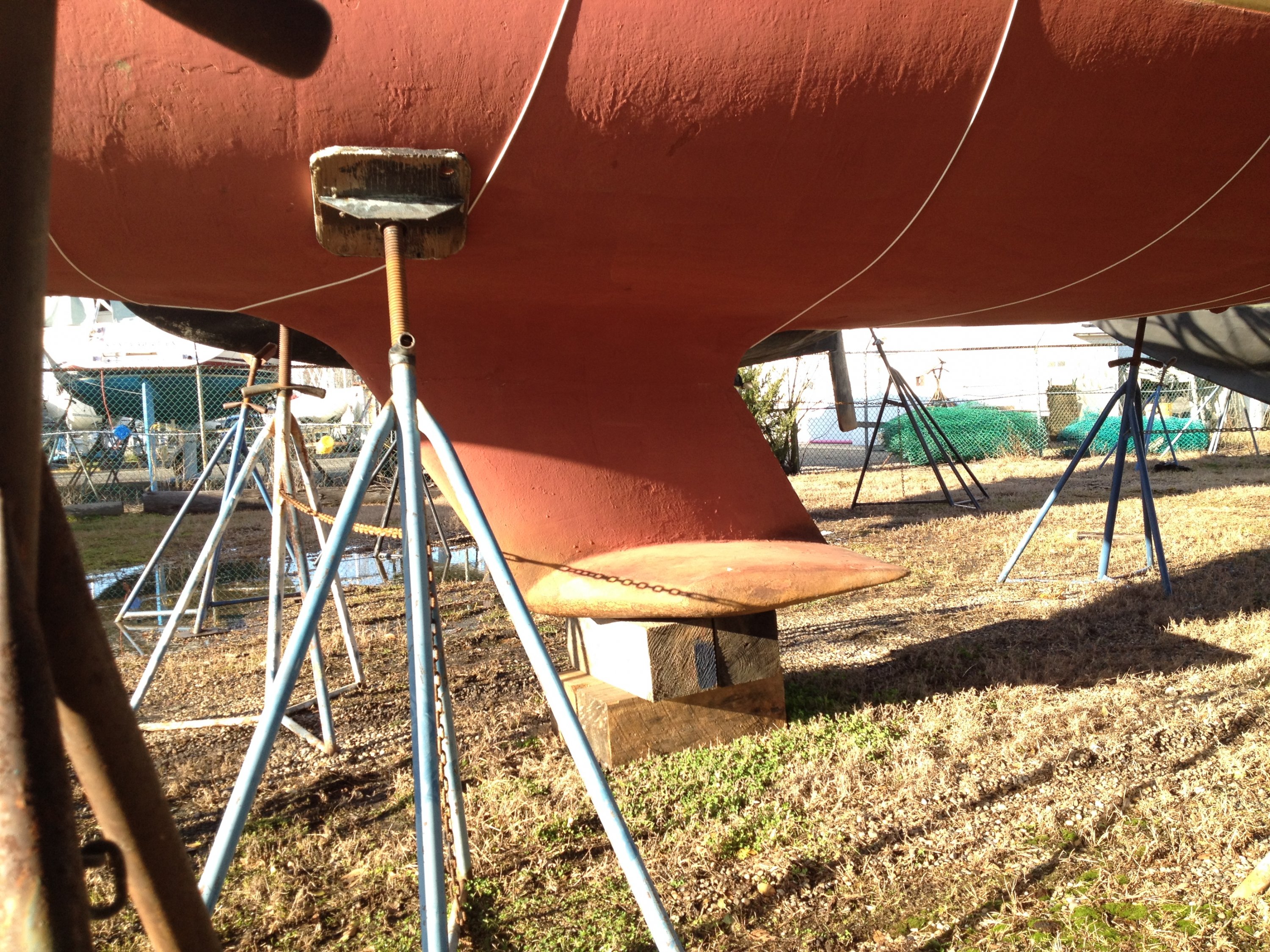

I have been following the keel bolt issue for a number of years now. This June of 2015 I also drilled my keel sump to find out the composition. The composition is all fiberglass. I drilled and analyzed the dust very carefully in stages as it came out. The drill lifted fiberglass dust until 13/16th of an inch, then very briefly caulk, and then lead at 14/16th inch. Therefore my glass sump floor is just shy of 7/8" inch. This gives me a reassuring confidence. I then refilled the small hole with epoxy. I believe all 322 owners should do this.
I have a dripless shaft seal, and so can have a dry bilge for months if I have no heavy rain. That means my keel sump caulk is still in good shape, There is no movement at the seam between the keel and hull.

There is no denying that the very small chord length of the vertical keel and the very substantial keel wings create a higher stress load on the keel/hull joint when heeled, but after my measurements I feel more comfortable about it. As other say, the O'day 322 has cruised New England and the Bahamas for decades. With an eye on the weather, and given a healthy keel joint, I feel comfortable with bay and settled weather coastal cruising. The keel performs remarkably well upwind above about 2 kts for an appendage with such a small square footage. It is competitive with other cruising boats of the day. I routinely pass other similar sized boats, but that is partially detailed attention to sail trim.
