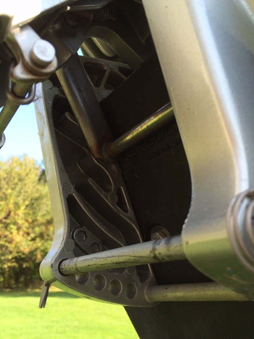

Some Pics
Hi all,
I have an O'Day 22 - late seventies.

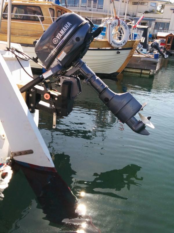

Had an issue with the bracket and replaced it with a 71090 bracket. Had to remake the wedge as the mounting holes on the bracket are positioned a wee bit wider. Here are a few pics.

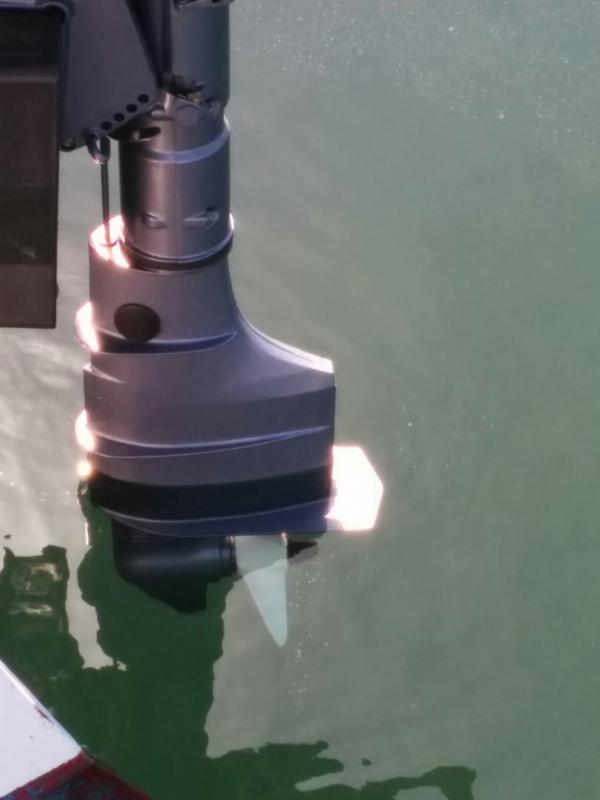

I mounted the wedge at the same default height and centered it over the dimensions of the previous wedge (basically same shaped wedge, just wider). The wedge is also slightly wider than the bracket - about a half inch more on each side. Anyway, I assumed the Garelick had more travel down than my old bracket – but you’ll note from the pictures that at LOWEST position the prop sits with the cavitation plate just an inch+ below the waterline. The instructions (attached here as well) I take it don’t allow for any more travel down - so keep that in mind. If you want the prop a bit further down, lower bracket (wedge) accordingly. It might be preferable to have the option to go a notch lower all things considered.
Note the reach out to the motor is a good one – I am half over the stern to get to it. However, I don’t have to lift or lower the motor at all using the bracket handle. The tilt on the motor is sufficient to lift the prop out of the water. I’m using a long-shaft 2014 Yamaha 6hp outboard.

I have not mounted the bracket yet and by looking at your pictures, I think I need to make it lower. I might try to make the transfer aluminum bracket bolt to the existing bracket but make it longer so it will reach down further. Is that an extra long shaft? It looks it.
thanks for posting the pictures as they will help during the installation.
It appears that when the Garelick 71090 is all the way down, it's just about horizontal. not like the old bracket which reaches down quite a bit.
Yes, it is virtually horizontal and that came as a surprise to me!

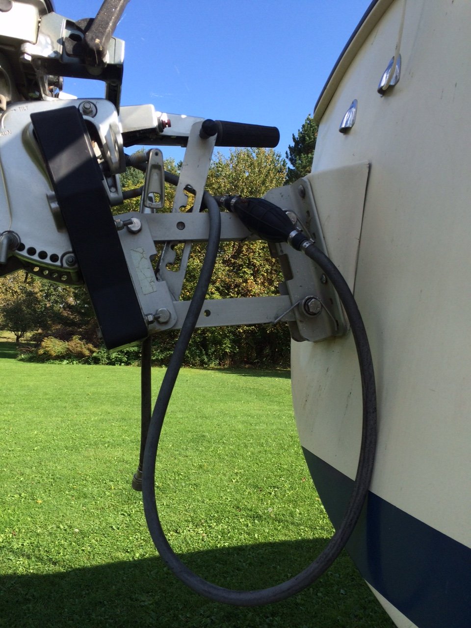

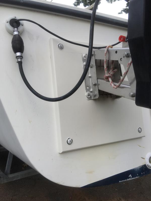

Your first photo is the way my 25 is done. Just a large plate of what looks like starboard screwed tightly to the transom, re enforced with same inside, then bracket through bolted through both plates. No wedge. Bracket and motor tilt adjustment allow motor to be set to vertical. I have seen one other 25 done the same way.
Works well for me.
Works well for me.

Mine was done in 2002 before I got the boat. The OMC bracket is not vertical but the OB has trim adjustment which allows it to be set vertical.

Why couldn't someone use the starboard like yours but install a Garelick and even though when lowering unit it would be angled but you could just tilt your motor according on one of the 3 to 5 tilt positions until straight up or down or whatever angle you want it to be? I posted 3 pics. Heck on my original motor carrier the black base is angled quite a bit. I would think it would be more vertical with the Garelick just mounted onto the transom with Starboard underneath. Then one would still have the two other options to tilt it to the correct vertical position. Am I missing something here? Can it be that easy or am I not looking at these angles correctly for both the transom and the Garelick carrier when up and down?

I think it will be that easy. The only reason I can possibly see for the wedge is if the OB is too close the transom to tilt back while in the the up position. Not the case in my set up.
