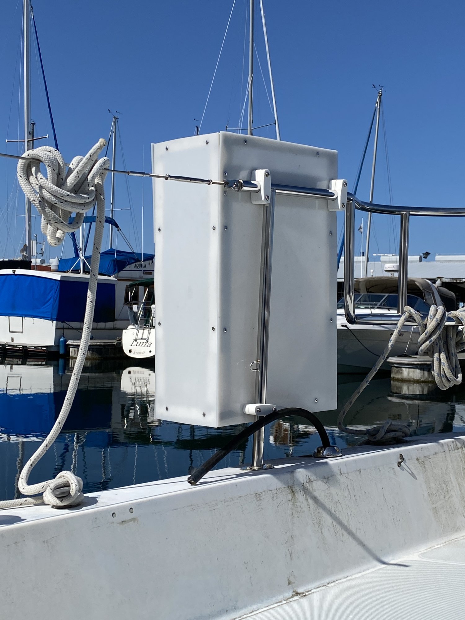

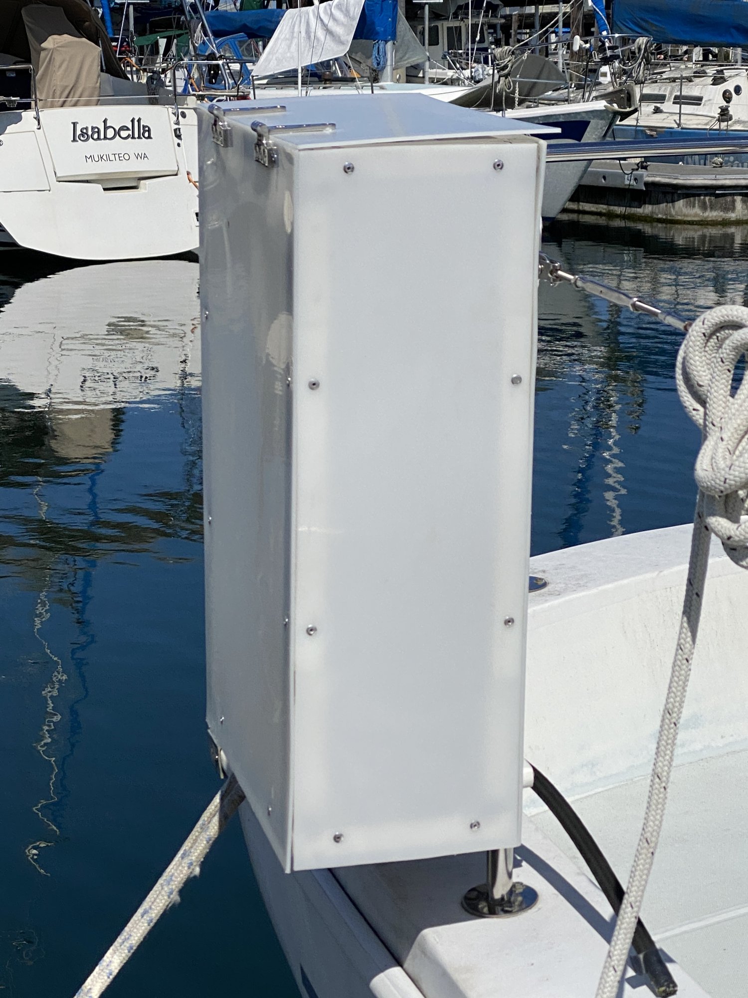

If you don’t have a locker that is suitable for the propane tank (I am really surprised that at Catalina 30 doesn’t have a propane locker…), I would consider an external mounted tank locker. Much easier than building one in the boat. It can be mounted on the stern rail and drain out to the water.
But they are not cheap… this one includes most of the things you need except the hose to run to the appliance.

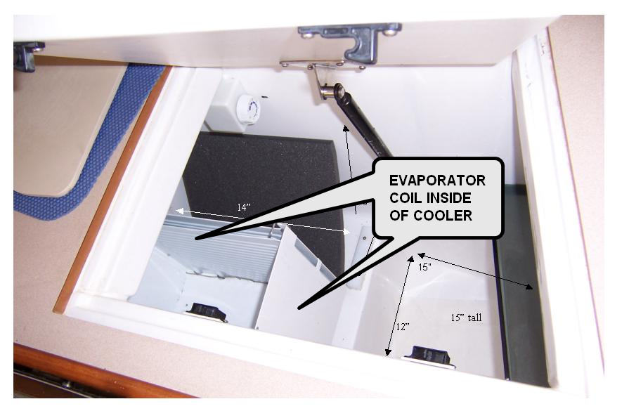

Depends on what your present setup is. Most boats have a completely separate compressor and then a cooler compartment where the compressed refrigerant expands and does its cooling.
Cooler compartment
And as luck would have it, I don't have a pic of my compressor to offer you. The compressor is a black coloured tank with several wires going to it and a fan blowing through something that looks like a car's radiator.
Unfortunately, refrigeration is not something you want to play with unless you've had some experience. There is also the chance that the compressor may just be low on refrigerant and a refrigeration mechanic will be able to fix the problem at a reasonable cost.
Either way, I think a refrigeration mechanic is your best choice.

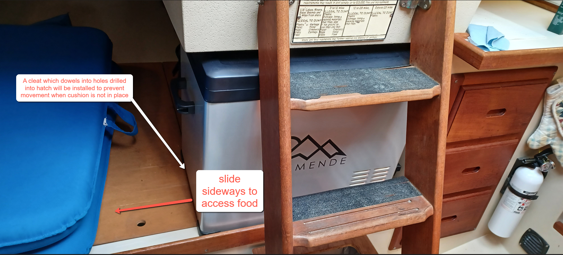

Our boat also had the original cold plate system in the ice box that did not work. I simply pulled it out and replaced it with a kit from Defender. I installed an Isotherm air cooled compressor kit with an L shaped cold plate. Very simple install. Works very well in the ice box which has minimal insulation it doesn't operate as a freezer.
If I needed that I'd buy a cooler type freezer and put it in the qtr berth under the steps like @Hayden Watson did.
