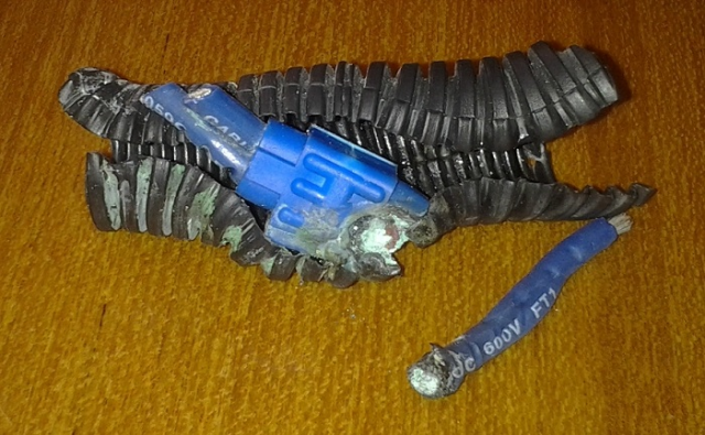

Not an atypical find with this type of splice..
So what, in your view, is the best technique for this sort of splice? A terminal strip seems the most solid, but that also does not seem entirely practical in a many situations. Those three-way connectors with the rivet in the middle? A step-down butt connector? Other?

Was that tinned copper or aluminum wire MS?
Bare copper, not tinned.. These connectors corrode pretty rapidly then fail to make good contact and thus high resistance & heat. They are also notorious for damaging/breaking wire strands when "pinched down".

^^ But no ABYC or other restrictions? I've had only bad experiences.
The high frequency of broken wires has always bothered me.

The trick with crimp connectors and broken wires is always think ahead and put about 6 inches of slack in the end of each wire and be generous with curves when going around corners. Gives you slack to cut off bad ends and re crimp connect and curves generosity keeps from kinking the braided wire inside the insulation. Nice tightly clinched wiring bundles look sporty but strain the material. Just a thought from someone who has been wiring in boats since 1968.
