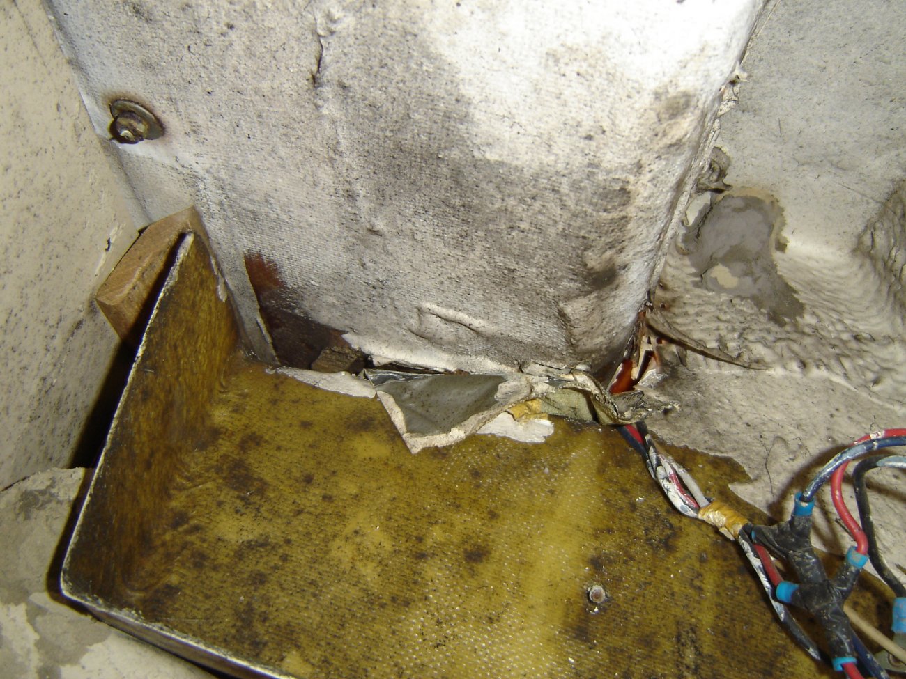

Nope not what catalina ever used in boat, this was a later owner using a auto add on connector. the actual connectors used by catalina looked like this. Actually 3 way crimp connector and still available in supply stores. Clue is rest of wires are glassed in except where the connectors are.

Ward those connectors will be trouble in a year or so. Your much better off with a 3 way crimp or a small terminal block.
Feb 6, 1998
11,672
Catalina apparently did use Scorchlocks for a period of time. We have seen and removed them on a number of Catalina’s. In every case they were a source of high resistance. They really have no place being installed on a boat. I have also seen them come very close to starting a fire...

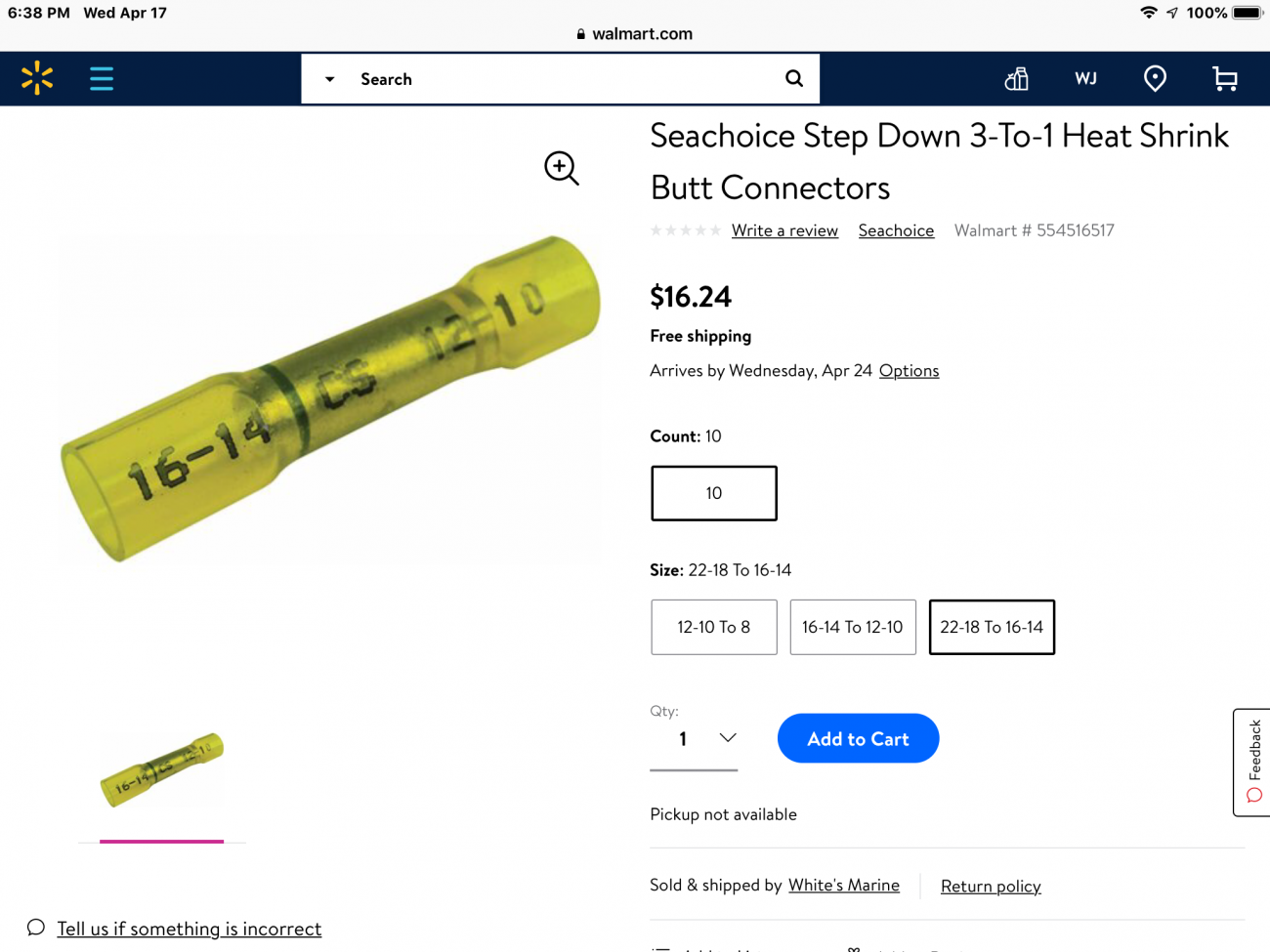

As for any other needed scotch lock, I replaced with step down, heat shrink, butt connectors like these. Much easier to route and seal as a straight reduction. Best of luck @Ward H with the refurb!
