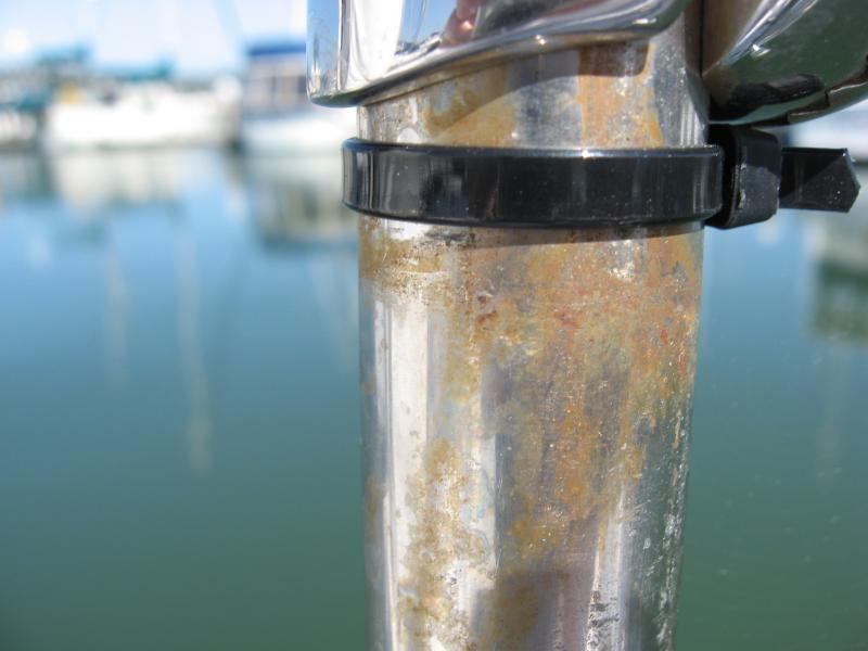

I am looking for recommendations to prevent freshly cut/drilled/grinded 316 stainless steel from future surface rusting/staining.
In this particular case, five years ago I removed my teak hand rails and instead replaced with the stainless steel arrangement in the below picture. Over the years, the hack-saw cut ends of the tubing inside the fittings developed the typical SS surface rust. Also I had to grind the bottoms of the fittings from flat to slightly concave to better conform to the curve of the cabin top surface. This removed the original factory finish so the exposed SS also surface-rusted which bled a bit into the surrounding painted gelcoat.
The rust has only had cosmetic effect ... no deep corrosion at all. But now I know that it does happen, I would like to avoid a repeat in the future. So far, I have applied to the exposed cut/ground surfaces SpotlessStainless citric acid based stainless steel cleaner to remove the rust and passivate. (By the product's description citric acid does passivate and I have had excellent results with it on many exterior stainless steel components.)
I am also thinking to apply a thin coat of West Systems' epoxy to both the cut tube ends and to the ground fitting bottoms before I reinstall.
Aside from sending the pieces to a professional for industrial polishing and passivation, any other DIY suggestions?

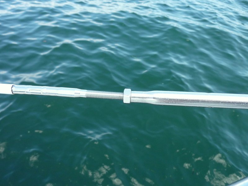

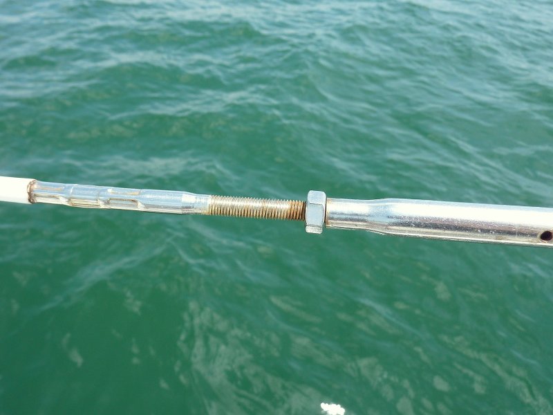

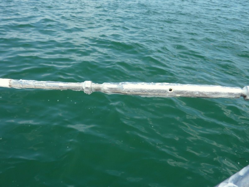

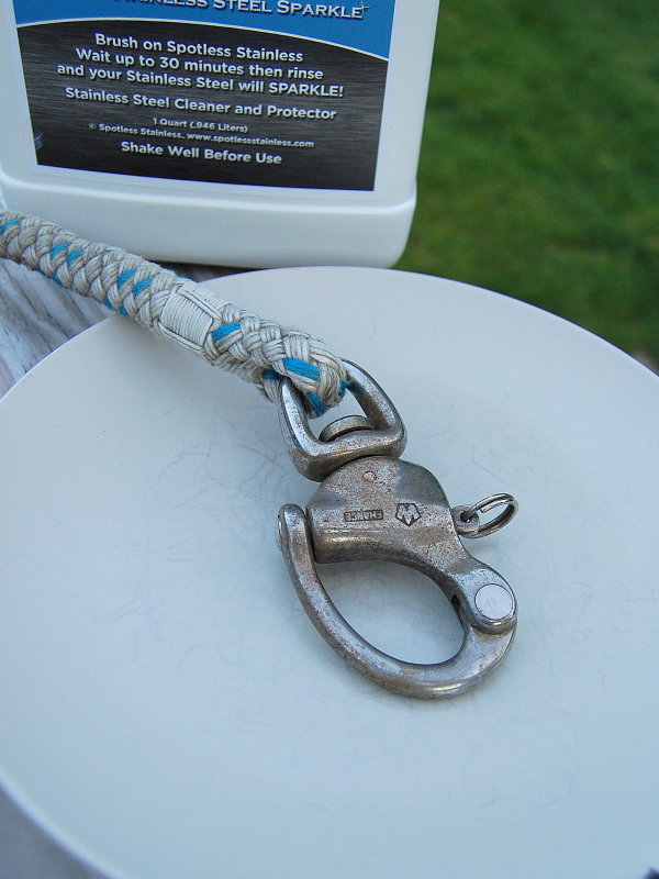

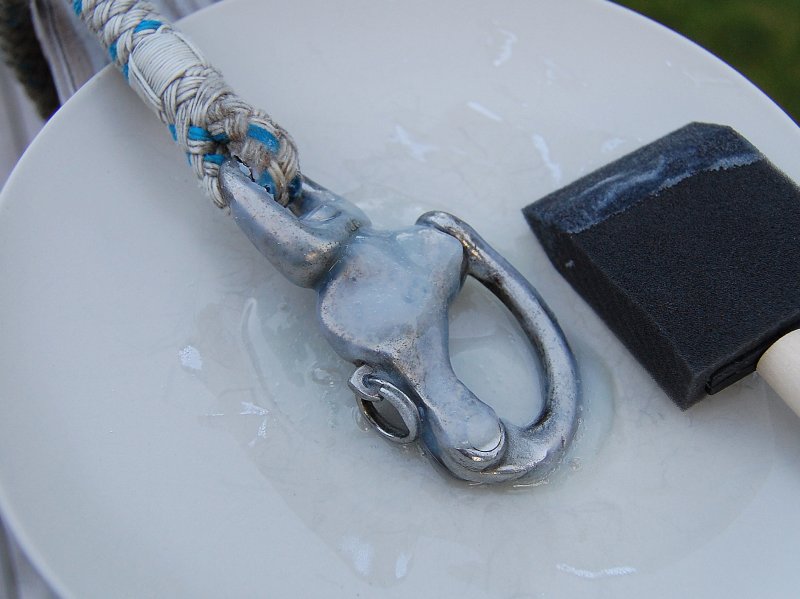

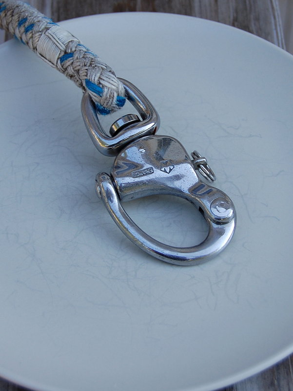

Here are the ACTUAL photos of Spotless Stainless working. Thanks for inducing me into getting around to uploading them..;)
Temp 68F, humidity 63%, set time 1:20 minutes, only because I got side tracked. I can't accurately comment on how long it actually took to get that clean. This was a 25 year old Wichard snap shackle that I have had on a number of halyards. The surface is pitted from time and exposure, and the Spotless Stainless won't fix pitting, but it did and does remove the rust very well even if a little slow. In higher temps and humidity it does seem to work faster. Below 70 degrees it seems to begin to slow down.
It is what it is:
Before:
During:
After Rinsing:
Not bad for doing nothing but brushing it on, letting it sit and rinsing it.
Oh and YES I do find it a tad expensive but don't doubt the price will come down when volume eventually goes up.
Yesterday the boat was on the mooring and after a sail I busted out the SS and a chip brush. Worked up near the bow. While waiting I got some paperwork done then went back and rinsed it off. Overall really, really easy. The ability to clean stainless while I am doing work for my "real job" is really quite nice..
For rinsing it I used a bucket of water and a wet microfiber rag. I did not feel like going into the dock to rinse down or to get out out my on-board hose. Rinsed off fine..
I also tested a spot where I waxed over some rust purposely. It does not work very well unless the stainless is unprotected and may take considerably more time or perhaps not work at all depending upon how thick the wax coating is.
These pics were all taken yesterday 6/23/10..
Before:
During:
After:
Temps were 78F with about 84% RH and it worked in about 30 minutes today. It was however direct sun so I had to keep it wet. I discovered that you can cover it with a dampened and wrung out microfiber rag and it keeps it wet longer.
Keep it wet and use in warm temps and the stuff really works and leaves a very nice shiny surface.

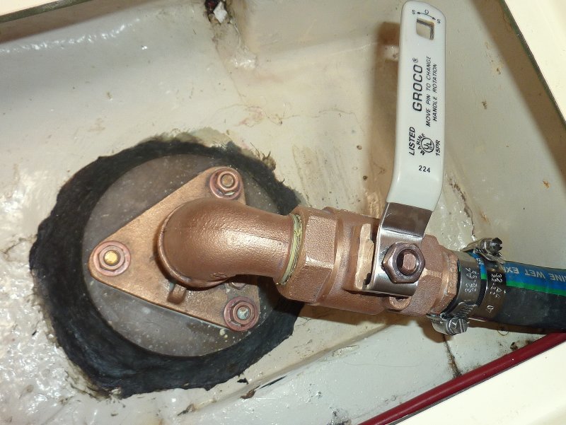

For experimentation's sake I tried it on a seacock. I also used a Mr. Clean Magic Eraser with the Spotless Stainless. This took a long time, a lot longer then the stainless, but the results were great when it finally had enough time to do its work. Getting through the verdigris took a while but this is right next to my nav station where I was working so it was easy to keep an eye on the progress..
I don't advise using the product in this manner, not its intended use, but I did do it.
