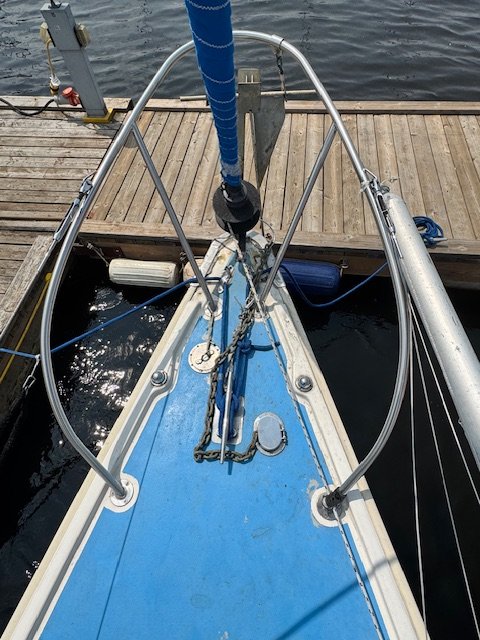

Hello all

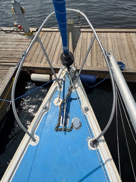

Still trying to get my boat to a comfortable place to use.
My question is what hardware do you all use to secure the furling line at the cockpit?
I am also wondering if port or starboard makes a big difference in using it? ( probably not)
I am trying to better the exit angle from
The drum as the line is in the way of the anchor chain and rode.
I will take pictures next time at the boat, the pictures I have are before the add of of the anchor roller

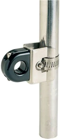

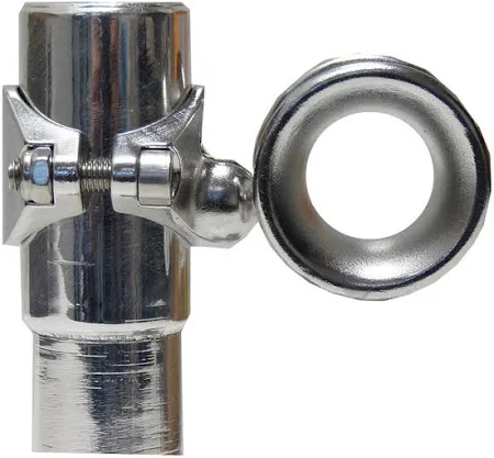

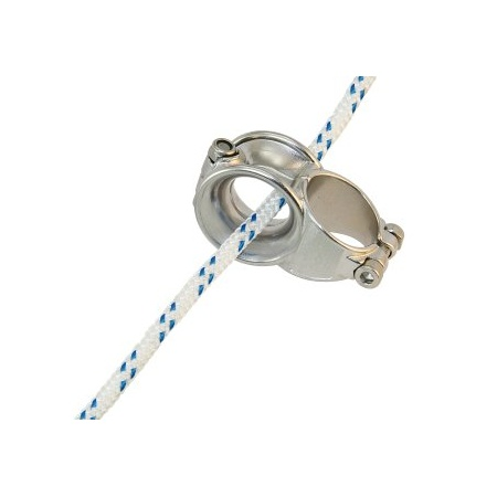

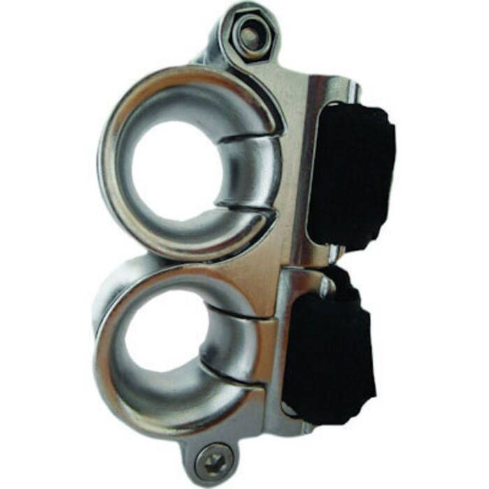

You mentioned that the line is in the way of the chain and rode.

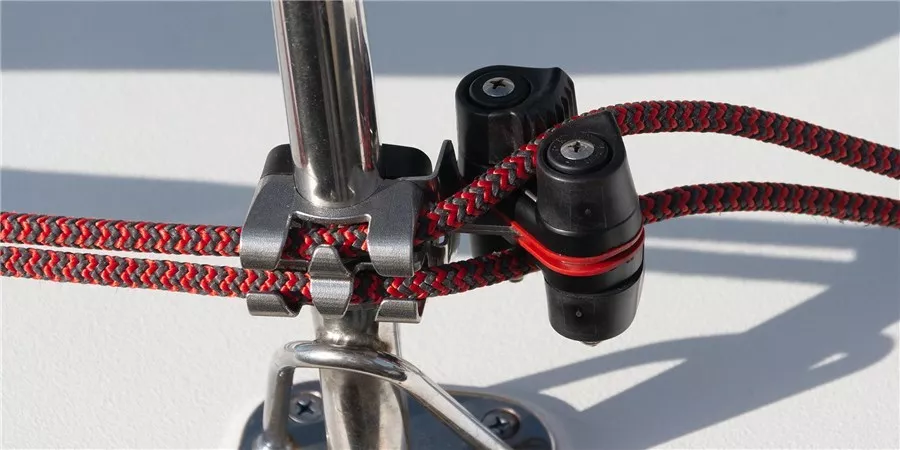

This is what I used on my H26 to control the line.
They allow the line to live "outboard" of the deck and cockpit. They come in many styles...
You should be able to exit the drum and take the line perpendicular to the gunnal and to a turning block and then through fairleads to the cockpit and put a cam cleat on the last stanchion.
--------Bow Pulpit ----------------------- Aft-Stanchion
13,088
Do a search for "Stanchion Mounted Fairleads" and you will get many choices.

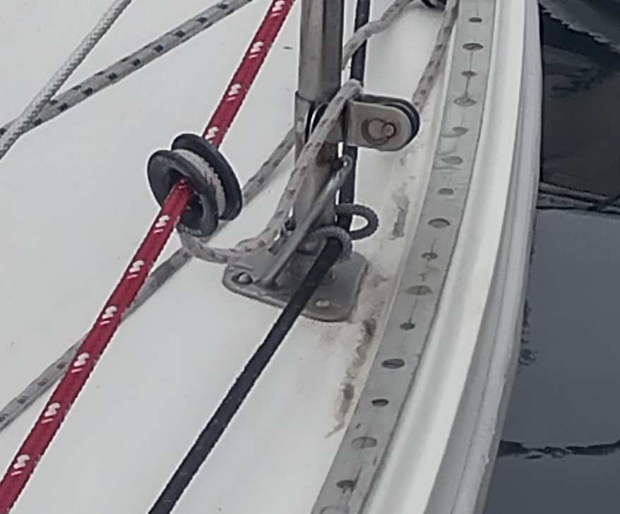

I orginally had fairlead blocks. When the rollers wore out, I replaced them. But the lines occasionally got in the way as they were threaded on the inside. A few years ago I replaced them with dyneema loops. I wrapped the loops around a stanchion forming two ears through which I threaded the furling line. Works perfectly. The lines are out of my way being threaded on the outside. Bonus: much less expensive. Simple to construct.
Likes: AaronD
Aug 17, 2013
1,343
Pearson P30 202 Ottawa
Do you have a picture by any chance?
Feb 22, 2015
16
Catalina 30 Redondo Beach
About same, maybe a bit better. No complaints from crew. The black line is weathered braided dacron, compareably rough. Dyneema slick enough as there are no sharp turns. I did use a block off the drum to keep line from crossing the anchor hatch.
The loops are out of 1/4" dyneema for no other reason than I had that on board and find smaller stuff a pain to splice. Don't remember loop size, but not critical.
No noticeable chafe nor wear in 10 years. Unsurpising as very little stress on the loops.
While the old hardware occasionally reached out to scratch me the loops are better behaved. Wish my cat was as considerate.

Thank you all, I added a spin lock stanchion roller, still need to do final adjustments.
