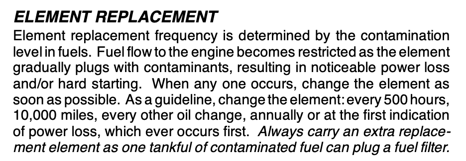

24,695
You post a good question. I have always used the vaccum guage as a guide to contamination. If you have a good source of clean fuel and your tank remains clean, then what is a person to do year after year. Surely the constant movement through the filter membrane must break it down...
Consulting the manufacture may yield a clue.
There you have it. 500 hours.
This was in the instructions for the 120R Racor filter. I suspect it would be applicable for other Racor filters.

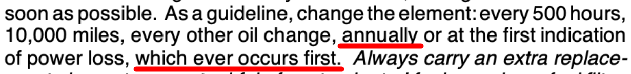

Not quite. These clowns are actually looking for :
If these guys had their way, you'd change the filter every time before you start the engine. I trust the research people who designed these filters but once it gets into the marketing people's hands, all bets are off.
And how about your automotive fuel filter ? Good for the life of the car unless it becomes dirty. Had numerous cars over the years and NEVER changed the fuel filter in one of them.
