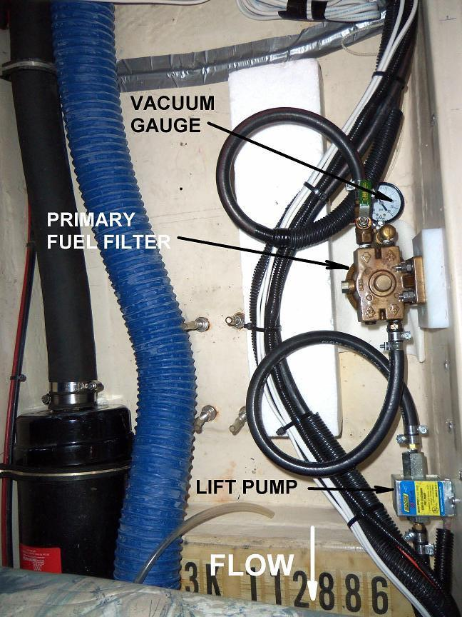

Here's the situation. A vacuum gauge is installed in the fuel output hose immediately after the primary fuel filter. It is located between the primary fuel filter and the secondary filter. Can this vacuum gauge determine if in addition to the primary fuel filter, the secondary fuel filter or if both are nearly clogged?
May 17, 2004
6,196
Concur with James that the answer is no. To explain it differently - Any restriction in the secondary filter reduces the flow through that filter. That wouldn’t cause any extra suction in the line between the filters. The only vacuum between the filters would be attributed to restriction in the primary filter.
That is a indicator of "clogging" only if you read it at approximately the same engine conditions such as...
1) RPM
2) Engine Temperature
3) Fuel tank level
4) Fuel pump health
However you can use a vacuum gauge to monitor the slow clogging of a fuel filter, over a long time.
If your gauge changes fast, you have a serious problem.

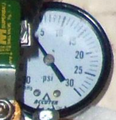

WOW ! You guys operate at a much higher level than my pay scale.
I find the fuel flow rate is so low on a Yanmar 2GM20F, I forget all of the viscosity, engine loading, and lift pump details and see that when the engine is running, the vacuum is always a big goose egg (as far as the gauge will show).
The filter inlet isolation valve must be throttled in quite a bit before a vacuum starts to form.
And as everyone else says, the condition of the secondary filter does not affect the reading on the the vacuum gauge. To determine the condition of the filter you are concerned with, a vacuum gauge must be installed "downstream" of that particular gauge.

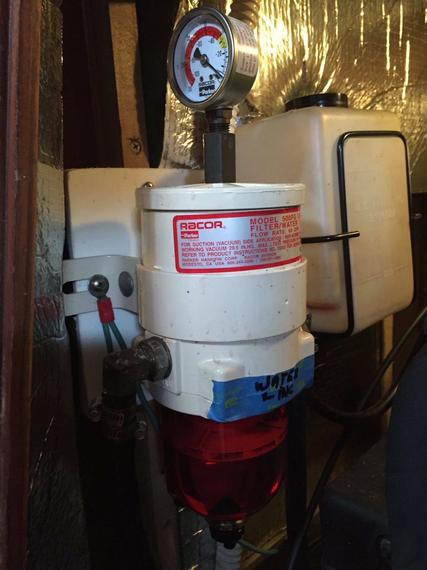

Not really, but I do like my Racor Vacuum gauge[ pict above] that has a marker or set point to see changes.
mine.
Jim...

Well, obviously we travel in different financial circles.
All I could afford was this cheap gauge without the marker.
However, it IS a compound gauge. Unfortunately, not many people are impressed with that fact :wahwah:.

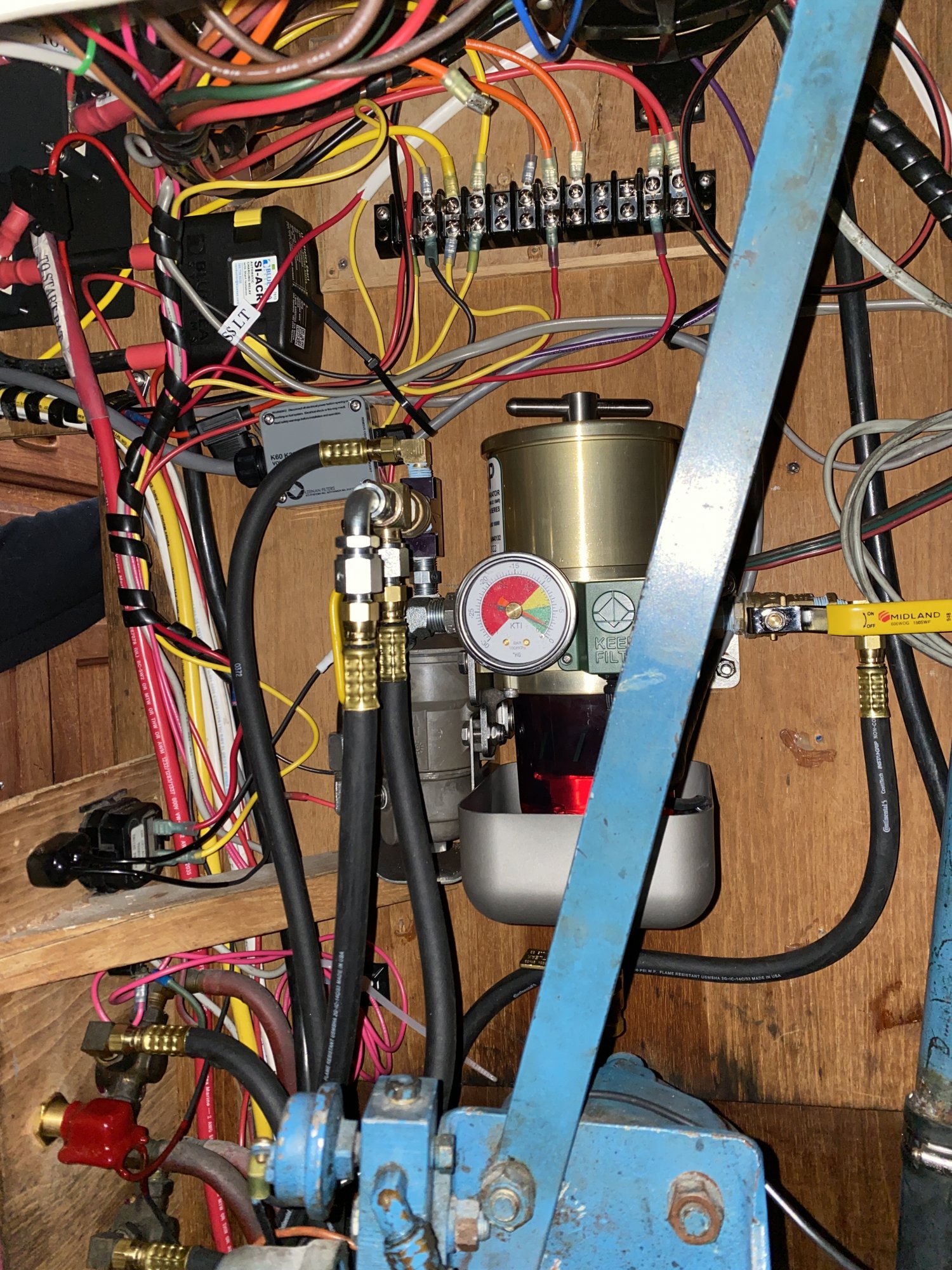

24,695
I like the new gauge I installed on my new filter and pump fuel polishing equipment.
Likes: kloudie1
Jan 4, 2006
7,757
Yeah, yeah. Very pretty :clap: !
But of far greater interest, what is the blue device with the long piece of flat bar attached to it ? Looks interesting.

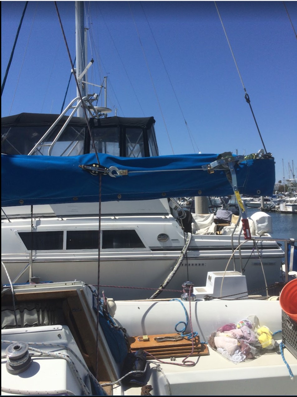

I said the same to him about using his Boom to make that lift.
I saw a youtube on fixing his Perkins Marine Diesel 4107 that the transmission weighs ≈100 lbs
John said his weighs ≈220 lbs.
I said good idea with Boom Lift, but not so good where all that weight pushes on his mast.
His smiles for success without loosing more of his hair.:facepalm:
Jim...
PS: I am Sure John will post more on his dilemma.
PSS: My engine has not been turned over now for 1.5 hrs so hopefully I will bump start it next week to make sure oil is pumping.
I prefer this setup for lifting out my engine.
