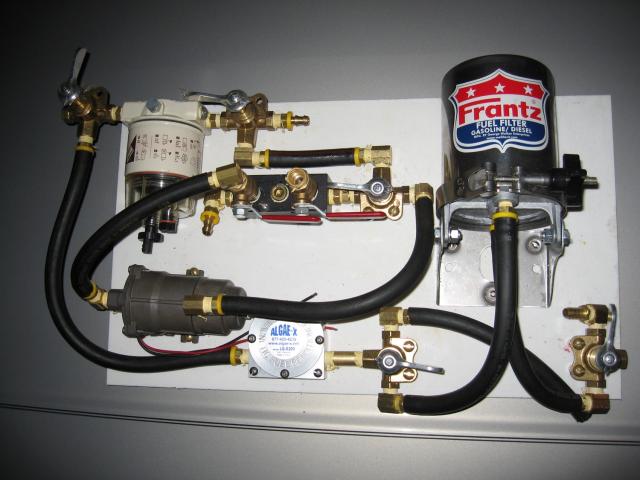

I've uploaded a picture of a fuel polisher project I started last winter. Some of it is still an abomination but although you can't notice, there are a couple of marine grade fuel lines on there ( the rest are just standard automotive lines I used for postioning the components). Question I have is does anyone know of a good marine grade fuel line clamp that will work on 3/8" marine grade fuel line? I'm not too keen on using the standard plumbing type hose clamp.

That looks like a good system you have there. I have seen alot of posts on here about people getting in rough weather and their engines stall out. The general consensus is from the gunk in the tank that forms getting knocked loose and sucked up the dip tube.

That looks like a good system, a little simpler than mine. I believe the Frantz filter will work similarly to the Shelco filter but after seeing your setup I wish I had known about the Shelco. The Frantz uses toilet paper as the filter medium. The article I referenced used a Gulf Coast filter which has been discontinued but also used toilet paper as the filter. A Gulf Coast representative recommended the Frantz filter. It could be a bear to change out the Frantz filter, something I'm concerned about.

... A Gulf Coast representative recommended the Frantz filter. It could be a bear to change out the Frantz filter, something I'm concerned about.
From what I see here Ken, it looks like you have just laid out the system for pictorial purposes.
Perhaps, you may be able to mount the Frantz (if you don't take it back for a refund and go with the Shell) orientated 180 degrees, from the way it is in the picture, so that the filter canister and element are in a downward position. Then, you should be able to put a container like a cutout empty gallon milk bottle under it, break it loose and pull it and the used toilet paper aside to change out with little mess and clean up.
Just an observation from a different set of eye balls :)

My engine is diesel. Look at my myspace link, you can see the tank. The tank mounts behind the companion way ladder. It has to slide forward under a fiberglass part. I won't be able to take the access port off with out unbolting the tank and sliding it back a foot or so.
Ken, can you drain your tank from the lowest point, or is the 'drain' you are using for the fuel polishing system coming from the dip tube? You could make it so much more effective if you could pull the fuel from the lowest point in the tank. That way you will get any water and maybe critters living in the water. Also in newer, better water heaters the inlet for cold water makes a jet of water circulate around the bottom to not allow any sediment build up. If you could make the inlet back into the tank at the bottom so it would circulate the fuel around down there to make sure nothing is making a home in there. The inlet(fuel return) can be another dip tube that extends from the top with a 90 degree bend in it to cause circulation along the bottom.
If you pull fuel from the dip tube(the one that goes to the engine) and just drop it back in at the top, you could leave the bottom of the tank relatively undisturbed.
However you still want your dip tube(for the engine) drawing from a higher point from the bottom like it was designed.
I'm not a sailing expert at all. But I am kind of a motor head and an engineer. The engines are about the only thing I feel comfortable working on on my boat really. But these guys have a brazillion more times experience with these engines. I'm sure what I am saying has already been doen by a few of the guys on here if it's a good idea.

ITmaster - good idea - I'll take a look at it - thanks!
Hermit - good points - the way the system is now, the fuel returns via a fuel return line from the engine. I'm not sure where the entry point is on the tank (never looked). When the system is in polishing mode there should be a pretty good stream that would keep the bottom stirred up depending on where the return line is positioned..at the bottom of the tank would be ideal.
