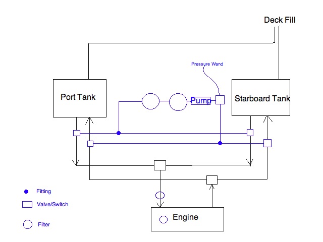

I've been designing a system for my boat for about a year now... We have 2 tanks totaling 55 gallons; so it'd be pricy to toss all the fuel.
I Don't understand the specifics though... If my Racor is a 2um then for polishing I want 10-20um correct? I want a higher flow rate because I'd like to build in a pressure wand I can insert through the sending unit (no access panel) to help get the crud off.
How do I know what filters are compatible with which cartridges?
Are filters interchangeable? back-washable?
Is there a difference between filter and water separator?
What is a good source for supplies?
What do I need to look for in a pump? I was going to hit up used auto yards, but I'm not sure that will work anymore.
Thanks for your advise!

A lot of your questions are answered back up in the thread. Filters are not back washable.
Don't use Racors for polishing, elements are too expensive and you want depth; not surface filtering.
Review the thread and look over my system (link above in the thread). Come back with remaining questions.

ok, I've re-read a little closer, there is about 3 different subjects here. I'll pose my question this way and ya'll can tell me if I'm right.
1) I need 10-20 micron filters at 1-3 gpm to clean the fuel for my 2 micron target
2) Shelco filters have the benefit over Racor because they use standard size cartridges - 2.5" by 10" (or 20, 30, ext) or 2.75" by 9.75" (or 19.5", 29.25", ext)
3) Depth filtering uses wound filters that are thicker and hold more crud where surface filters are pleated and clog quicker
When looking for a wound filter, does it need to be rated for fuel? What materials are no-good? I'm not sure I can justify buying 60 filters to the admiral.
When matching a pump to the system, a 10" filter is rated at 10 gpm; so do I need to keep the capacity of the pump below or above that? Is that WAY too much?
Will a depth filter remove water?

You got it mostly right. Everything I know about filters I learned from Rich H here who is a real expert, the kind who advises other filter experts. Do a forum search for "fuel polishing" "filters" etc. and you'll get an education.
You can buy blown melt polypropylene filters that have more capacity than the wound string filters. Shelco will only sell them in large lots but you can get them in smaller quantities here:
http://www.freshwatersystems.com/p-3692-hytrex-9-78-filter-10-mic-gx10-9-78.aspx
One filter lasted a whole season for me last year, nearly 2000 miles, about 60% under power.
You should put in the 10" standard length housing. I only went with the half length because of space restrictions and getting the half length filters is a pain. Size matters. Longer is better.
Filters are not like screens. A 2 mu filter will let much larger particles through. Rich describes it as like trying to catch golf balls with a pile of golf clubs. Even some baseballs will get through. That's why systems that run the fuel around and around are so much better than ones that just filter it once before it goes into your engine. Many passes of a 10 mu filter will clean smaller than a single pass of a 2 mu filter that is straining your fuel pump.
I've forgotten how effective the Shelco set up is at removing water. The Racor will do that in any event. I've never seen any in my fuel.
Those blown filters are used for filtering drinking water and come in sealed sanitary paper packages. They have nothing in them that can leech into your fuel. I think Rich said the string wound filters are slightly better at removing water but not by a significant amount.
I have two seasons and a lot of motoring (I basically operate like a motor sailer) with the system now and it's amazing how clean the tanks and system are.
You should still change your Racor and engine mounted filters every season because the elements degrade even if they are not being challenged by particles of crud.
