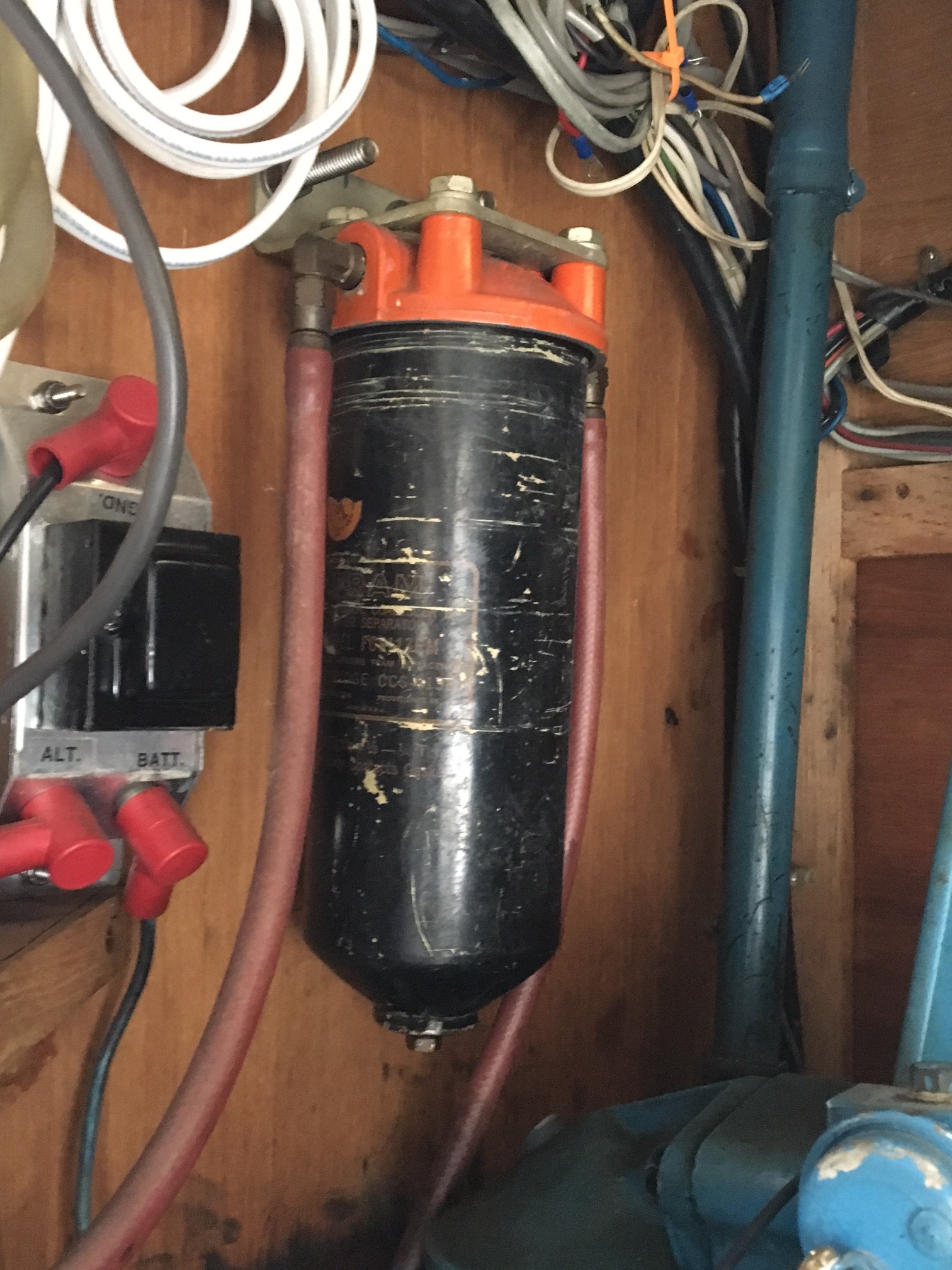

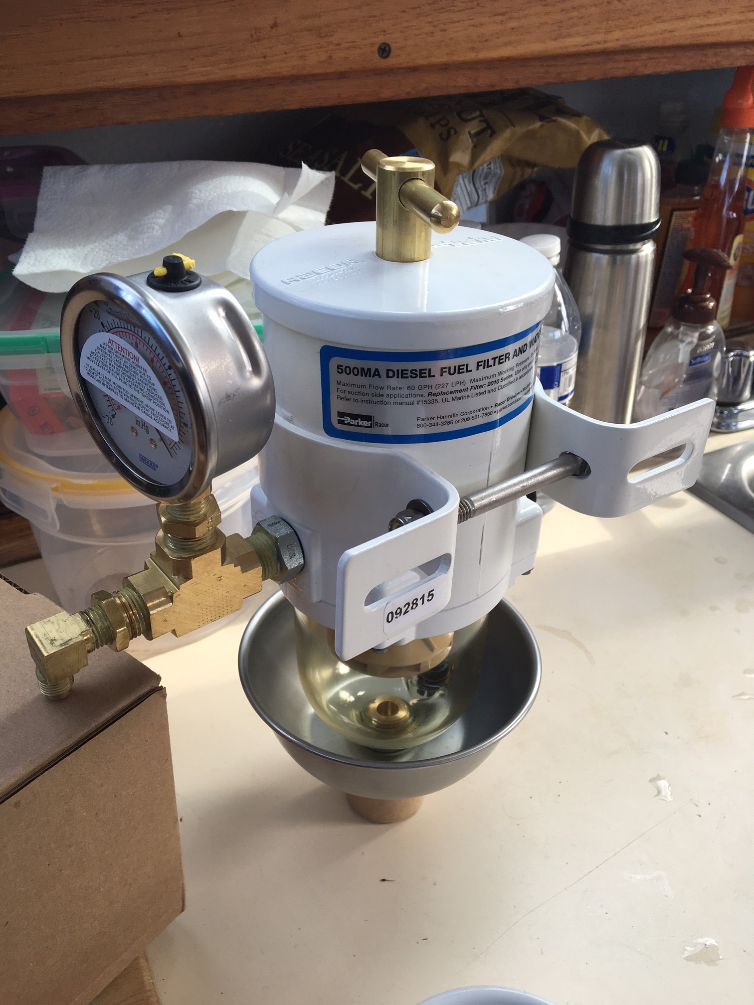

Install a Vacuum gauge on your Fuel Filter.
I had this filter.
And replaced it with this.

So I bought and installed a vacuum gauge.
Reads completely good with no restrictions. I assume the gauge will pick up any restrictions on pickup in tank as well..... Only describes filter condition in specs of product.
21,076
NYSail
Vacuum gauge reads suck power. So starting at the pump to the gauge if you plug the line beyond the gauge the pump will suck a vacuum and the gauge will respond with a HIGH vacuum reading. The blockage will be some place between the gauge and your source of liquid.
That's why we stick the gauge on the engine side of the filter. The filter being a likely spot for the crap to plug. Looking at the filter and it's clean you need to work your way back towards the tank. The pickup tube may be plugged but so may one of your fuel lines.
If the pump is on and there is no reading on the gauge then you have an air leak. Note if your pump is sucking fuel the gauge will read something. Then you get to search for hissing sound or air bubbles in the fuel system.
Great!:thumbup:
Now here is how can tell restriction changes from the tank side of the NEW filter cartridge...
1) Run you engine under normal load ( mine is 1800-2000 rpm) ( no electric fuel pump)
2) Record the precise pressure on the gauge (base line)
3) Check for reduction in pressure (higher vacuum) (you will see zero when engine down) per Jssailem.
My Gauge in post pict #6 show the inside scale of 0 to -30 (inches Hg vacuum) so the pointer moves counter clockwise toward the red (or fouled area) The higher the vacuum the slower the fuel flow from tank side.
In a 30-40 engine hours, check your gauge at conditions in step 1). Record again.
Unless your tank is really crappy, I suspect no change.;) Rinse and repeat over longer engine times.
Tip: A slow very gradual change, it is the cartridge doing its job. Major sudden increase in Vacuum reading, Fuel line problem. Engine sputtering at near zero pressure, as per Jssailem, air leak.
