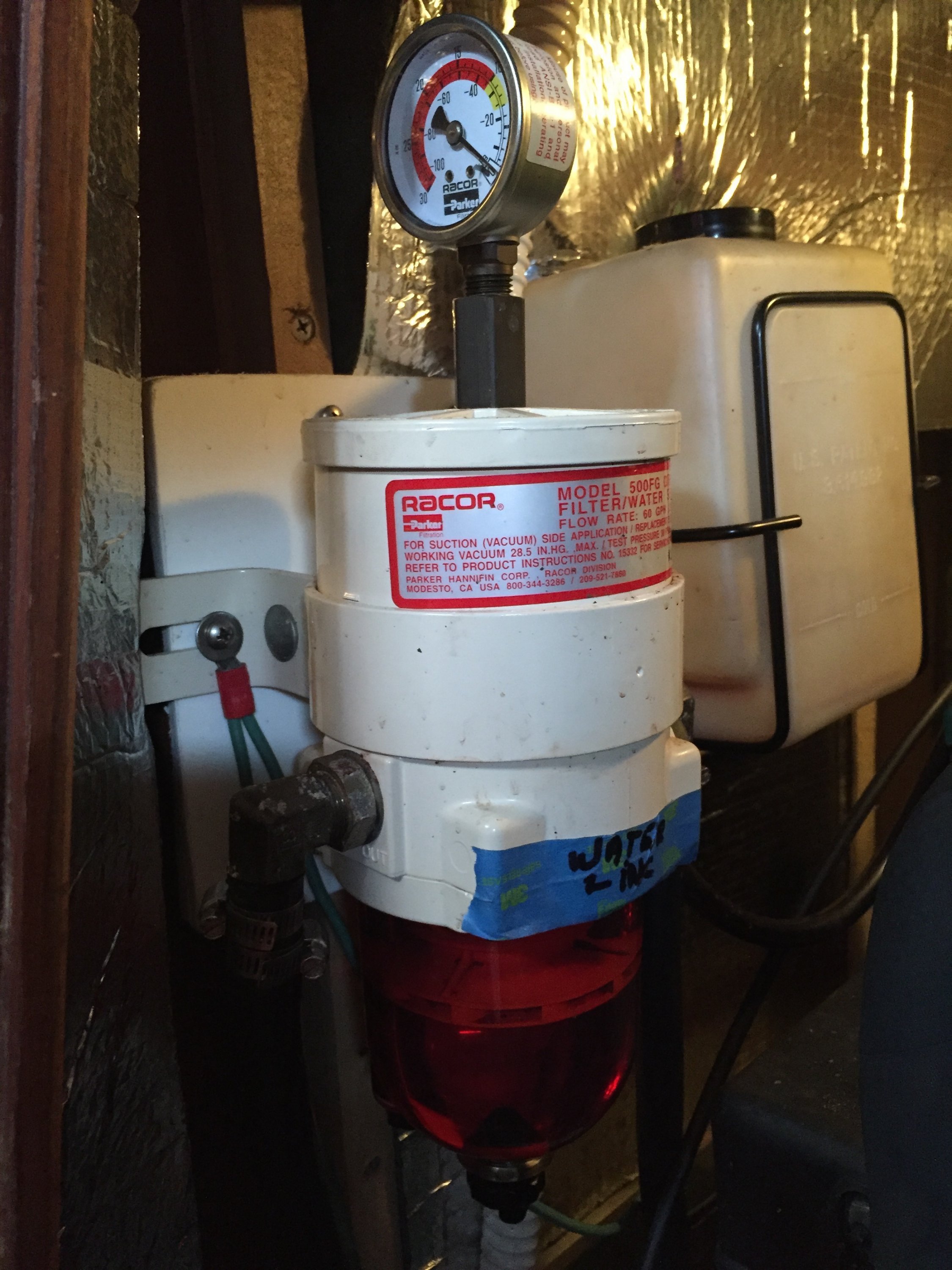

Install a Vacuum gauge on your Fuel Filter.
Here is what I have.
Green vacuum reading ok, Yellow is needing change. Red is plugged.
FWIW I have never seen a drop of water or change in vacuum and on same cartridge now for 2 years. Cartridge rated at 60 gallons/hour versus my engine ≈0.75 gph at 2000 rpm.
Jim...
PS: The blue masking tape haw nothing to do with the filter. Top of blue tape is my normal static boat water line as a convenient spot to reference inside my boat.
