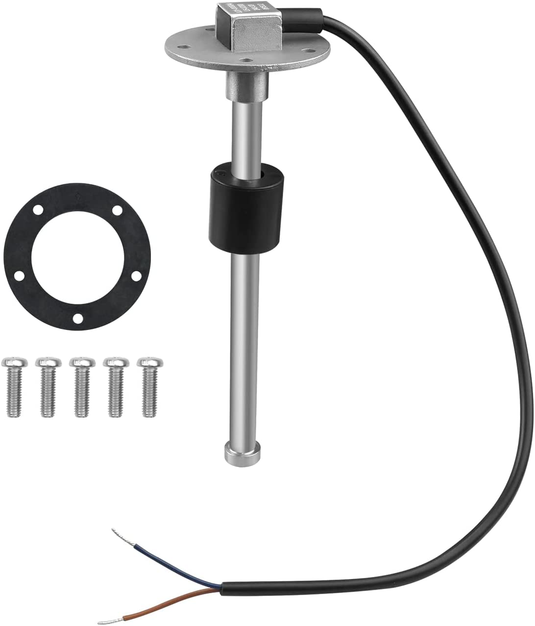

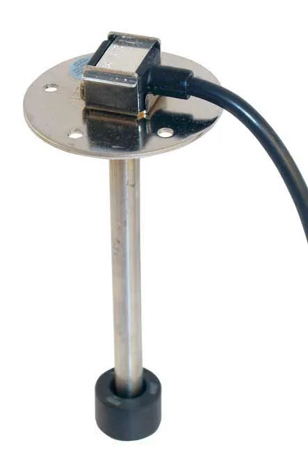

This is one of the Moeller senders. (ELECTRIC SENDING UNIT W/REED SWITCH) I am using it on my boat. It has worked smoothly and with accuracy for about $90. Comes in different lengths too accommodate your tank.

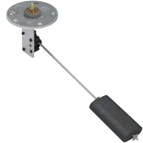

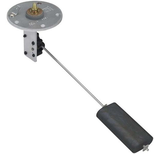

There are different sender unit designs. I like the ones that are flexible as there is often little room above the tank for the installation. You have to get one that has the proper depth to match your tank depth. Virtually all the sender mounting ports are the same universal design. Be careful with the orientation of the sender in the mounting port. It will only attach in one direction as the screw holes are not equally spaced.

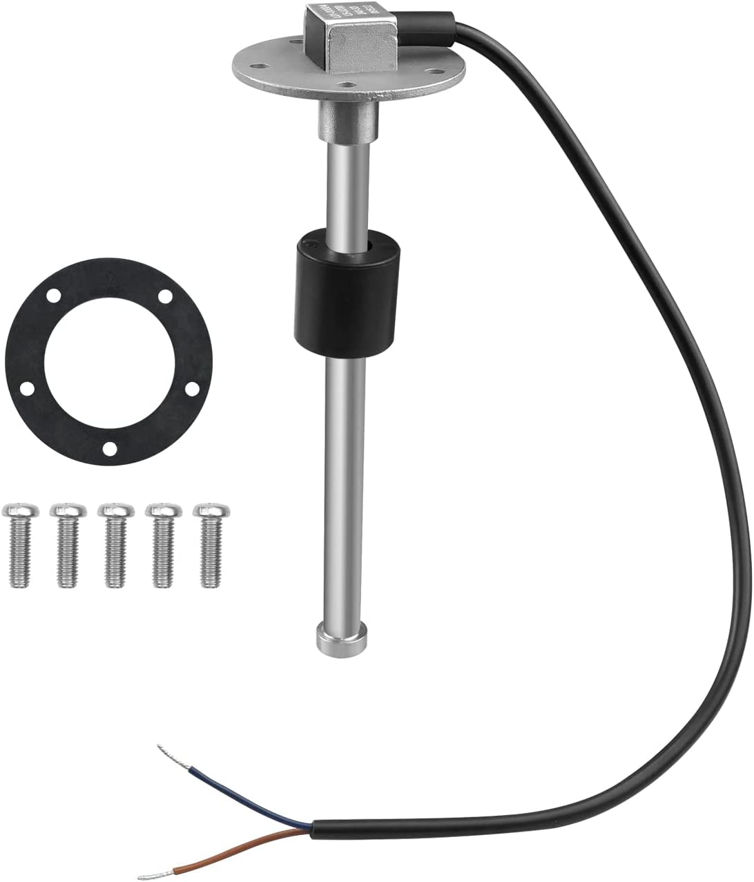

I have had repeated failures with the type of sender that uses an arm with a float. I have now switched to the vertical tube with internal read switches and after two years have had no problems.

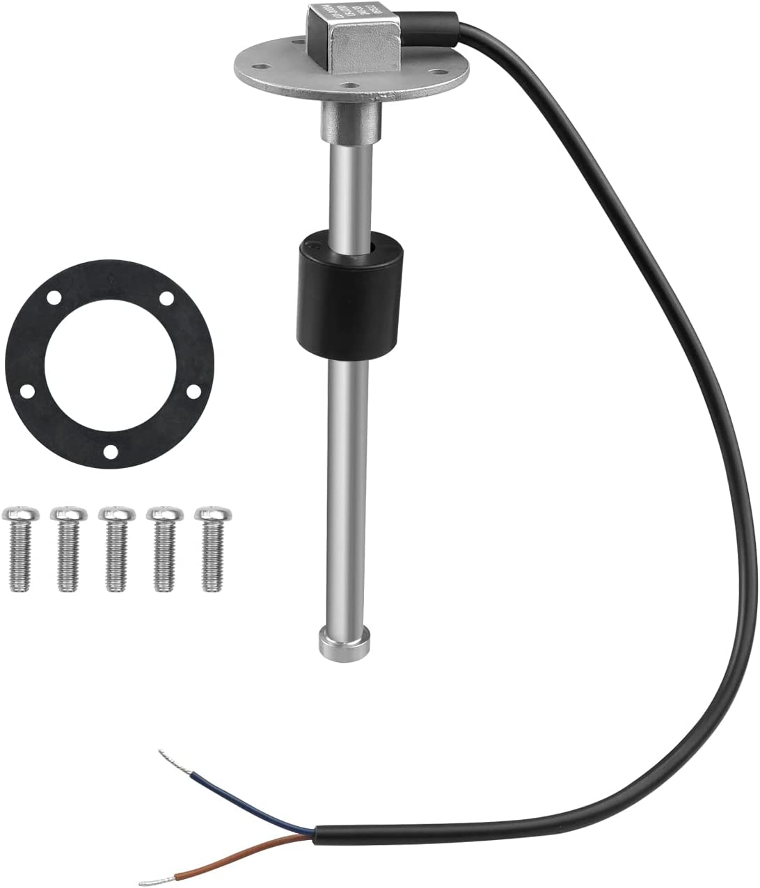

Call WEMA. I replaced my sendinig units 11 years ago and all are still working fine. Waste can get stuck but after cleaning works fine.

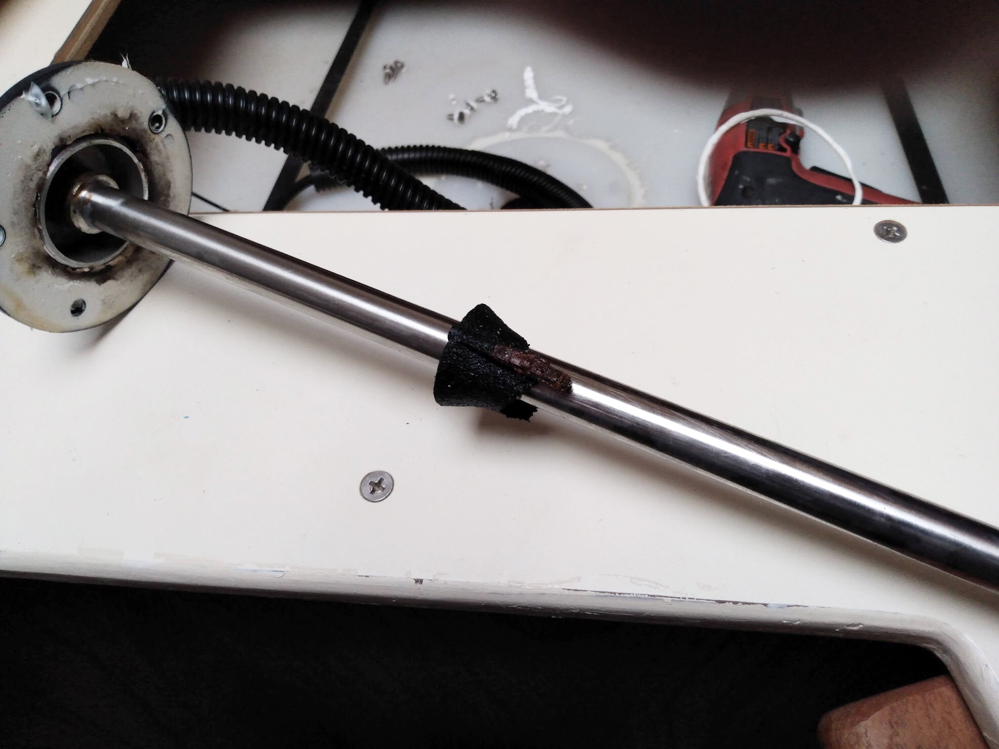

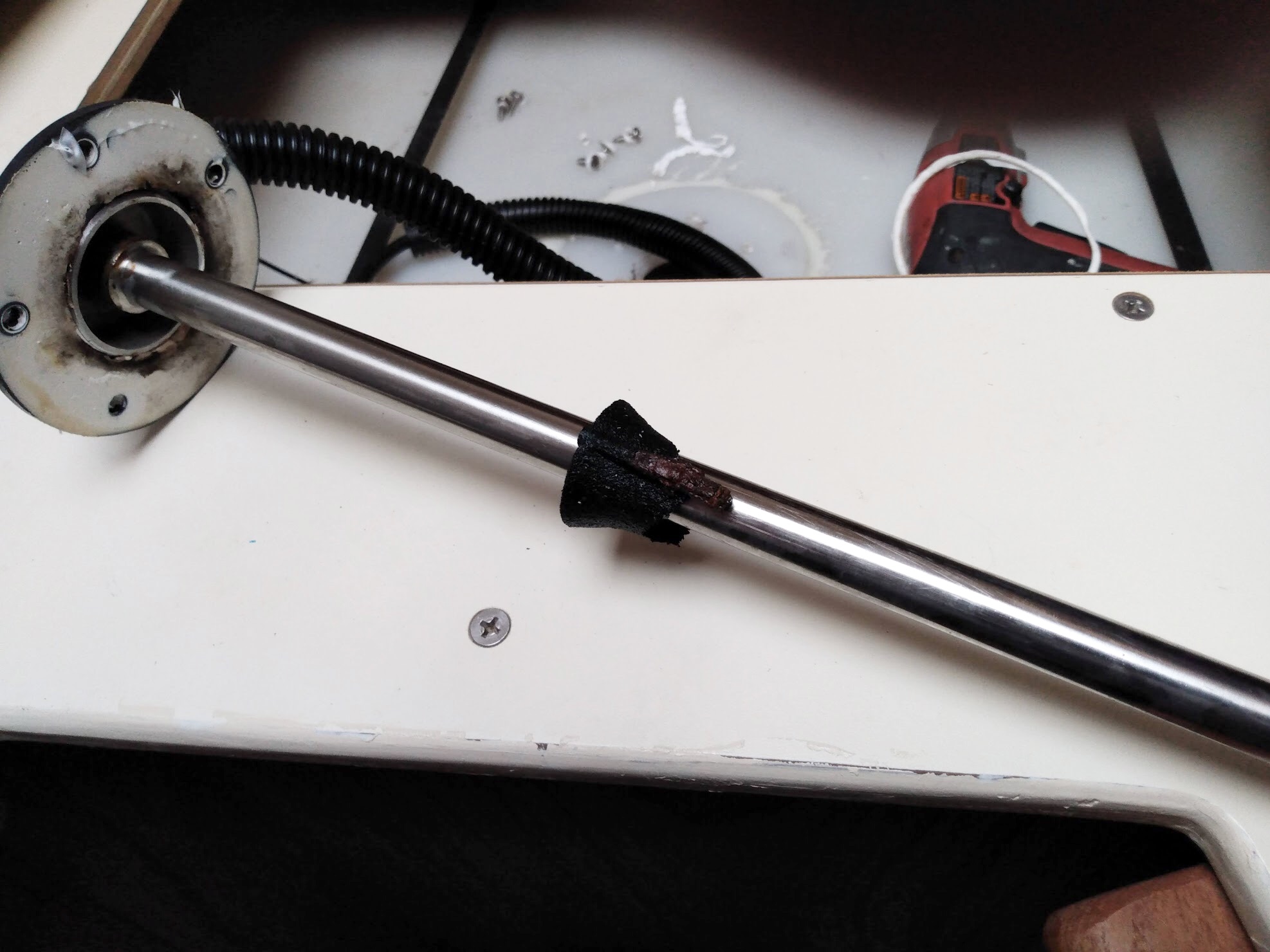

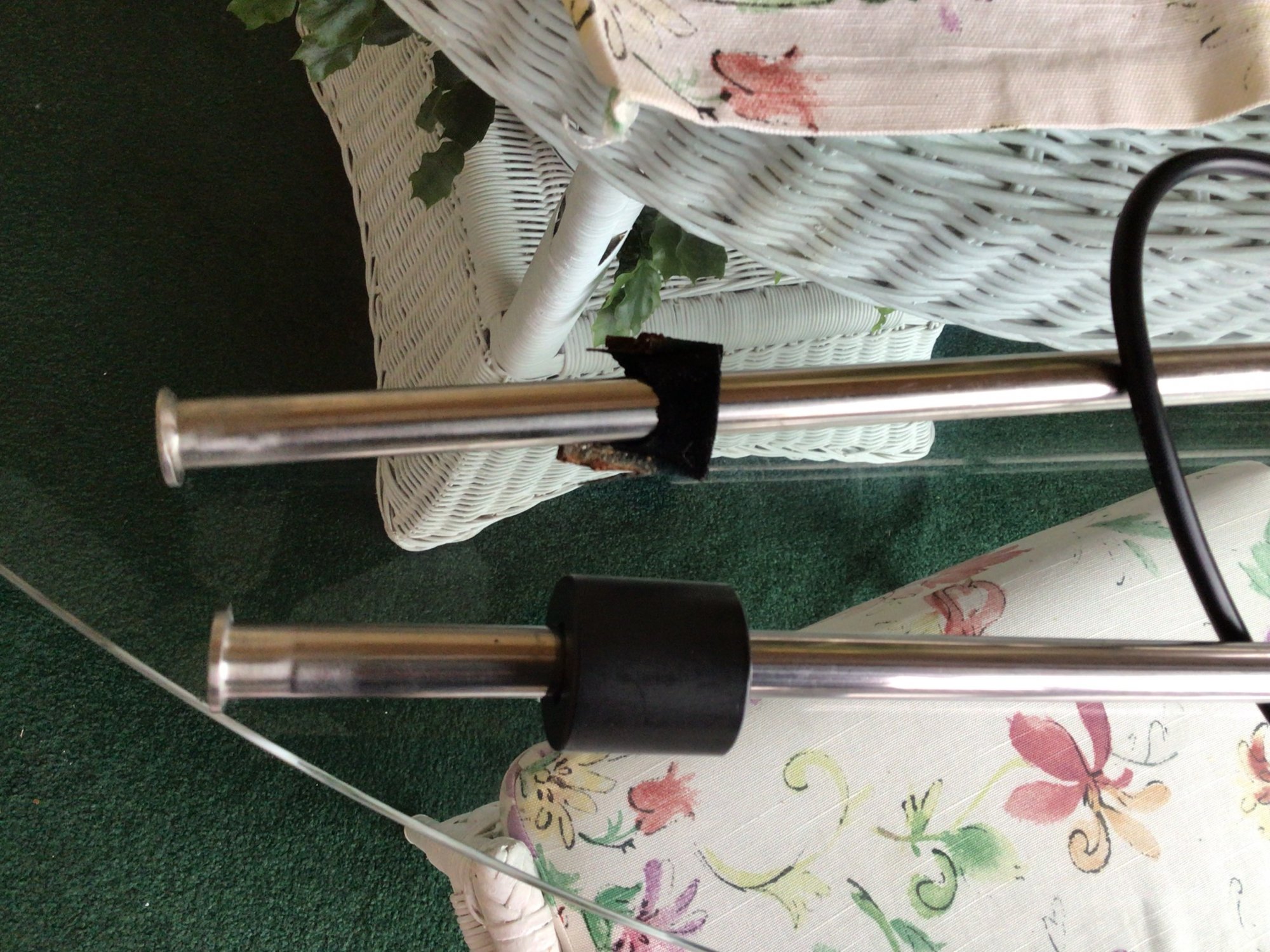

For me it wasn’t the gauge, sensor or wires. It was the float themselves. They just deteriorated. What was left of the floats, that I could handle without them falling apart in my hand, would register perfectly when moved up and down the tube.
That’s when I learned about the manufacturing differences. Imagine how shocked I was when I took this sensor out and saw that float. Bottom photo is original versus new.
Maybe that was their biodegradable model :yikes: !
Now I've GOT to check mine this summer whether UK or US model. How long were your units in service before those failed pictures were taken ?

I checked back through my log entries.
First started noticing level reading problems around 2010. Bear in mind, we’ve own our boat since new in January 2000, fresh out of the plant. I even have pictures of the build.
After 2010, the I was in denial for the next 2 years. You know, tapping the gauge, tapping the sensors, cutting the connections and crimping on new ones and hoping. And that worked for a while!
First sensors were replaced in 2012. And they worked for a while. The float’s didn’t look half as bad as your seeing now when I took them out. All was good.
Then I got the encore performance.
This year I found what you see in the photos.
I do have to say that I have never replaced the Waste Tank Sensor. And it works perfectly. Maybe because the float has a “protective” coating on it. And I don‘t really want to look and see.
I think it has a lot to do with with who was building that day and taking parts from which box of parts that were available.
For a while, I did think it was chlorine content in the water for the fresh water sensor, but that couldn’t be for the diesel fuel.
Just luck of the draw I guess.

I had same issue with my Wema Fuel gauge as @sailcapt340 . I called Wema direct.
Ans: The old float was not coated correctly.
Result was a design change to prevent the float from ever adsorbing diesel.
My new one allowed me to calibrate my tank to ± 5 gallons in a 50 gallon tank.:biggrin:
