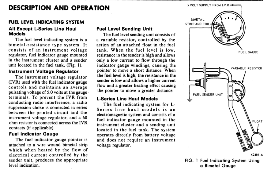

https://www.ford-trucks.com/forums/attachment.php?attachmentid=256613&stc=1&d=1516768438View attachment 211840
The unreliability of the arm type sensors is that they use a resistive potentiometer which has wear, and is open to corrisiin
The tube type uses sealed reed switches.
So, unless your magnet fails (which is exactly what happened to me), these are a lot more reliable.
