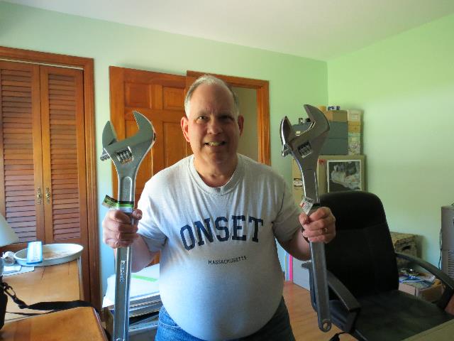

I just changed the packing in my stuffing box this week while I was in the water. Having never changed it in the water I was surprised to see how little water came in- about a pencil-sized stream. Nothing exciting. However, my lock nut was frozen to the gland and even after 2 days of PB Blaster treatment they would not budge. I was using the 10" Chinese crap-alloy adjustable wrenches that are available from WM. They are OK if the nuts are not frozen, but otherwise useless. My gland and lock nut are 2 1/4" so I got a couple 24" adjustable wrenches from Harbor Freight ($60+tax). They fit perfectly and loosening was a non-event.
See my previous post for details on the actual packing change:
http://forums.sailboatowners.com/in...box-for-1989-hunter-33-5.179637/#post-1302776

24,539
What I needed to get my stuffing box open for repacking.

Wow! I gotta get me some of them!!
I broke my nuts apart this morning after dabbing PB on them and using 2 pipe wrenches. Worked, but definitely not the best way to go. I even tried one of those special wrenches MS recommends on the wide nut, but too unstable to get a grip when laying on the engine.
