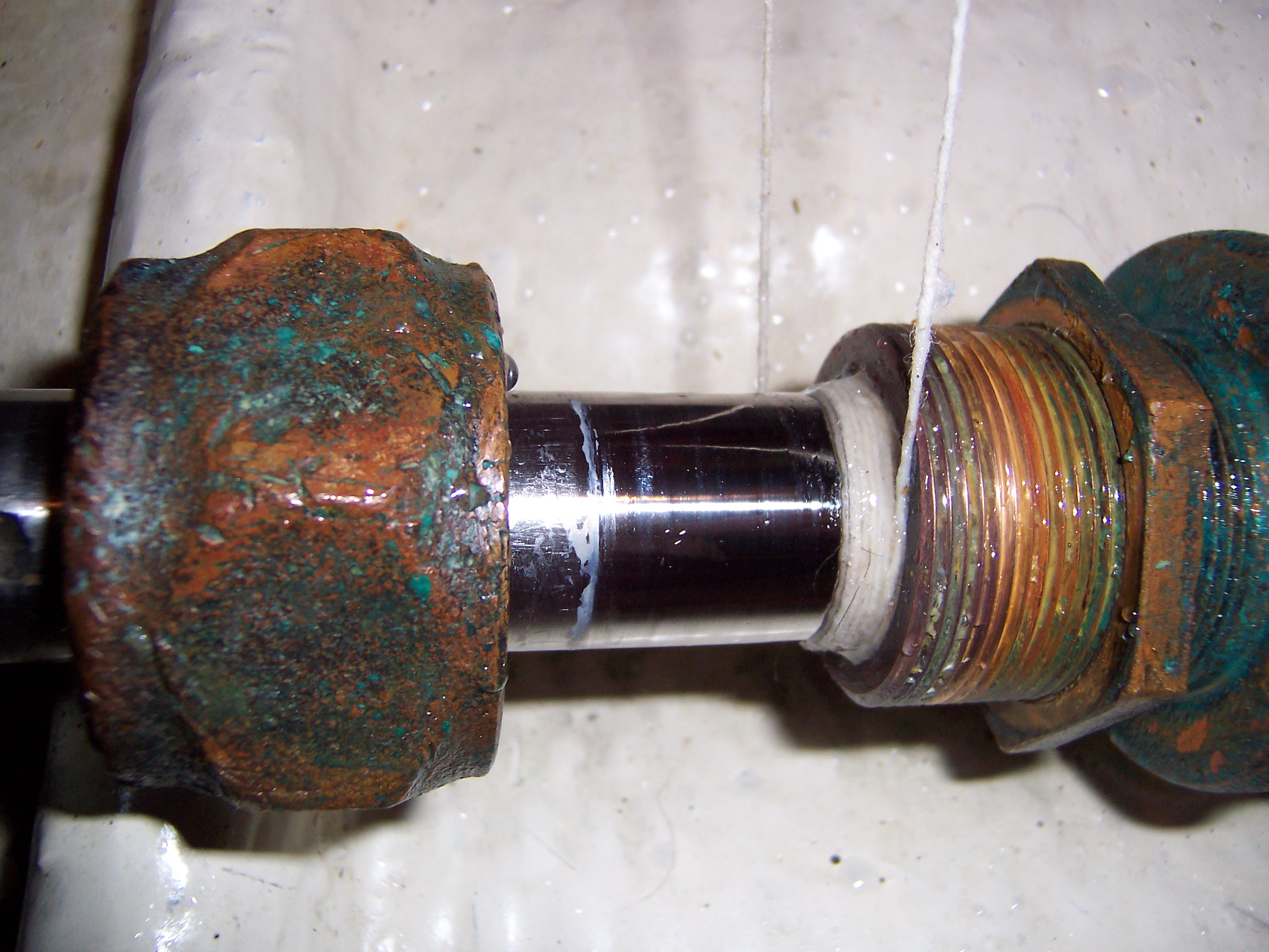

The locking nut on my bronze stuffing box is frozen. I have brushed away all of the green oxidization but still unable to back the locknut off. The inner most part closest the engine that contains the packing I was able to get loose and turn. But I have a little too much water dripping and need to tighten the unit.
Any suggestions on how to free the locknut on the threaded shaft ?

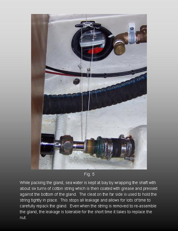

The packing can be changed in the water, but if you've never changed it before in the water is not the ideal place to learn. Cold seawater spraying in your face, water flow trying to push the packing back out, etc. It's much easier on the hard.
And if you're hauled and still can't get the nut loose, maybe you can pull the shaft and take the whole thing out of the boat where you can actually get some tools on it. And of course, once it's out you might as well replace it with a dripless model so you never have to do this again.

If not to worried about the water, adequate bilge - battery - and working pump, you can wrap a rag tightly around the shaft and it serves to minimize the water ingress. I have heard folks dive under their boat and stuff a plastic bag up and around the shaft to provide a weak seal. Remembering to go back in the water and remove the plastic bag is important.
We used the rag method and it was not a scary experience.

That looks like a great way to keep the water at bay. Might have to try that
It is going to vary with the boat, I suppose. On my previous boat (a Catalina 30) and my current boat (an Ericson 26-2) my bilge pump *easily* keeps up with the flow--and my E26 has a very small capacity electric bilge pump. I can take all the time I want changing out my packing. In your case, the first time you do it you may wish to have handy a way of reducing the flow should that prove necessary. But my guess is that it won't.
23,308
Alan's right. The amount of water that comes in is so negligible as to be laughable. If you must, wrap it with a rag.

If you haven't yet, get a bronze wire brush and treat the threads aft of the locknut, too.

I would use a bit of waterproof grease like Lubriplate or SuperLube. The locking nut when tightened is going to hold everything from loosening, so I don't think there is a safety concern.

I agree with Rich's suggestion of Superlube but in addition, undo the locknut once or twice a year to ensure it doesn't freeze in place in spite of the lubricant. All that salt water slopping over the threads can still cause problems.
