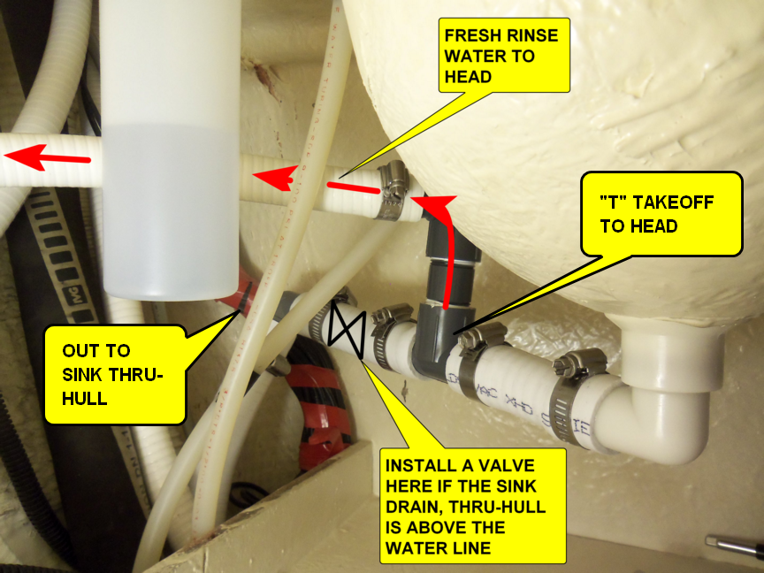

If I may offer, a valve could be added just past the "T" takeoff to the head and this would allow fresh water (from the sink) to enter the head for a final rinse before leaving the boat.
As I think about this, how would I switch between sea water and the sink fresh water if the thruhull from the sink is above the water line? I couldn’t use that line for regular “sea water flushes” and then easily switch to a fresh water flush at the end of the day.

It would be a Y-Valve. The outlet goes to the pump, one leg goes to the sink drain the other to the seacock. Sort of backwards to the Y-valve on the discharge side.

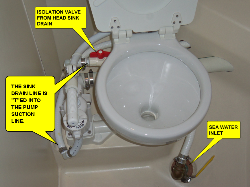

Jan 4, 2006
7,740
Hi Greg,
This is the alteration I made to my existing system although I didn't bother to install the hand drawn valve. My sink drain is below the water line and the thru-hull cock is easily accessible so no need.
When it comes time to rinse the system before leaving the boat for any length of time, in your case you would close the hand drawn valve and start running water into the sink.
Twist sideways to the head and close the sea water inlet valve and open the isolation valve to the pump inlet line. Pump away with fresh rinse water.
The advantage of this setup is that everything is done within the confines of the head and only takes a short time. Only the boat owner would be doing this final rinse.

Love your annotations and photos Ralph. Certainly helps me visualize the setup.
