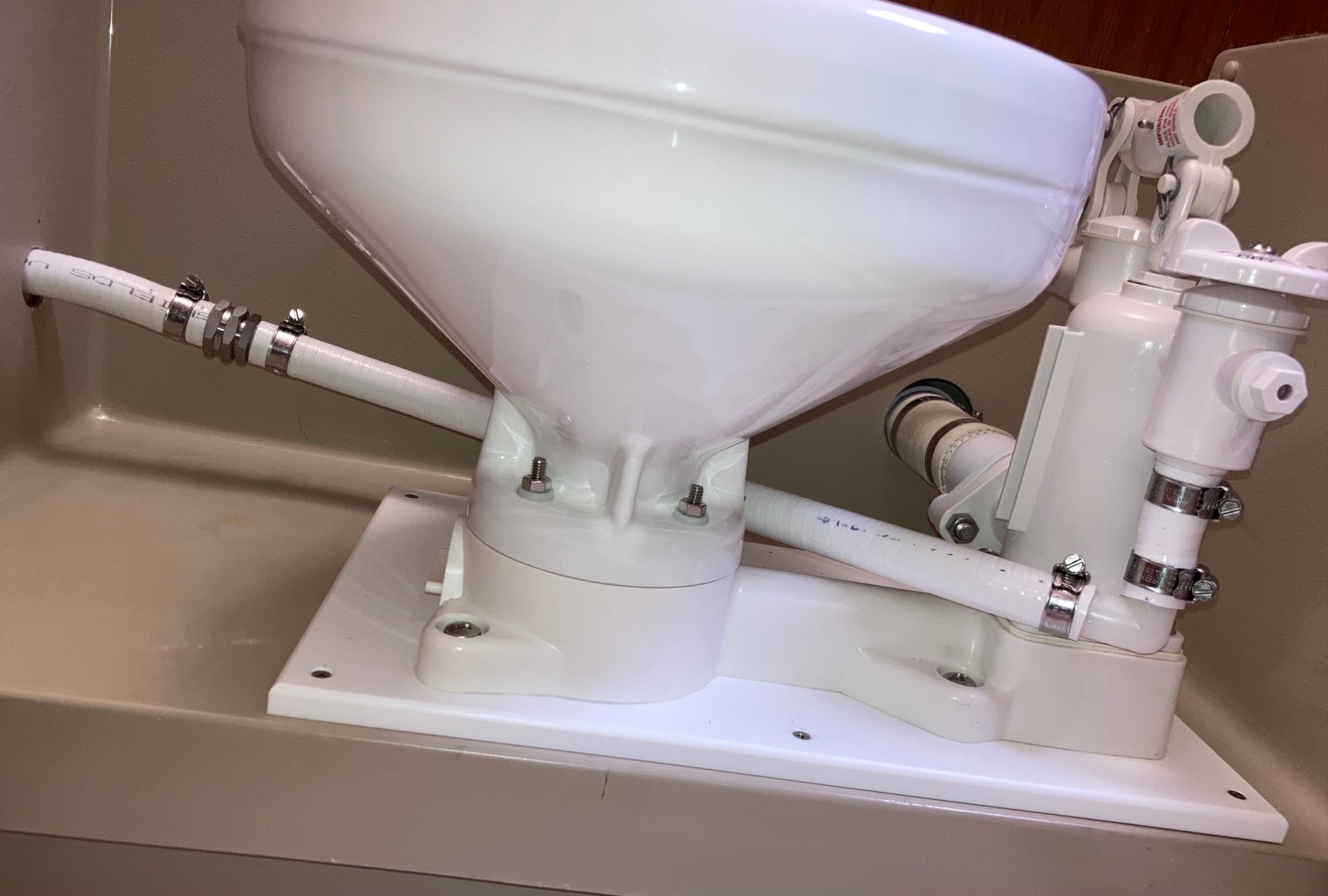

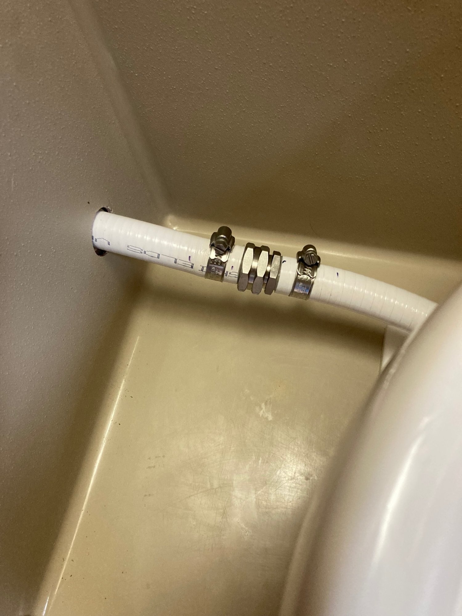

As some other members mentioned, Peggie's book is a marvelous reference and my head rebuild project would not have come out as good without it. Regarding odors, I went to considerable lengths to (more than!) adequately vent the holding tank; and as her book explains, is key to addressing the issue. This, combined with all new Saniflex hose, new head, "Y" valve, PVC pipe etc. has eliminated my odor problem. However, because the sink and fresh water tank are located on the starboard side of my O'day 28 and the head is on the port side, I could not readily rig up something permanent to be able to do a periodic freshwater flush. Also, space is tight and I decided to forego a second tank or bladder. Nevertheless, the solution I went with effectively kills two birds with one stone.
I found a company in Nevada that sells 316 stainless "garden hose" fittings (primarily for use in food processing plants) and installed one of these in the raw water inlet line between the seawater inlet valve and the the pump (see attached images). Once a week or so I break this fitting (after confirming that the inlet valve is closed!) and connect a hose which is long enough to reach the inspection port on the top of the potable water tank. I run enough FW through to slightly change the holding tank level and call it good. The second advantage of this setup is that I can winterize the head without removing any hoses. If anyone wants to know more about where to get this fitting, do not hesitate to PM me.
