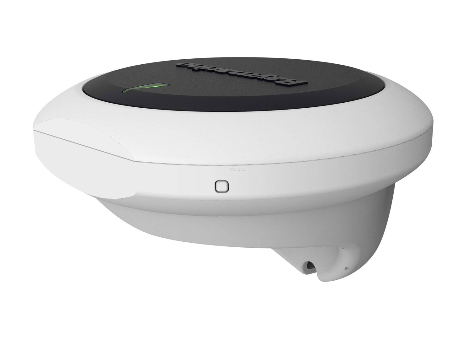

24,759
The design of the Fluxgate compass is legendary, much like the Flux Compactor
They have been surpassed by the newer sensors...
