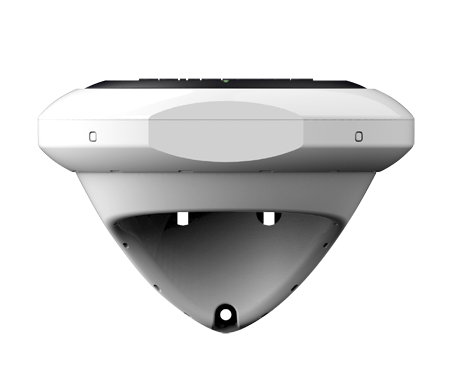

I have a Raymarine Axiom.
The Axiom is Raymarine's display. It is not an Auto Pilot.
The newest models of AP's are the Evolution series. EV 100-400
It does not use a "Fluxgate Compass".
It uses a Sensor.
Looks like this

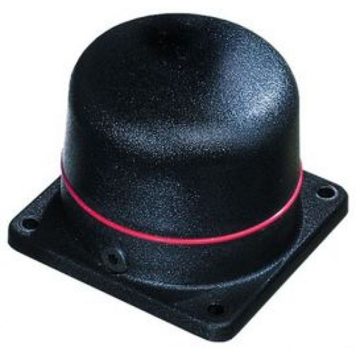

The older systems often called by the original manufactures name... AutoHelm.
It did use a "Fluxgate Compass".

Find the Smart Pilot Computer and follow the cord to the Fluxgate compass.
