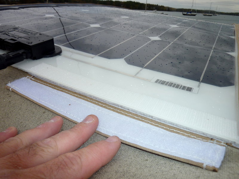

The panels, or this type, were invented for marine use by Solbian of Italy. They are ideally suited to be affixed to a bimini top or canvas in a semi permanent installation. Alternatively they can be affixed to the deck but efficiency can drop off due to the inability to dissipate heat as well as they do on a bimini..
Of course the Chinese who stole the technology from Solbian do a very poor job of both copying the Solbian and educating consumers as to how best to install or use them.
In most installations they are mounted straight to the canvas using Velcro. The Sunbrella disipates heat extremely well and I find they actually run cooler than rigid frame glass panels likely due to their being less thermal mass, of the glass, to retain the heat.
Note the junction box on a genuine Solbian...

They should be thinner than 1/8" but I would not doubt a 1/8" knock off. At the Newport show the importer had a Chinese knock off in the Solbian booth (he is not afraid to show customers the differences). It was heavier, horribly assembled, the j-box and wiring was a joke and it already had blisters/bubbles in it.
We have also seen many of the knock offs not putting out anywhere close to their rating. The performance warranty is also very lacking (on one brand there is none, workmanship and materials only for 5 years). Check with Renogy on the specific performance warranty for the flexible panels.
The best advice I can give is to A/B test all the panels BEFORE you install them. They should all have near identical performance. If not keep sending them back until you get a matched set. Look at both current and voltage when you test them. Best to build an easel and set them on it on a clear day so all A/B's are comparable.
If you do that and they last a few years you got a good deal. DO NOT buy these panels and not test them!!!!
DO NOT bend these panels anywhere near the 30 degrees they suggest you can!!!!!
While the Solbian panels are a lot more expensive they are far superior in construction, they were built and intended for the marine environment and have a proven round the world record as they are widely used by Vendee Globe racers...

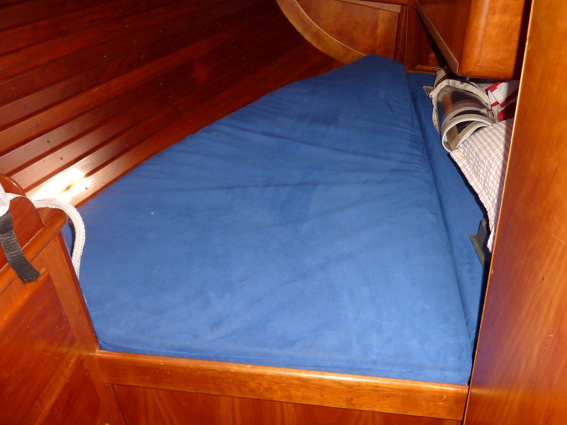

The best part about any semi flexible panel is the ability for them to be slid under a berth mattress during storms. Out of the way and no sharp edges banging around the cabin.
There is a Solbian 125W panel under this one:
