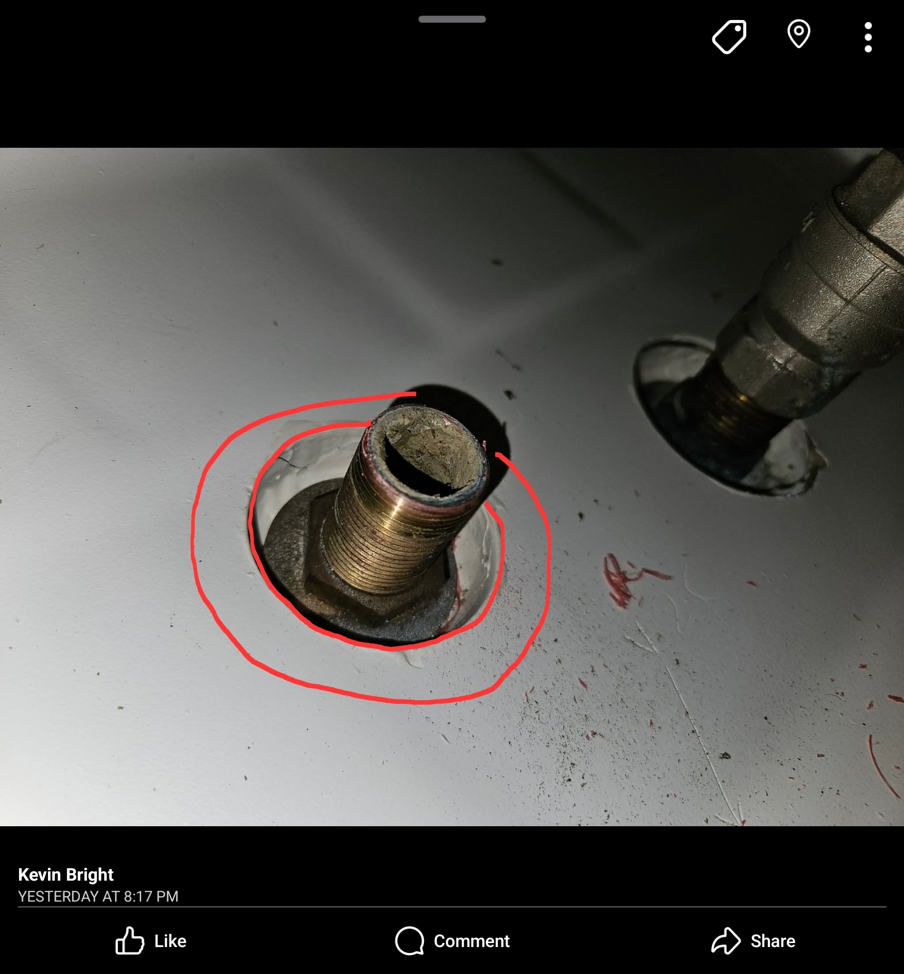

In a 2009 Beneteau, they are brass. You can even see dezincification beginning on it.

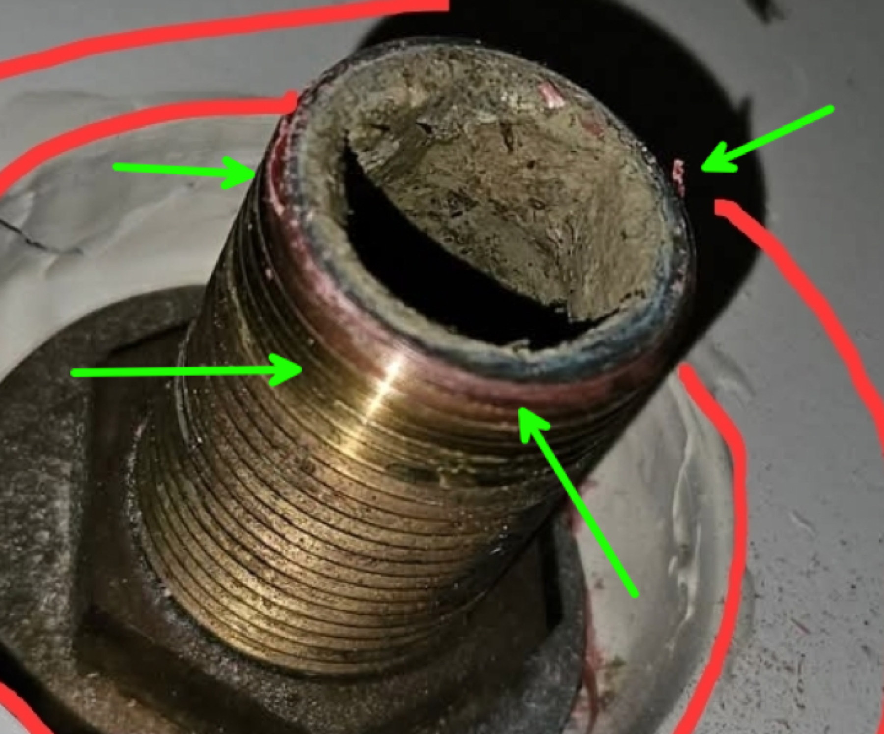

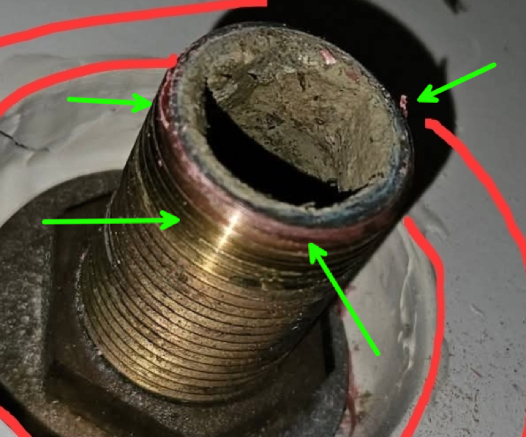

Someone posted a response by Beneteau saying they are duplex brass - which DZR is one. But even without that, would you expect bronze to look like this? Even after 16yrs? Half of the threads that held the valve on it are pitting, peeling, and dezinced.
It is possible that this isn't what I'm thinking, and that pink and pitting/peeling is just residual thread lock compound, but the yellow color isn't something I've seen in marine bronzes.

Your comments and indications i don't agree with at first blush, but one would really need it in hand to know

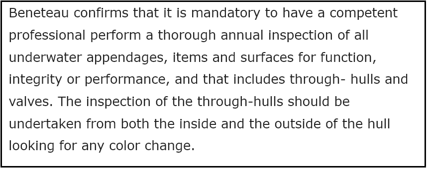

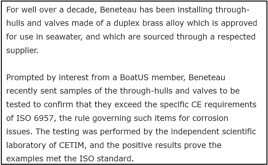

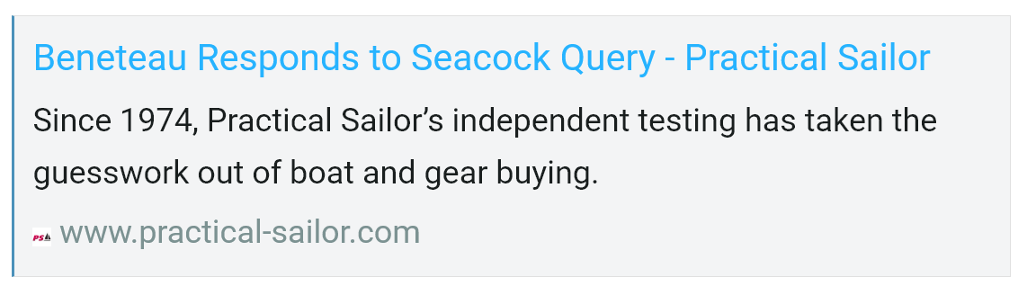

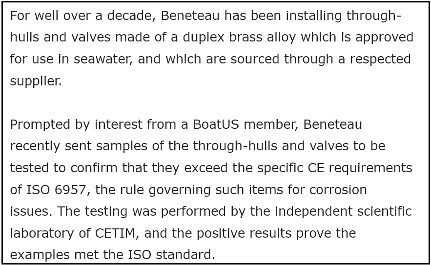

This is taken from the above link referring to the responce from Beneteau to Practical Sailor courtesy of @Richard19068 :
It exceeds the requirements of ISO 6957. Attached below is a test of ISO 6957 done for a major valve supplier whose products I am very familiar with. Pretty much cinches that argument..
Beneteau explicitly states these seacocks have a 5 year lifespan. The CE certificate it is built to only requires a 5yr lifespan on seacocks. This is well-known.
After reading the above unembellished statement, this is exactly why I wanted to see some form of authentication. Thank you @Richard19068 for this article.

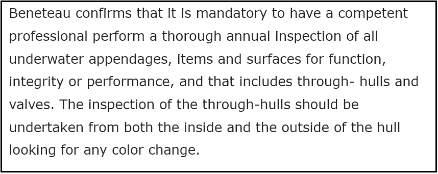

Further taken from Beneteau's above reply :
Having a professional perform an inspection may be a bit of an over-reach on Beneteau's part but no more than CYA. If a cleaned and polished section looks like shiny yellow metal, you're good to go.
I'm not a professional in this area but every time I have the boat out sitting on the hard for a bottom painting, I will file and emery a small section of a different (each time) mushroom flange on the bottom of the thru-hull to check its integrity. So far, so good.
You might want to find out exactly what DZR brass is before banishing it to the scrap heap :
The Different Types of Brass: A Comprehensive Guide | The Federal Group USA
Believe anything you want. At first you didn't believe they were not bronze and now you know better. Now you want to believe they are not failing in these boats in spite of all of the evidence available for the googling.
I know exactly what DZR brass is. As I stated, I was a proponent of it, and defended its use in this application for a long time. I've been disabused of this opinion from seeing many examples of these boats, talking to many owners with problems, and reading about them in forums for many years.
That standard you posted is a test of the properties, not a long-term test or suitability test for thruhulls. Beneteau itself state they only have a 5yr useable lifespan, which just matches the CE requirements.
Your scratch test is good for the immediate surface you scratched, but you have no idea what is going on in the threads or valves in the system. Dezincification is usually a concentrated or localized phenomenon until it totally eats out the part or the part suddenly fails at that spot. Besides, if yours are bronze you have little to worry about - particularly if they are unbonded.
