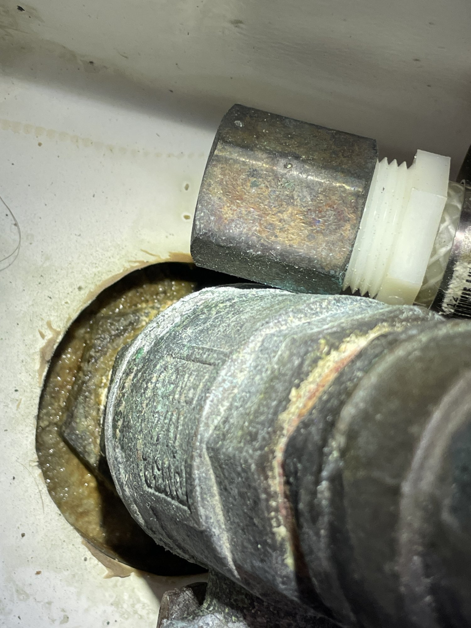

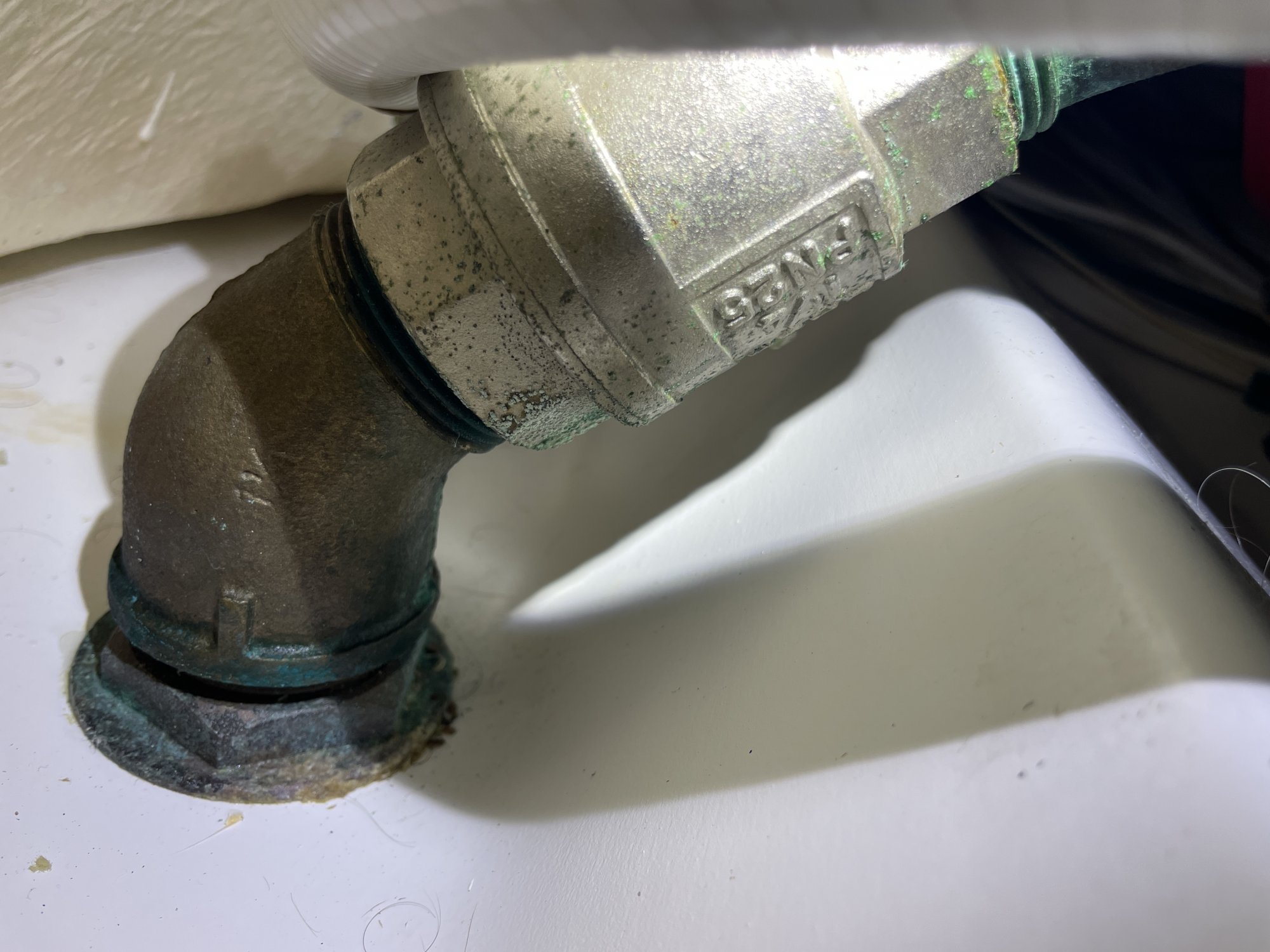

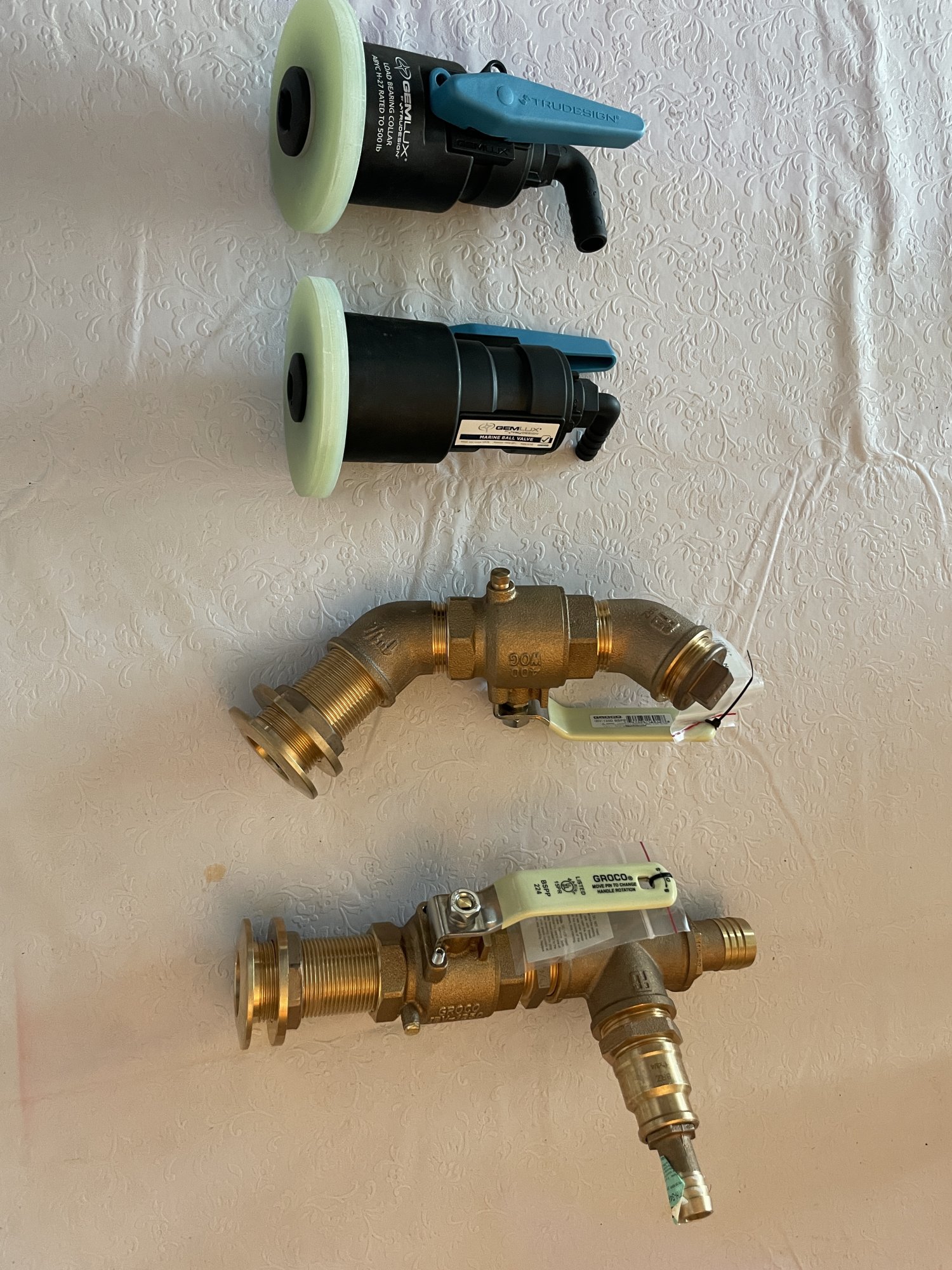

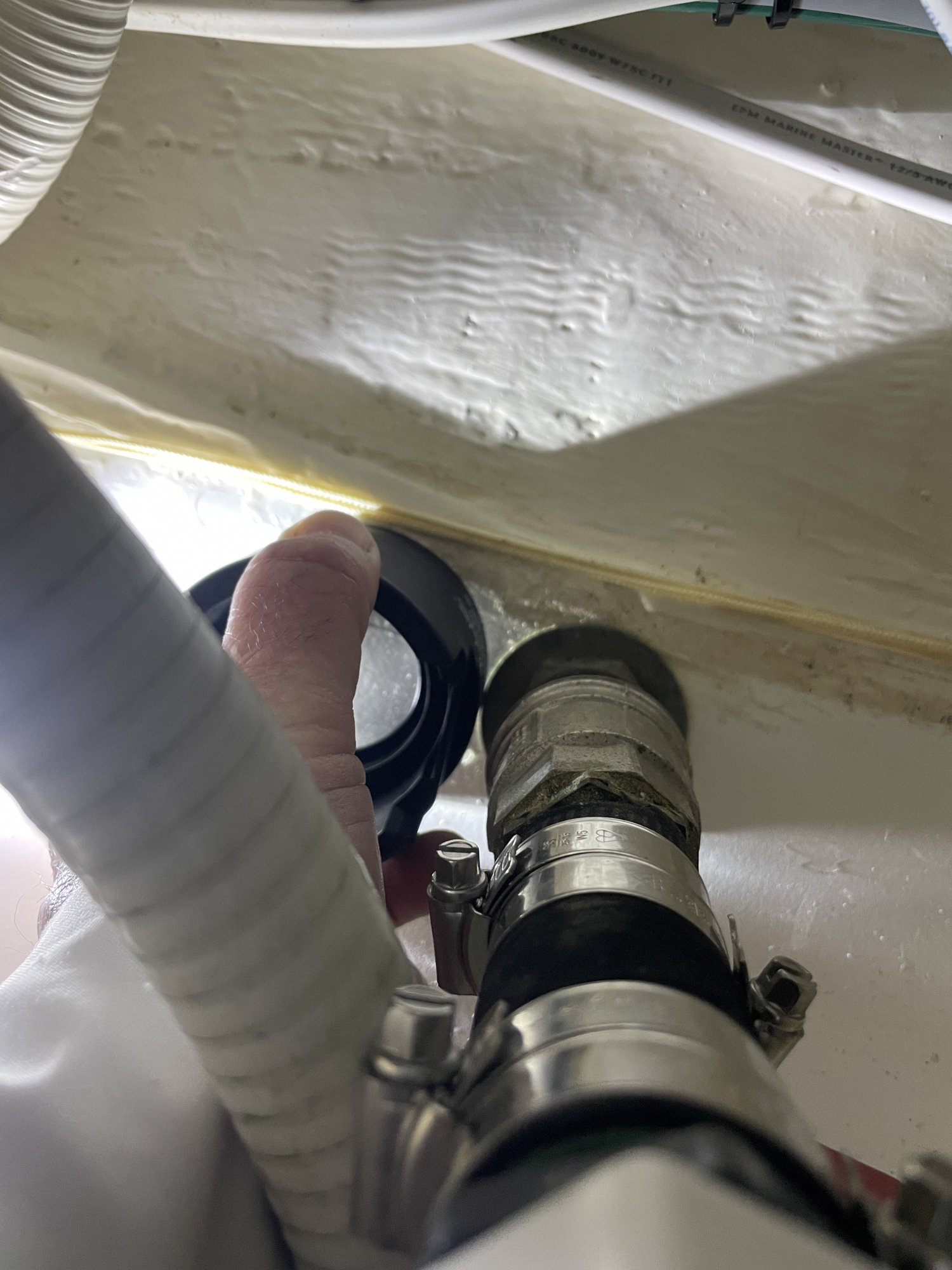

To the OP and others in a similar situation who may come along later,
I'm not here to debate anyone on this thread. I'm contributing because I own an '05 Beneteau 323, which has a similar production design regarding the hull grid liner/matrix system. Currently, I am in the parts acquisition and planning stages of a haul-out that includes thru-hull replacement, and I believe I can add something productive.
I'm not going to delve into the finer points of brass composition. However, based on my research and discussions with various sources at Beneteau in South Carolina and Sean at Groco, Beneteau used brass in the mid-2000s, presumable for cost reasons, designed to be replaced every five years due to CE rating requirements. At some point—perhaps around 12 years ago—they transitioned to sourcing Groco bronze fittings, at least for their U.S. boats (per Sean at Groco). In fact, if you visit your local Beneteau dealer and have them create an account for you, you'll find that the replacement fittings today are bronze Groco fittings. Spare Parts Beneteau USA
From my perspective, if you're hauling out a 20-year-old boat and still have the original or outdated thru-hulls, valves, and fittings, skip the microscopic examination of their metallic composition and proceed directly with a full replacement. The cost is trivial in "boat dollars" once you're already hauled out—far preferable to the alternative (e.g., a sinking boat).
My Choice of Fittings
I’ve chosen to use TruDesign thru-hulls and fittings where feasible and Groco BSPP valves and Guidi BSPP thru-hulls and fittings (all high-quality bronze, no DZR) where TruDesign fittings won't work.

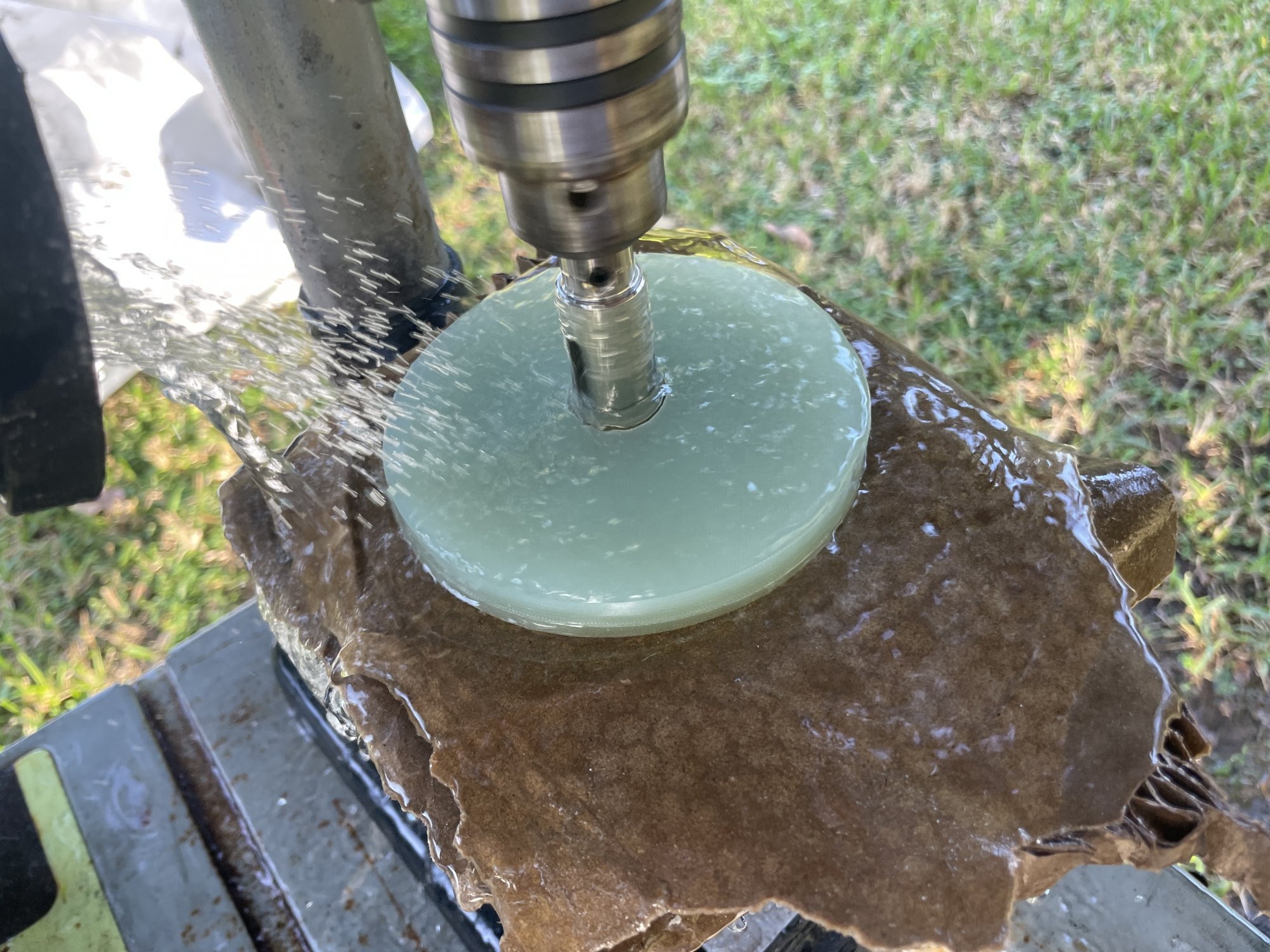

  • TruDesign with collar and 1/2" G10 back plates (see pics)
    • Engine cooling water intake
    • Stern/cutlass water cooling intake
    • Two of the head fittings I can make work
  • Groco/Guidi fittings(for locations where TruDesign won't work due to space constraints or where modifying the liner seems be too invasive)
    • Both galley fittings

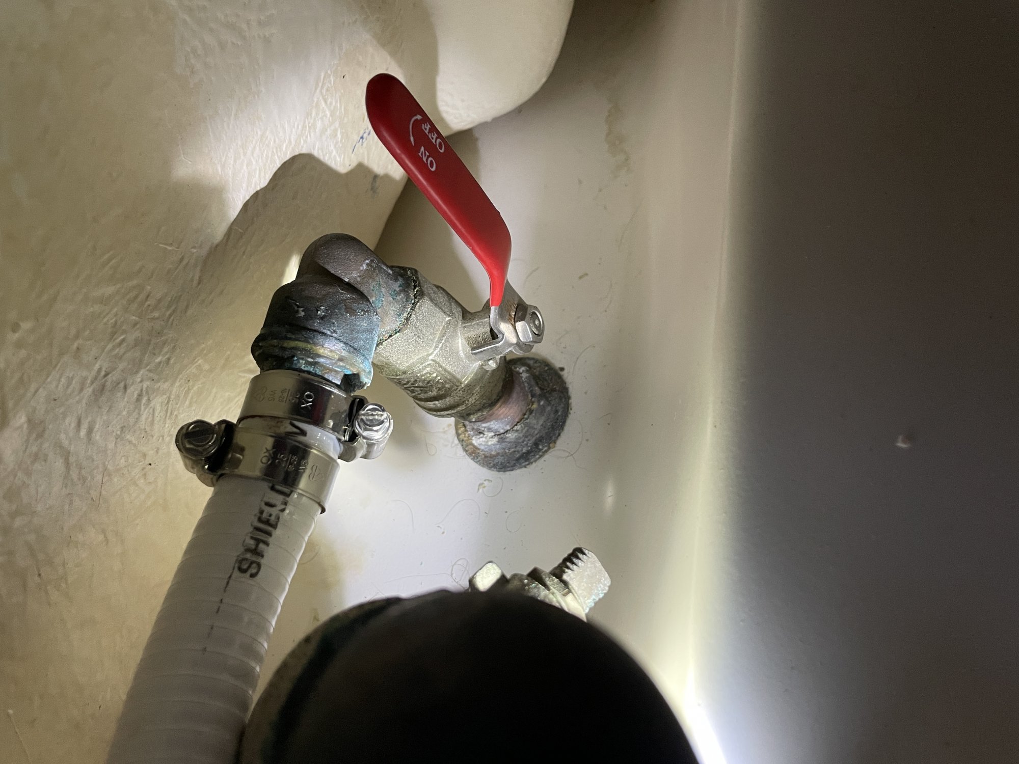

    • Two head fittings (see pics w/ 45 degree angle fitting)

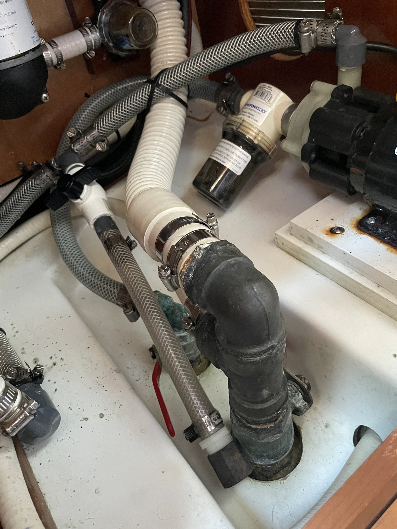

    • I encountered the same issue with the galley sink drain (see pic) and debated cutting into the liner to accommodate a proper-sized backplate. I may still do that once I tear everything apart on the hard if it looks feasible. However, I already have the thru-hulls and valves on hand, allowing me to replace them with the same configuration as currently installed—just with much higher-grade materials.
    • These areas are protected from major impacts since they are either under the galley sink or the head sink in a cabinet. They’re not easily tripped over or stepped on (at least unintentionally).
Why BSPP?
  • TruDesign sells both NPS and BSPP fittings, both of which receive excellent reviews (source: Gemlux). When installed with adhesive sealant, BSPP connections do not leak. A backing nut is also an option.
  • This setup works well in bronze as well.
  • There are no bronze NPS thru-hull/valve combinations sold in the U.S.
  • However, Groco and European suppliers do sell BSPP thru-hull/valve combinations.
  • To replicate what TruDesign does with their product and to align with European practices, I’m using a BSPP + adhesive sealant combination for the bronze fittings.
Benefits of BSPP:
✔ Complete threading and seating of the fittings to each other
✔ Avoids the NPT/NPS combination issue (which often results in a connection with only ~2 threads engaged)
✔ Eliminates the Groco Combo NPT/NPS thru-hull issue with a valve (where you may get 4 threads, but then can’t cut the thru-hull down, leaving it unnecessarily long and protruding). By the way, per Sean, all their bronze thru-hulls are combo NPT/NPS, and of course cutting them down is not an issue if you're using their seacocks or their flanged adapter.
Why Guidi BSPP Thru-Hulls Instead of Groco BSPP Thru-Hulls?
Hint: Not because I prefer fancy, expensive Italian fittings…
  • I originally ordered Groco BSPP thru-hulls and returned them all.
    Why?

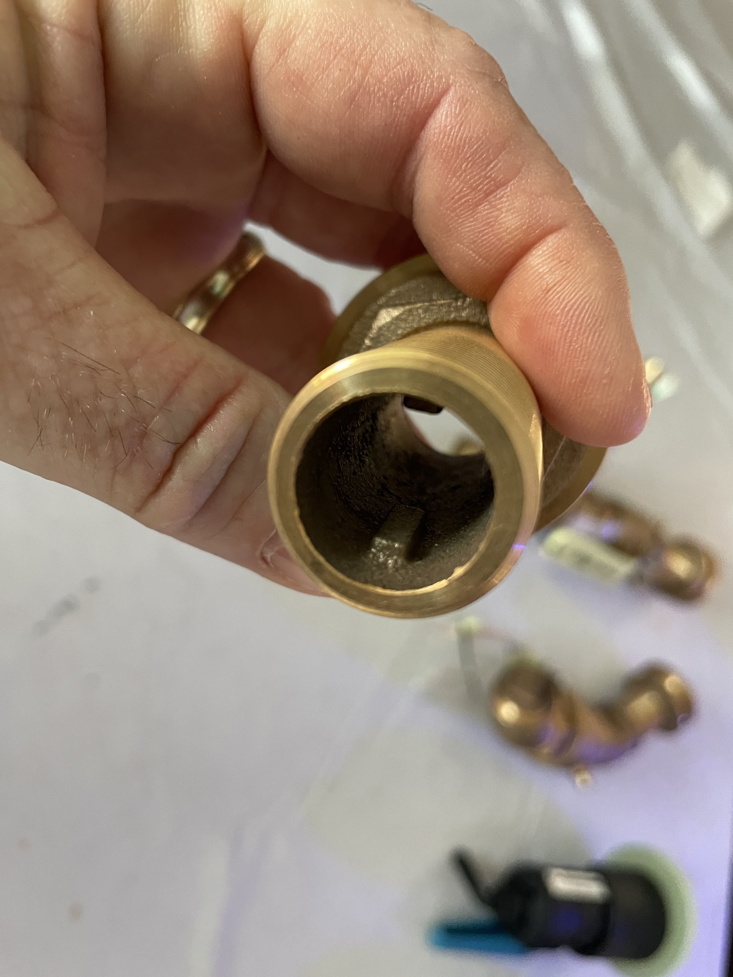

    • The interior lugs were positioned at the inside thread end rather than the flange end (facepalm moment).
    • Because of this, you cannot cut them down to a smaller size without losing the ability to grip the lugs with a thru-hull wrench.
    • I called Groco and spoke with Sean about this. Given my relative inexperience with sailboats, I wondered if I was missing something.
      • Surprisingly, I was the first person to ask about this in the 12 years since Groco released them.
      • Sean had to put me on hold and check with the owner.
      • Turns out, they were made specifically for Beneteau—that’s how Beneteau wanted them.
      • Beneteau doesn’t bother cutting them down and assumes it's easier to tighten them from the inside.
    • So, I returned all the Groco BSPP fittings.
Why Guidi?
  • They were the only manufacturer I could find in the U.S. that produces quality bronze BSPP thru-hulls and fittings with lugs on the flange end.
  • Sources:
    • Aquastar
    • Environmental Marine
    • Note: The fittings from Aquastar were functional but pricey. Unfortunately, they arrived slightly dinged up, which was frustrating given the cost. I reached out to them about this but received no response.
Curious why the backing plate with the collar? Is the hull too thin there for the minimum thickness requirement of the fitting?
Mark
jbmia
Jul 22, 2021
31
Beneteau 323 S. Florida
Mark
Currently there are wooden backing plates in that area... Not original OEM, so not sure what was there before... Haven't seen hull thickness there yet... Figured I'd just replicate what's there now, but with the G10 improvement. G10, in the quantity I need, is not a lot of money and I have a drill press, a few cheapy diamond hole saws from Amazon, some water and bob's your uncle.. Not hard, so figured I just go all in where I can.
