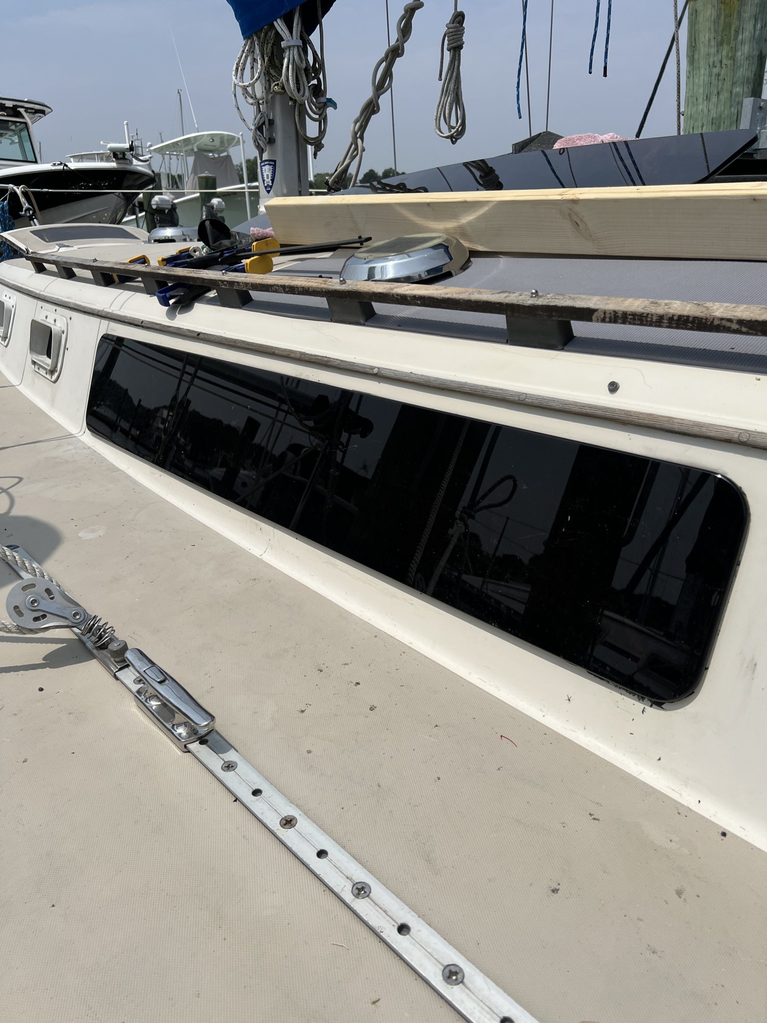

I want to replace the frameless fixed windows on my Hunter 39. Does anyone know where to source the material? I'm assuming it is acrylic but if anyone knows exactly please let me know. Also if anyone knows the percent of tint. I can cut the raw material so that is not a problem. I'm having a problem finding where to buy it so any advice will be greatly appreciated.

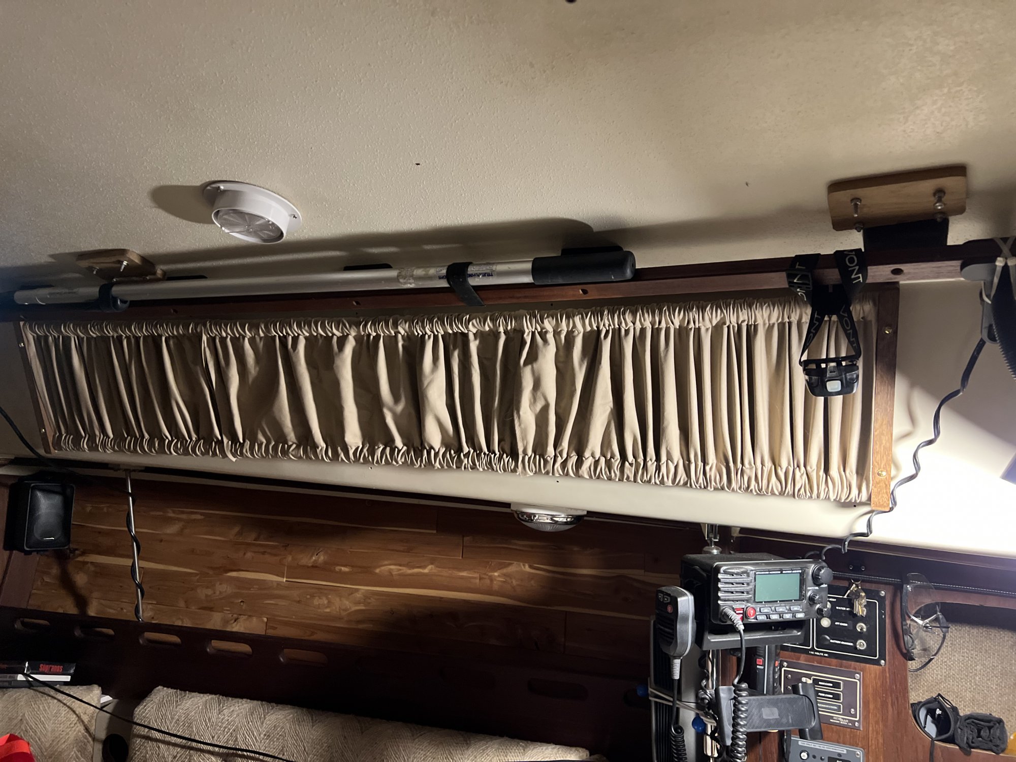

I believe thats what I got. What ever is the darkest. During the day you cannot see in unless you have a bright light on inside the cabin. Seeing out is like looking through sunglasses. To help with privacy I made and added curtains.

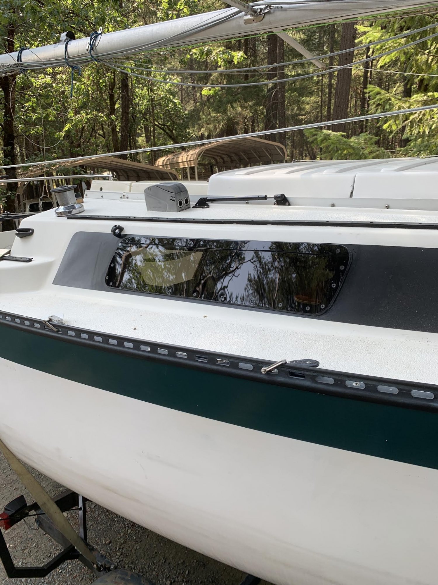

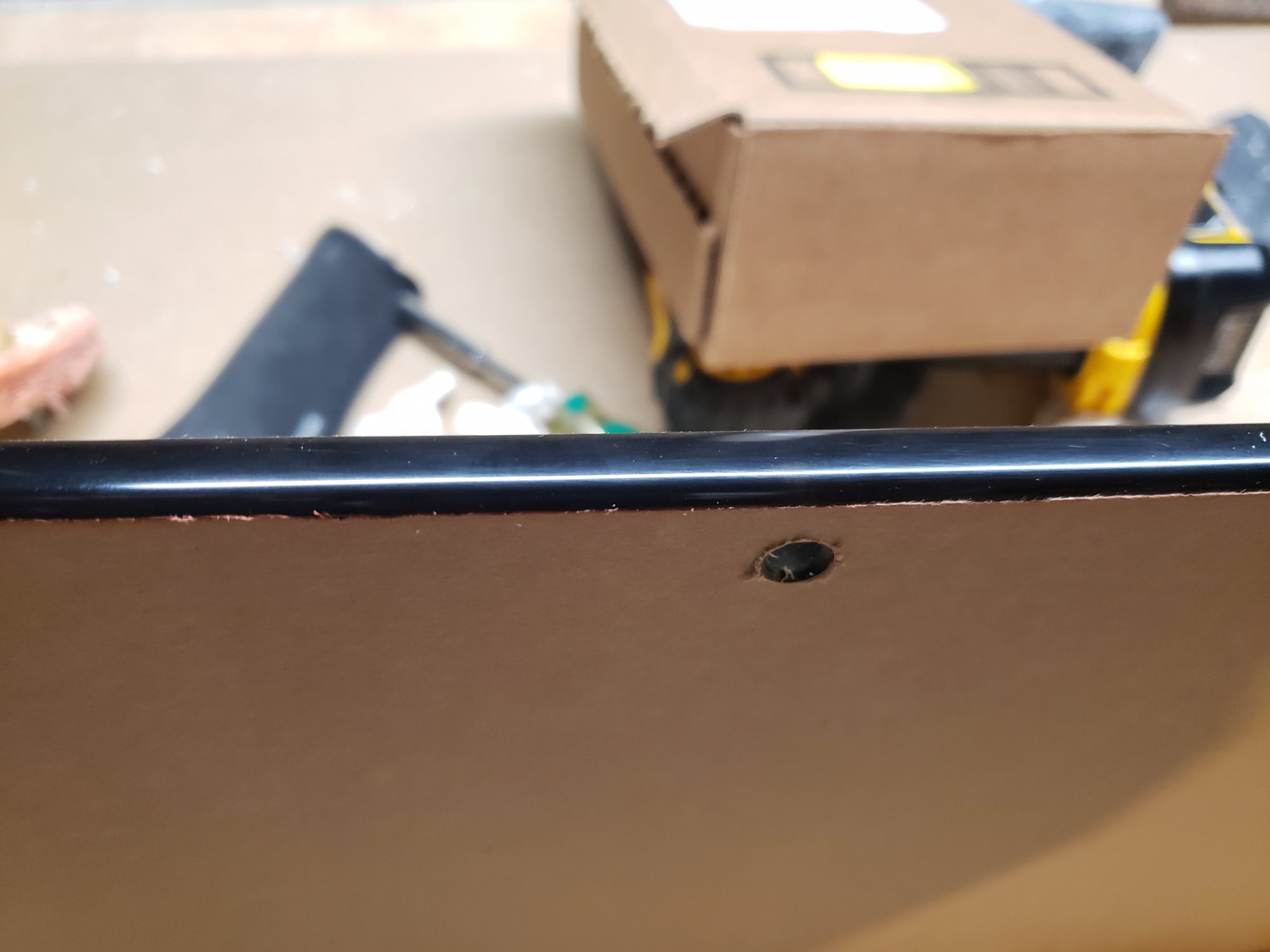

I got mine from TAP plastics, they were the only source I found that had what I wanted in the right sizes. I could not find affordable UV resistant polycarbonate. I ordered 3 rectangular blanks of acrylic a bit oversized. I got dark smoke, but regret it. It blocks the heat and affords amazing privacy (you can't see in, even at night, unless you are really close), but is very dark in the boat now. I'd go for light smoke if I did it again.
I rough cut the blanks with a jig saw, used a flush cut router and the old window as a template to get the final dimensions. Cleaned up the router marks with sand paper, used a round over router for a nice edge, and finished with finer grades of sand paper and polish.
