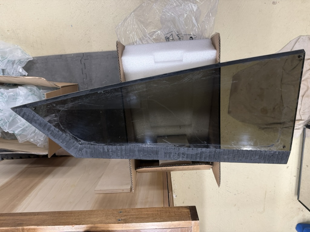

I think it would be easier to do the bevel with a router (many libraries will lend you a router or other tools.) Mine were a bevel, but I like the round over better.

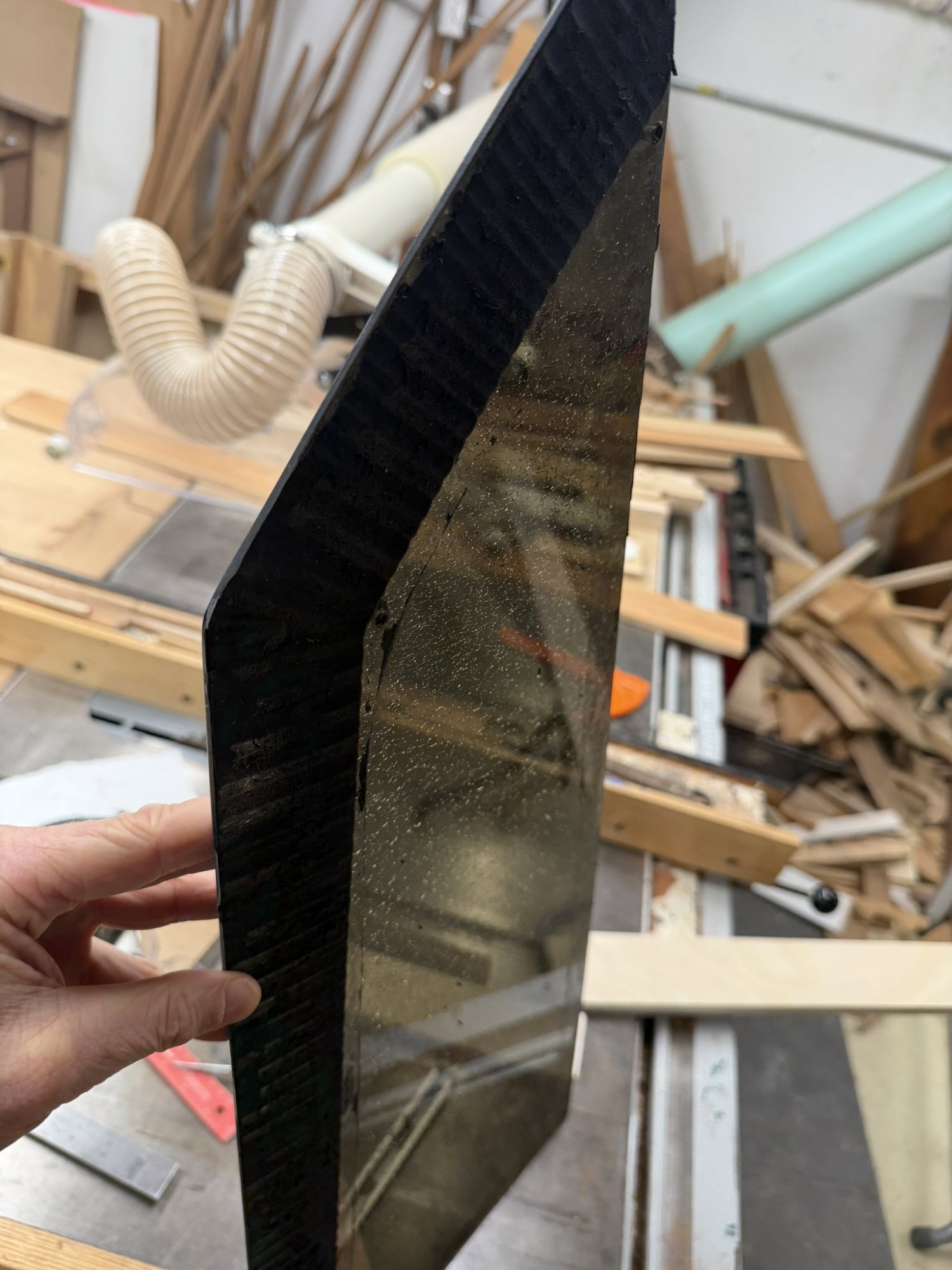

That's a steep bevel... I'd definitely cut that with my jig saw. I'd take a piece of 2X4 or 2X6, run the short edge through a planer/jointer to make a nice flat surface. I'd then clamp that to the backside of the window so I had a nice stable surface for my jig saw base. I'd set my jig saw to the correct angle and cut each of the bevel sides that way. Then finish it up using a sander. You can shape the corner in that step. You'll end up with a much nicer looking bevel in the process...
dj
Don't take any paper off the part until it's completely finished... You can use lines on the paper to help guide your cut.

I wanted to give an update with this in hopes someone finds it useful. I was able to source a sheet of acrylic through a local distributor Total Plastics in Cranston RI. I got Tru Cast Acrylic Gray #2074 which seems to be a good match. They cut the sheet up for me into 9 equal rectangles which worked well for all of my port lights. I used a Freud table saw blade for plexiglass. That work really well. Very good cuts no blow out. I also used a Bosch T102BF 3 pc. 3-5/8 in. 13 TPI Clean for Plexiglas T-Shank Jig Saw Blades for the curved cuts. The port lights came out very well. I am now installing them with Dowsil 795.
