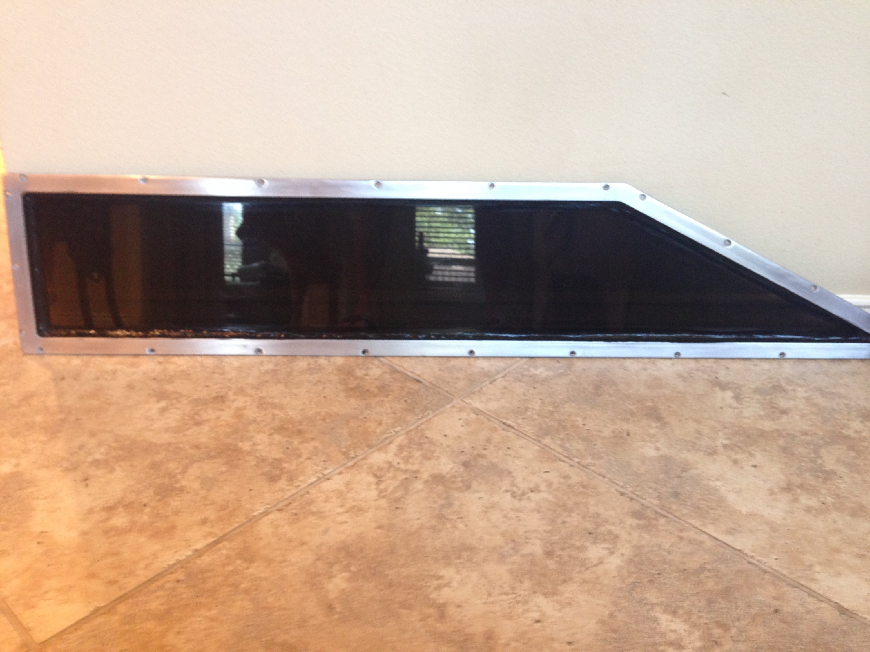

Pateco,

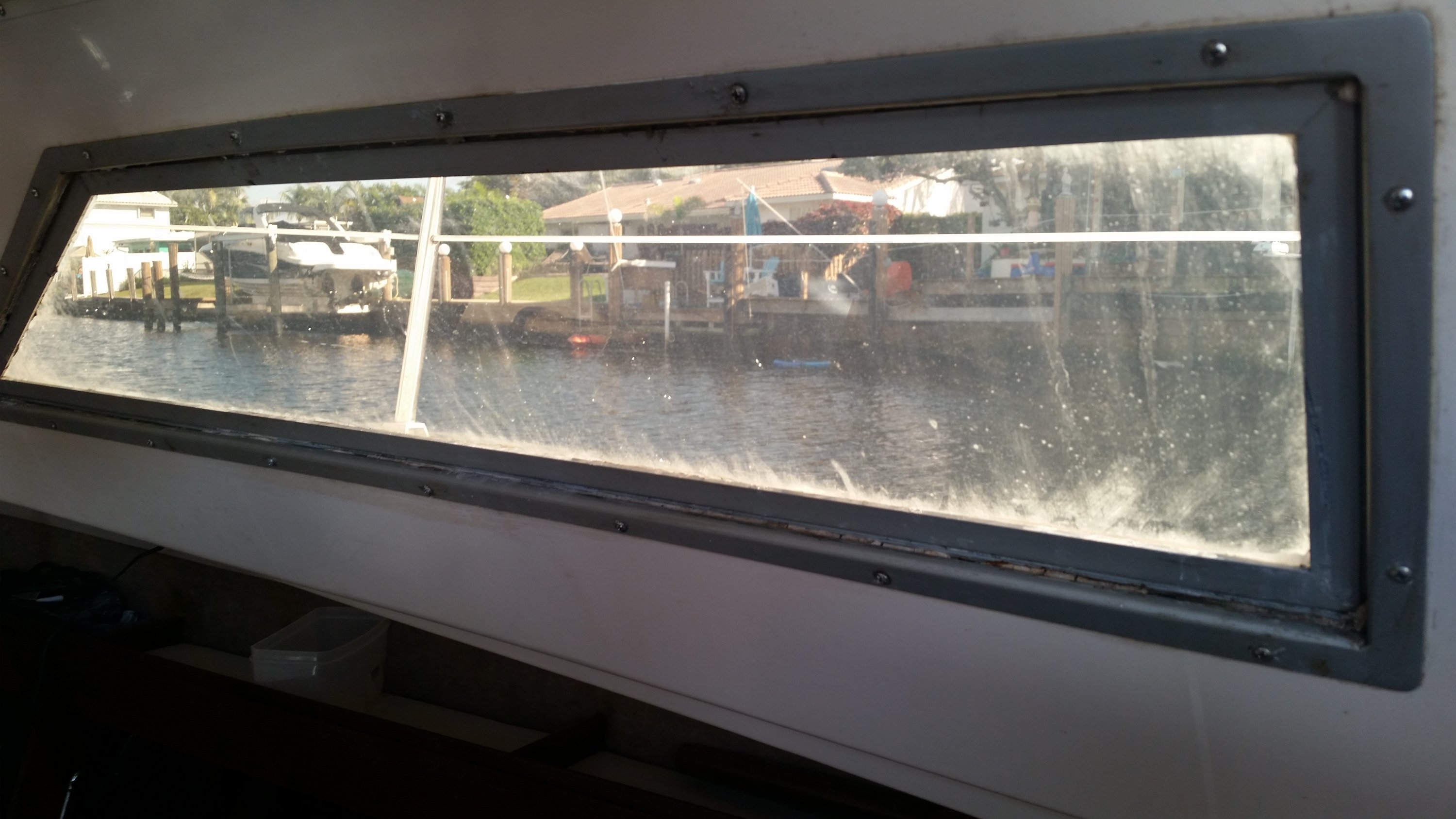

My acrylic was pretty crazed so we chose to replace it with Lexan. Ours was tinted kind of smoke gray so we went back with as close a match as we could. We did not use Dow 795, we used Boat Life-Boat Seal and I used black to blend into the Lexan. This is the only picture I can find.
Likes: pateco
pateco
Aug 12, 2014
2,207
Pateco,
My acrylic was pretty crazed so we chose to replace it with Lexan. Ours was tinted kind of smoke gray so we went back with as close a match as we could. We did not use Dow 795, we used Boat Life-Boat Seal and I used black to blend into the Lexan. This is the only picture I can find. View attachment 119291
Looks good. I think I will polish and not paint.

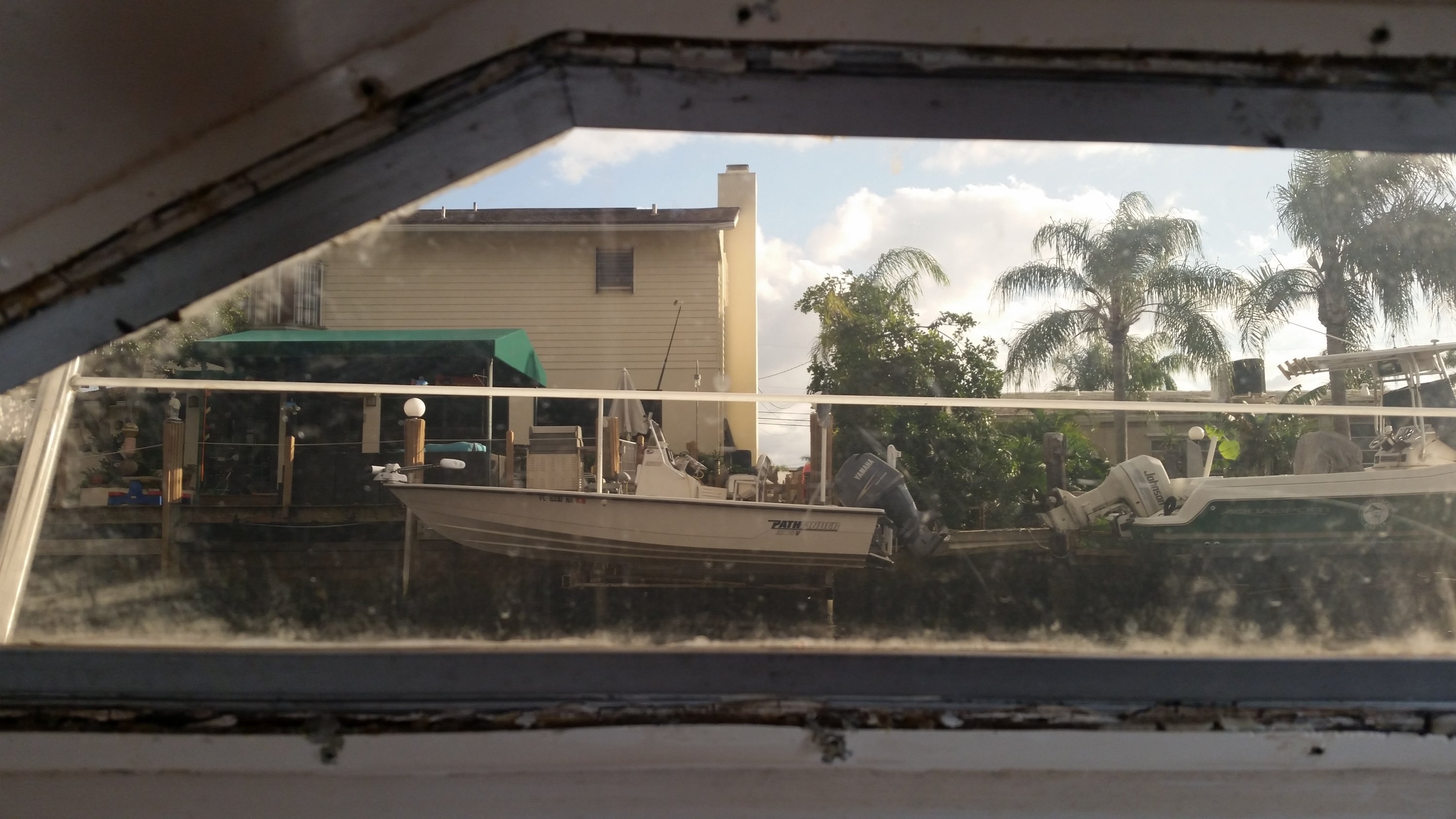

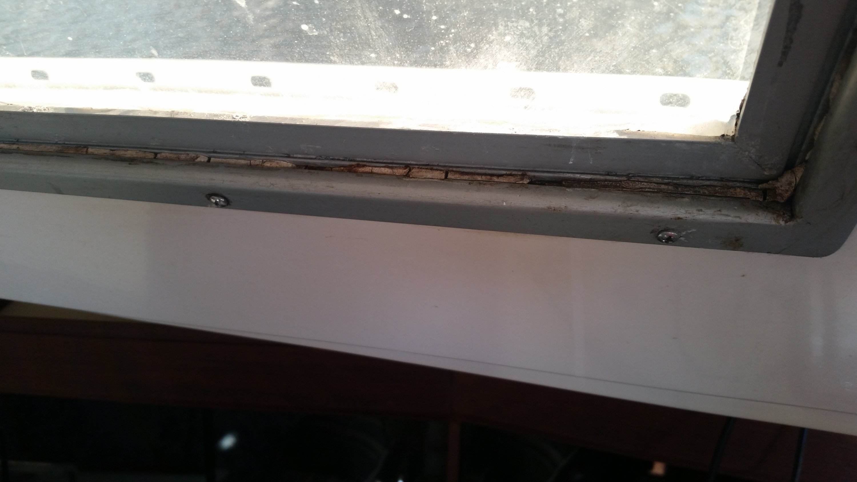

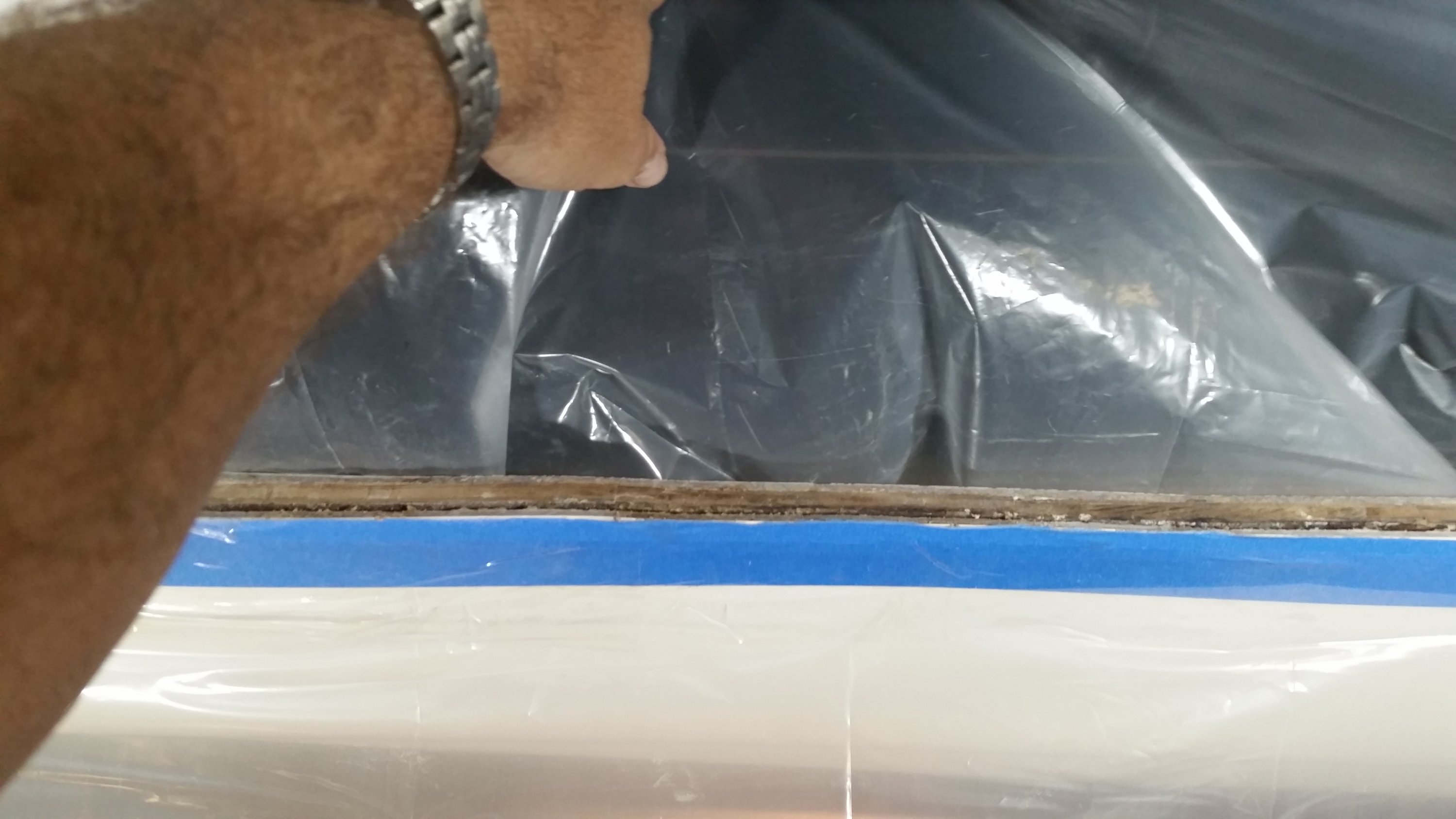

So I Started on the first one yesterday afternoon.
You can see how cracked an brittle the latest sealant has become, including evidence of a major leak dripping from the bottom
So I first took off the inside trim. Cracked and nasty sealant is readily apparent.
Then I took off the outside frame with the Plexiglas. It looks like three different type of sealant have been used without proper prep before each one.

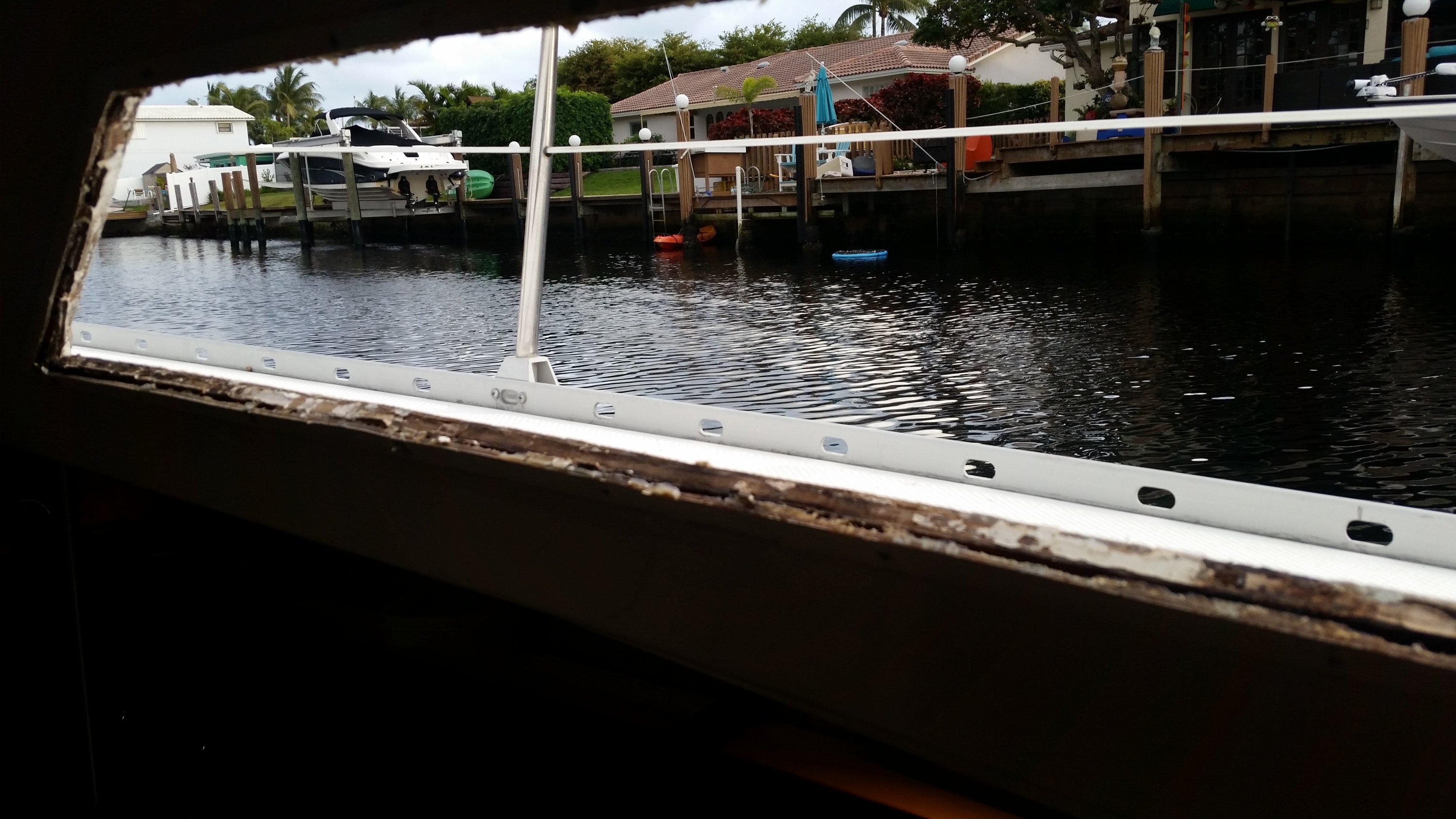

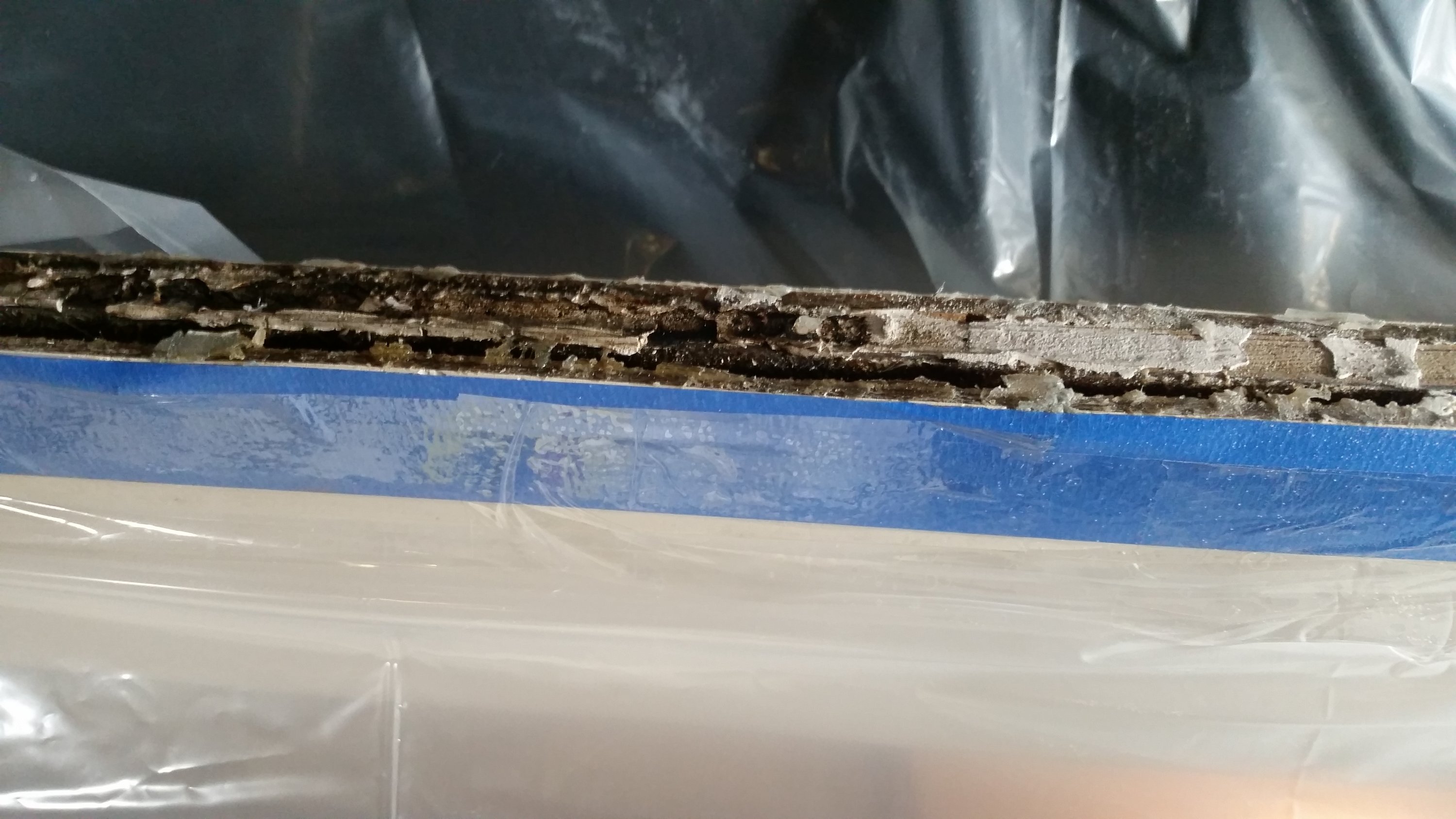

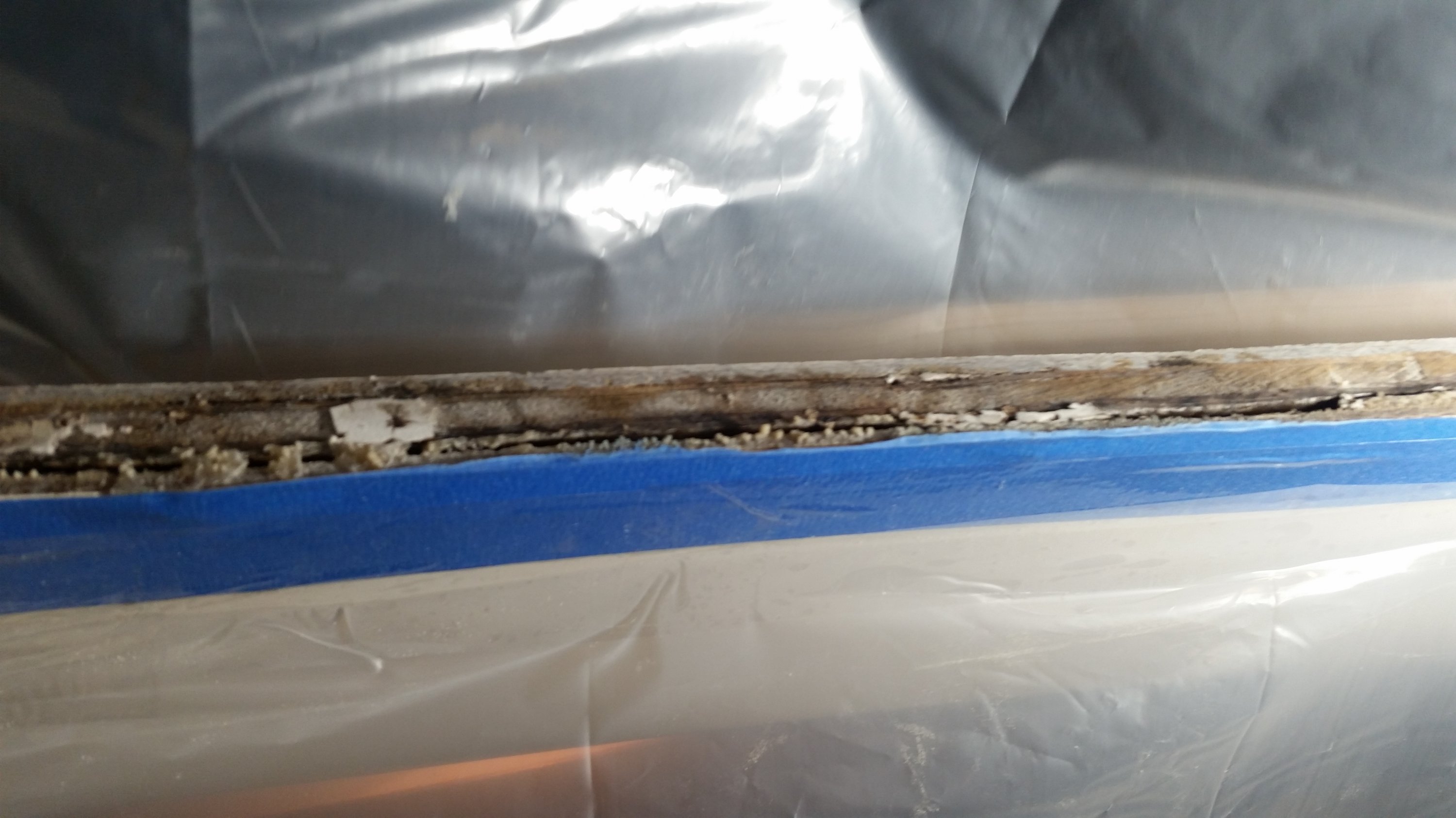

Right after I removed the outside of the port, I tried to scrape off some of the biggest chunks of old sealant with a razor scraper. But then, in full compliance with Murphy's Law, it started to rain and I had to cover up with plastic sheeting.
Today I went back to try to get the remainder of the sealant off and to get the opening cleaned up. There is clear Silicone, Gray Silicone, and some kind of white sealer that reminds me of bathroom caulk

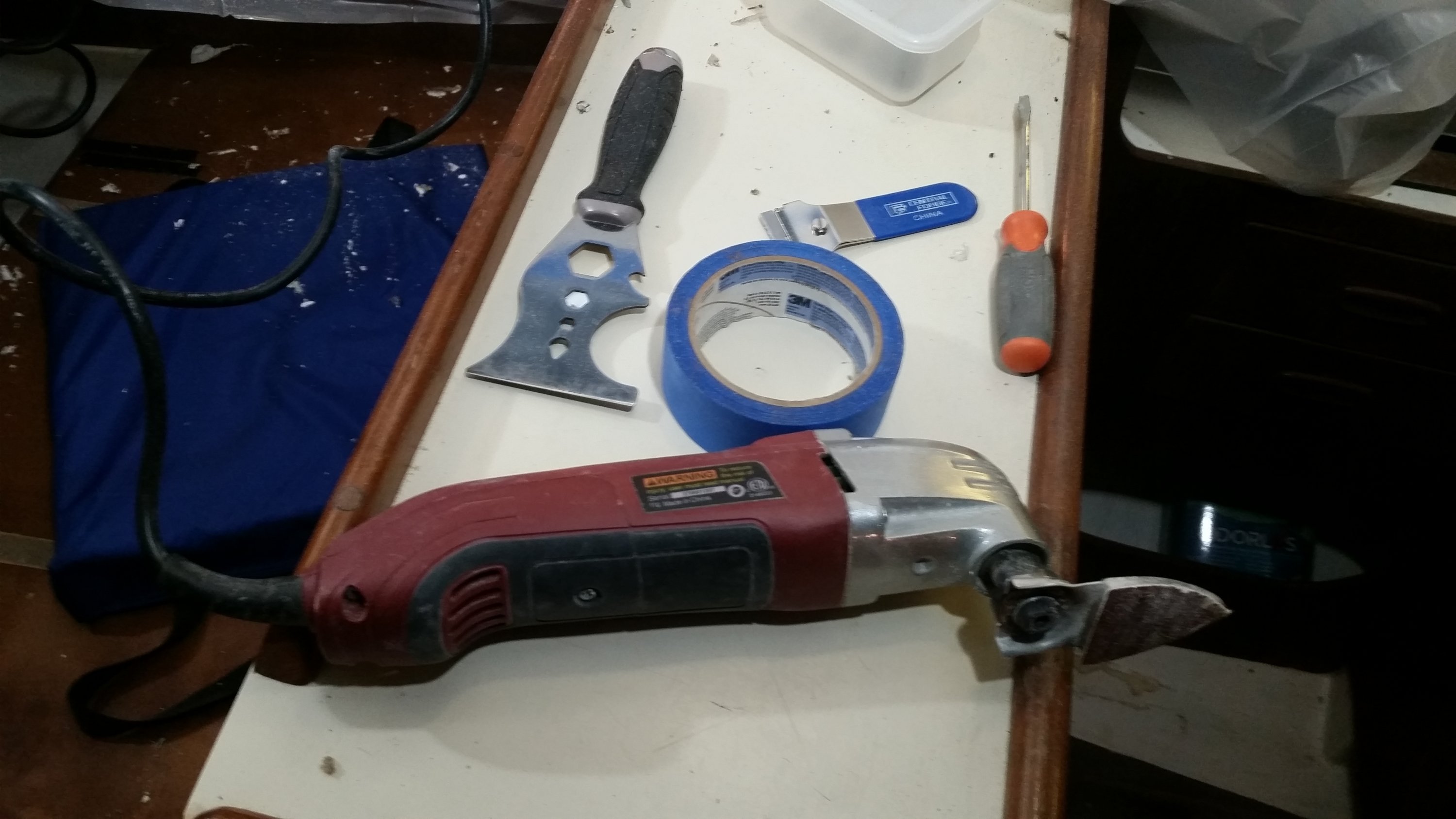

I used a razor scraper and got as much of it off as I could easily.
And then I used my Harbor Freight Fein tool with 80 Grit sanding pads to get the rest off

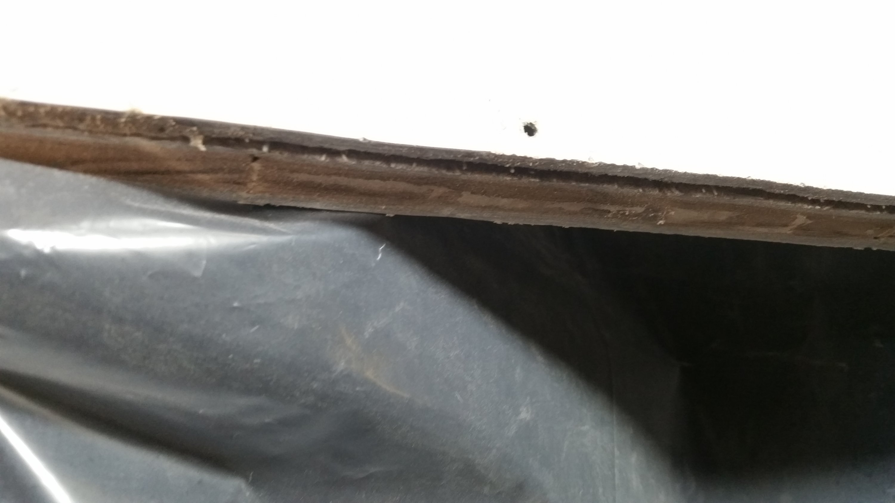

Now before I move forward, I need to reattach the inner skin to the plywood core, but I have a question. The space between the core and the inner skin was gooped with lots of old Silicone sealant. I have tried to remove as much as I can but there is no way I will be able to get it all out. If I use epoxy with clamps to squeeze this back together, do you think the epoxy will hold satisfactorily, or will the silicone make this futile?

I had some good luck with a silicone remover I got from Lowes or Home Depot. Your plywood looks pretty good but I would sure double check for any rot in the plywood all around. I would sure give the epoxy a try. WM has a putty type epoxy that might be helpful in this application. I would also use a shop vac to suck out anything you can befor you epoxy. http://www.westmarine.com/buy/west-marine--epoxy-stick--3761483
Likes: pateco
Jul 1, 2014
262
Hunter 34 Seattle
I think a rule of thumb is nothing will stick to old silicone. My openings were the same - it looked like someone went in and filled the plywood delamination with silicone. Ugh. The silicone really doesn't stick very well to the plywood or fiberglass so I dug out everything I could get with various tools and a shop vacuum until I thought I had 95% removed then filled with epoxy and clamped. Good luck.

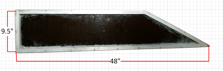

OK I have another question. I got a quote of $260 to media blast prime and powder coat the frames with marine powder coating. Would you do that, or strip the old paint (most of it is already off of the exterior frames), sand, buff, and polish the bare aluminum. Any other Suggestions are also appreciated.
Jul 1, 2014
262
Hunter 34 Seattle
I'd be curious to hear others response but I also thought about options. I looked at cleaning up and leaving raw aluminum but was concerned it might not weather too well in the marine environment. I also looked into powder coating and even anodizing but in the end decided to paint as the easiest solution. You need to use a special primer for aluminum.
I think powder coating would be great, I really just didn't want to spend the extra money. That probably shouldn't have been the biggest consideration given the amount of time it took to do the project but there are so many other things my boat wants me to spend money on....
