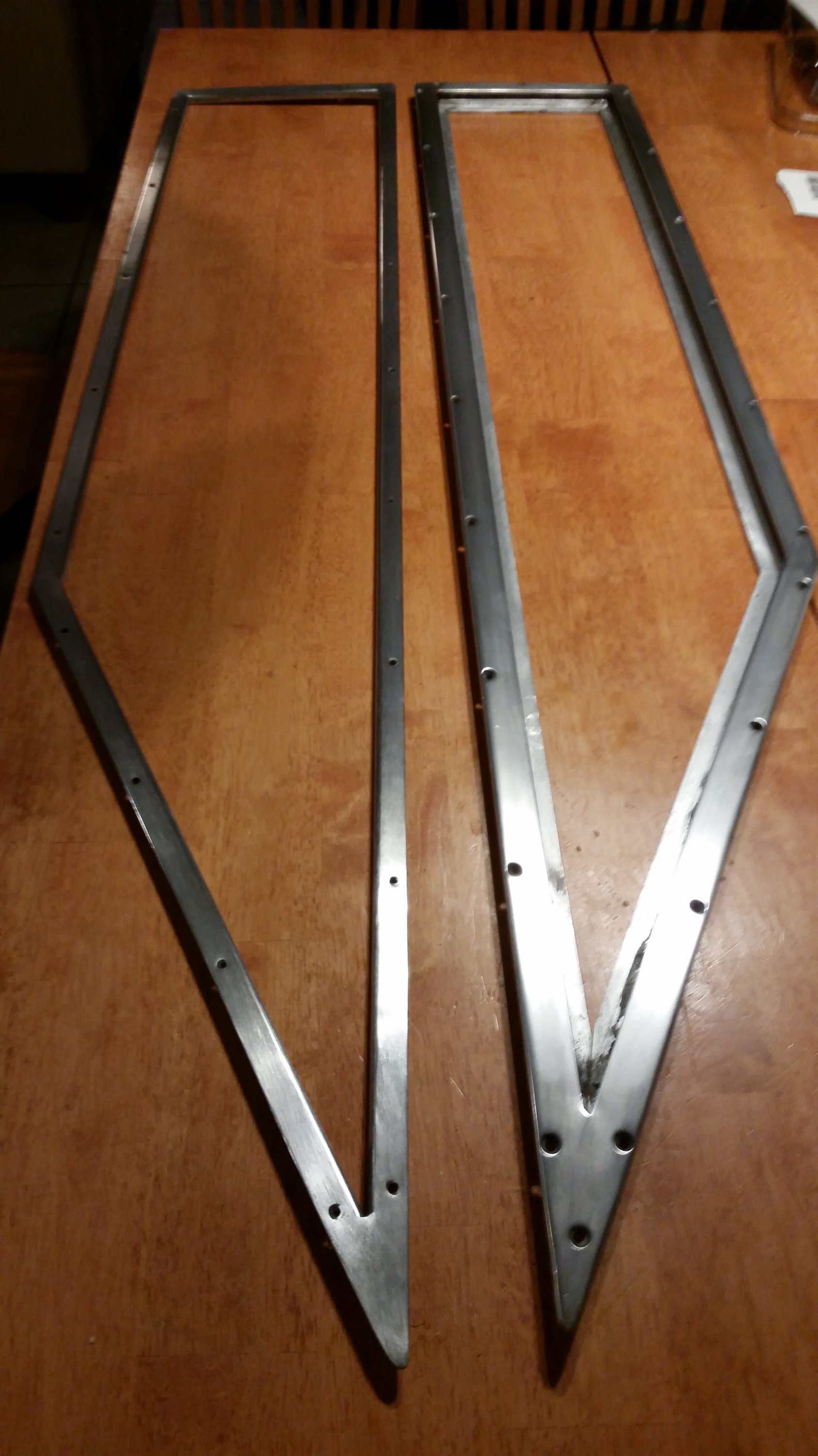

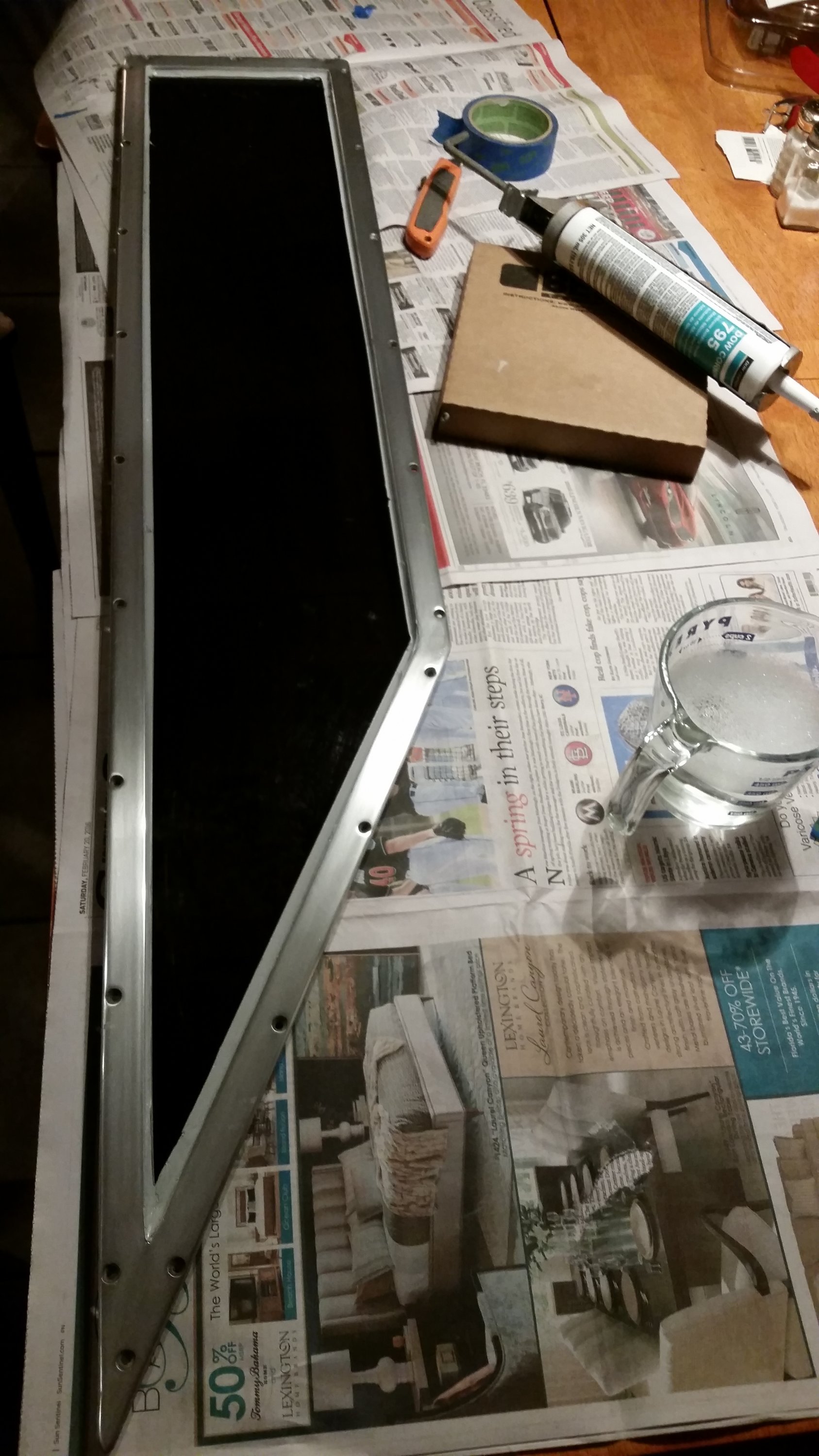

I must be doing something right My son helped to strip and polish the port frames
They turned out pretty nice.

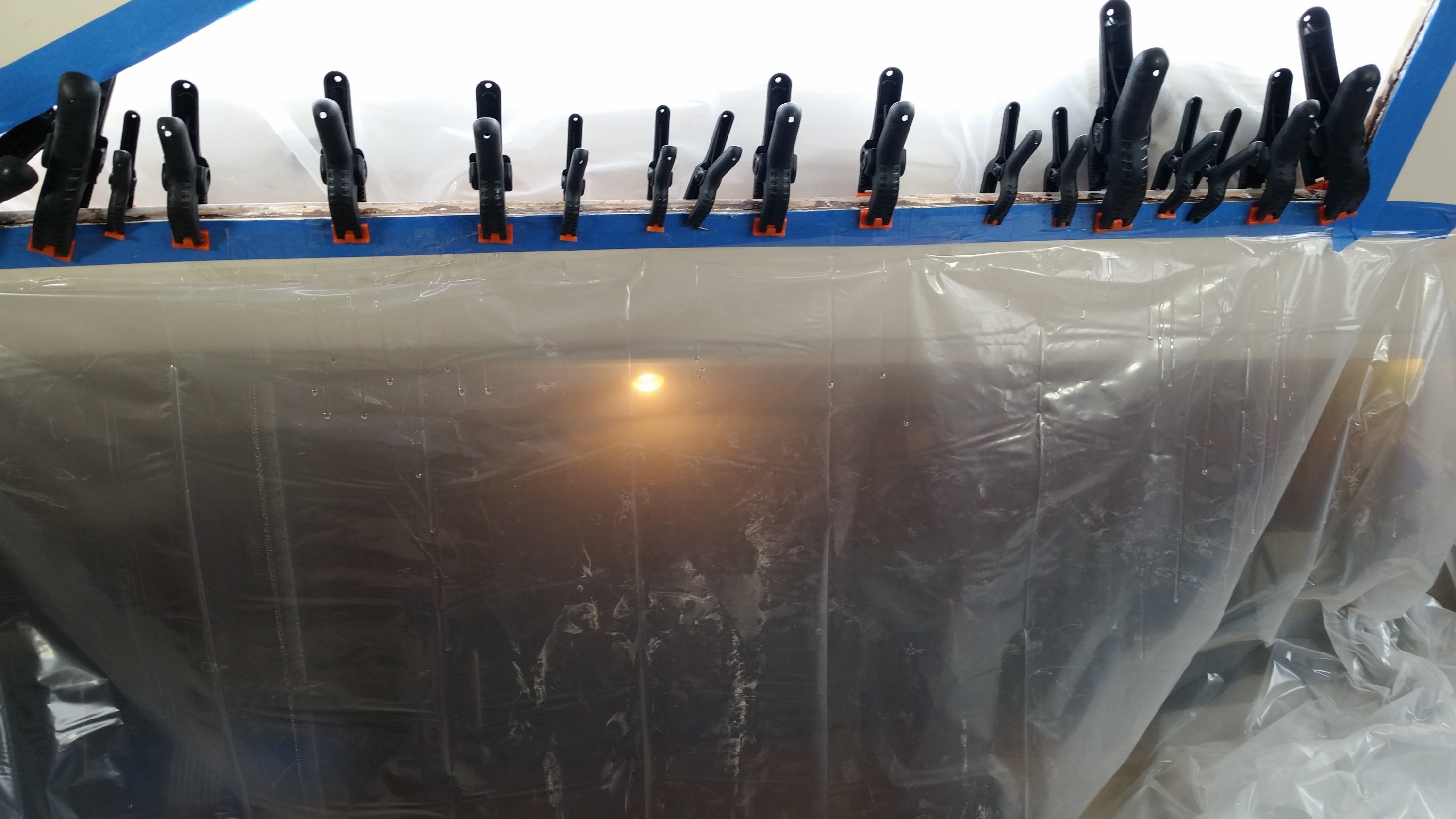

I epoxied and clamped the port opening.

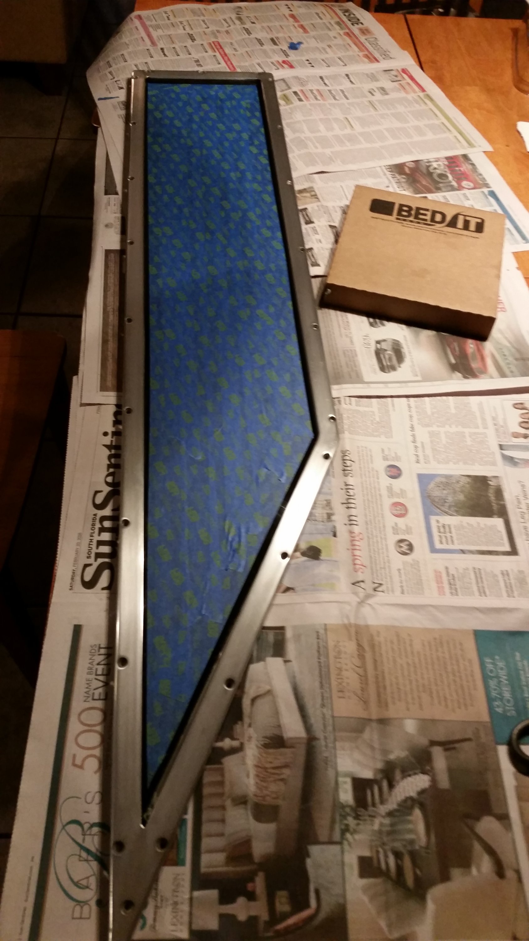

I bed the lens in Butyl tape, and masked it off before sealing with gray Dow 795 sealant.
Port lens bedded and sealed.

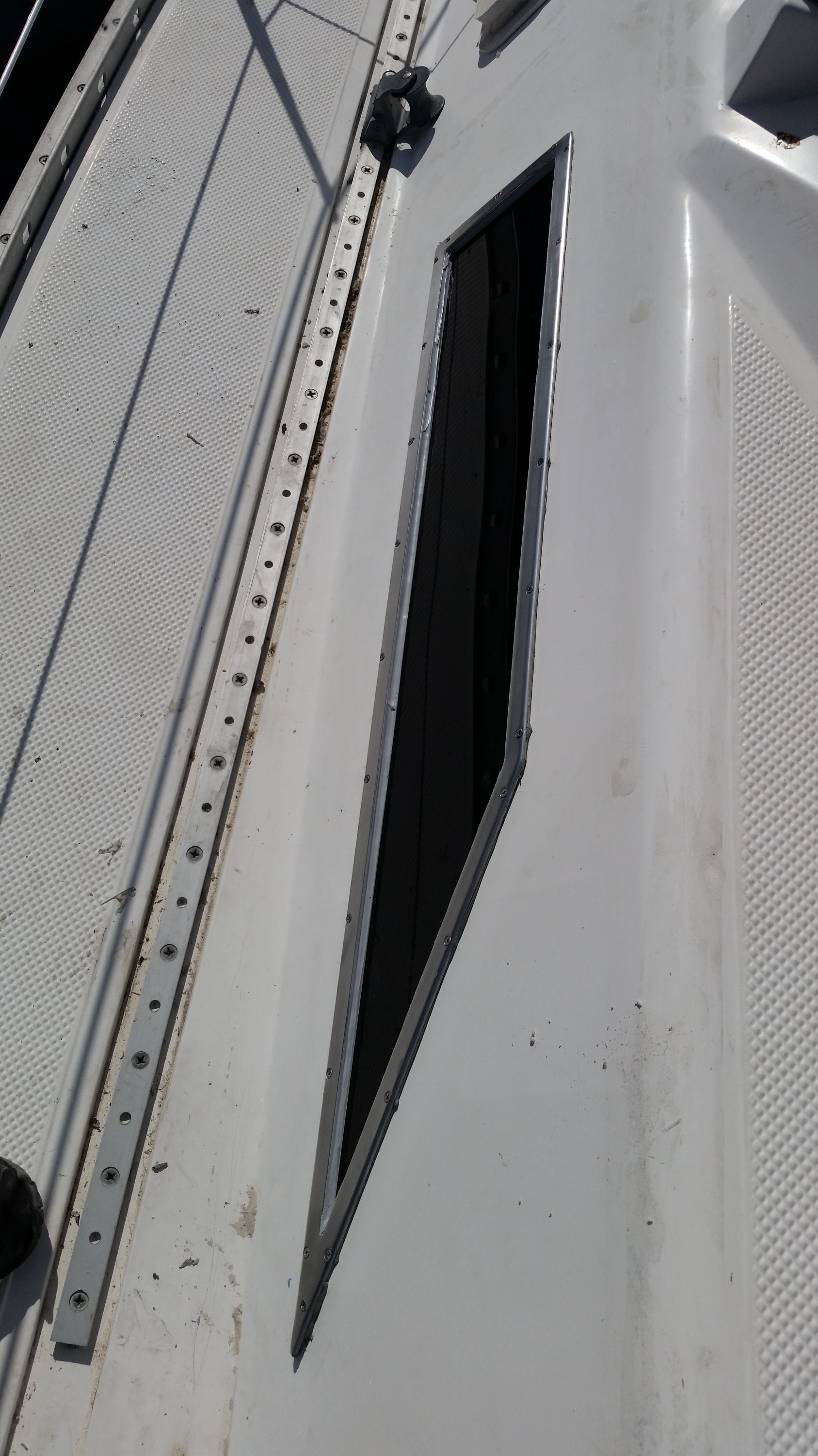

Starboard port reinstalled with more butyl tape.
Now I am working on the port side.

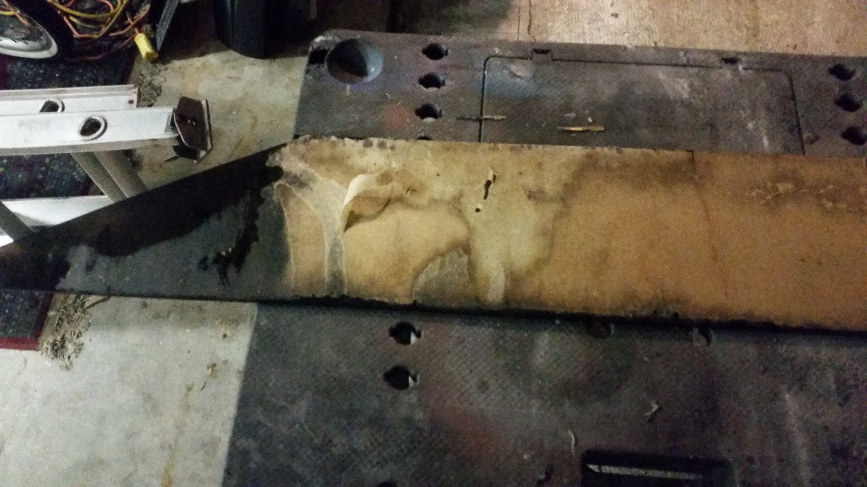

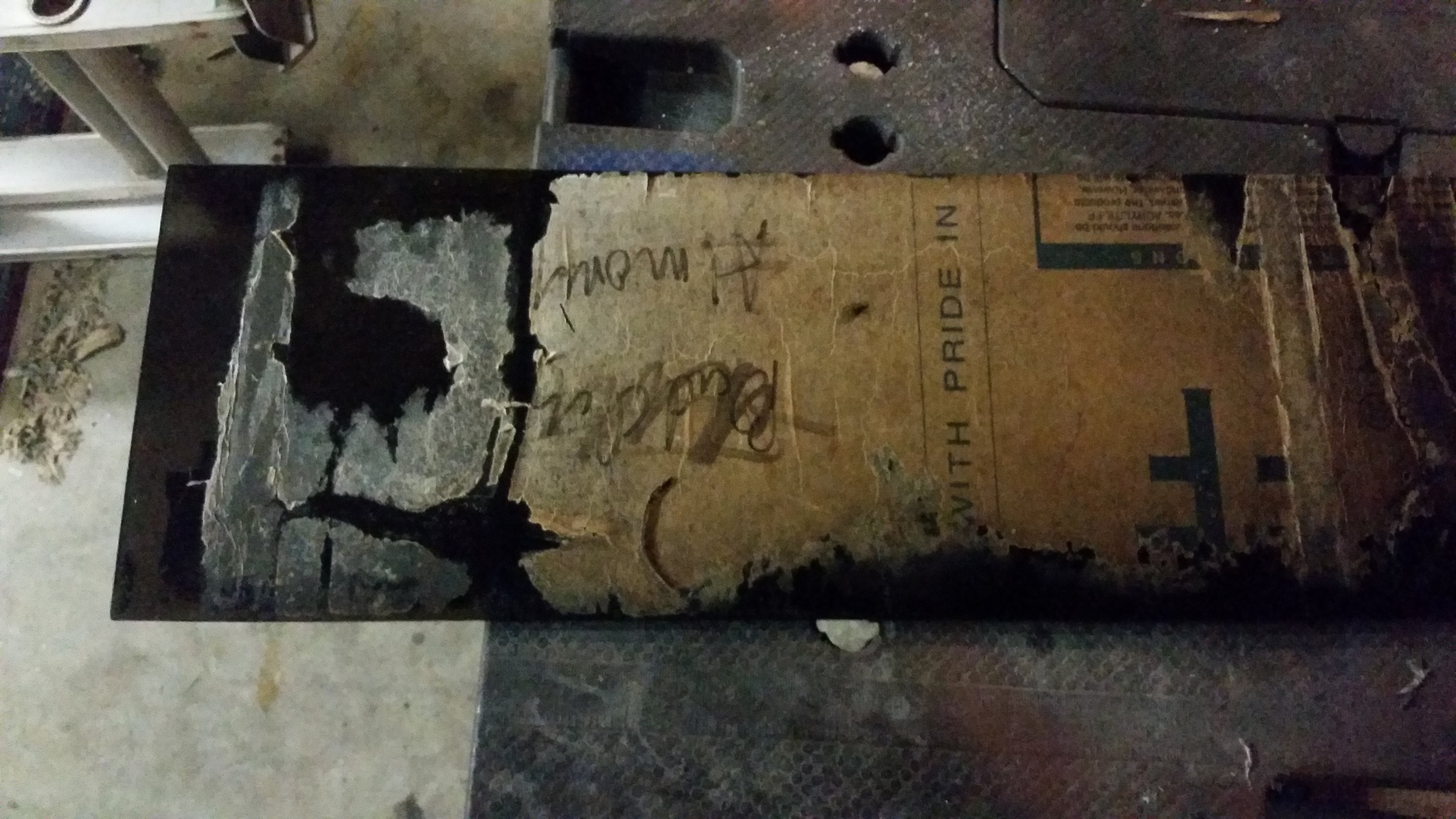

Port side lens was cracked, so, as part of the refurbishment, I am replacing it. PO had a replacement stored in the lazarette, but it has been there so long that the protective paper film on the plastic is hard and brittle. Anyone no of a good way to get this paper off without scratching the lens?
pateco
Aug 12, 2014
2,207
maybe try goo gone, might help
I was told goo gone could haze the acrylic. I used WD40 along with a heat gun and plastic razor scraper to some effect last night, but still have more to do. This is some stubborn stuff.
pateco
Aug 12, 2014
2,207
I would love to use this stuff as it is magic at removing silicone sealant and vinyl striping, but it says right on the warning label not to use on acrylic.
Jul 1, 2014
252
Hunter 34 Seattle
I think your only hope is water to soften then scraping with your plastic razor. Leave it overnight with a wet towel to soften as much as possible then see if it works better. The glue residue will still be difficult I think.
I know it's sad but if you count your labor it might be cheaper to buy a new one.
