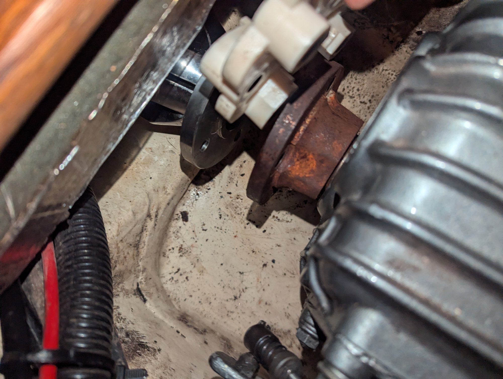

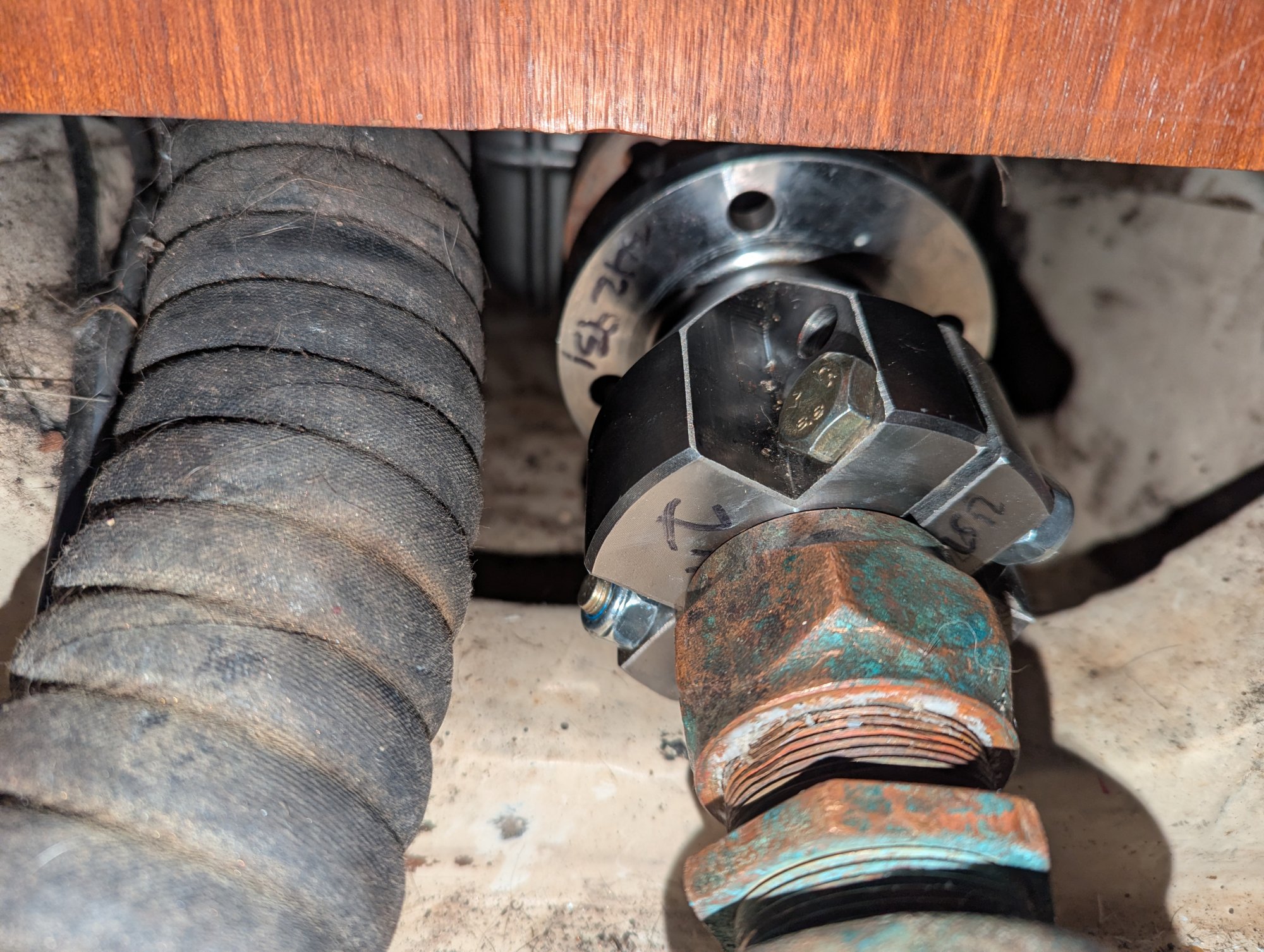

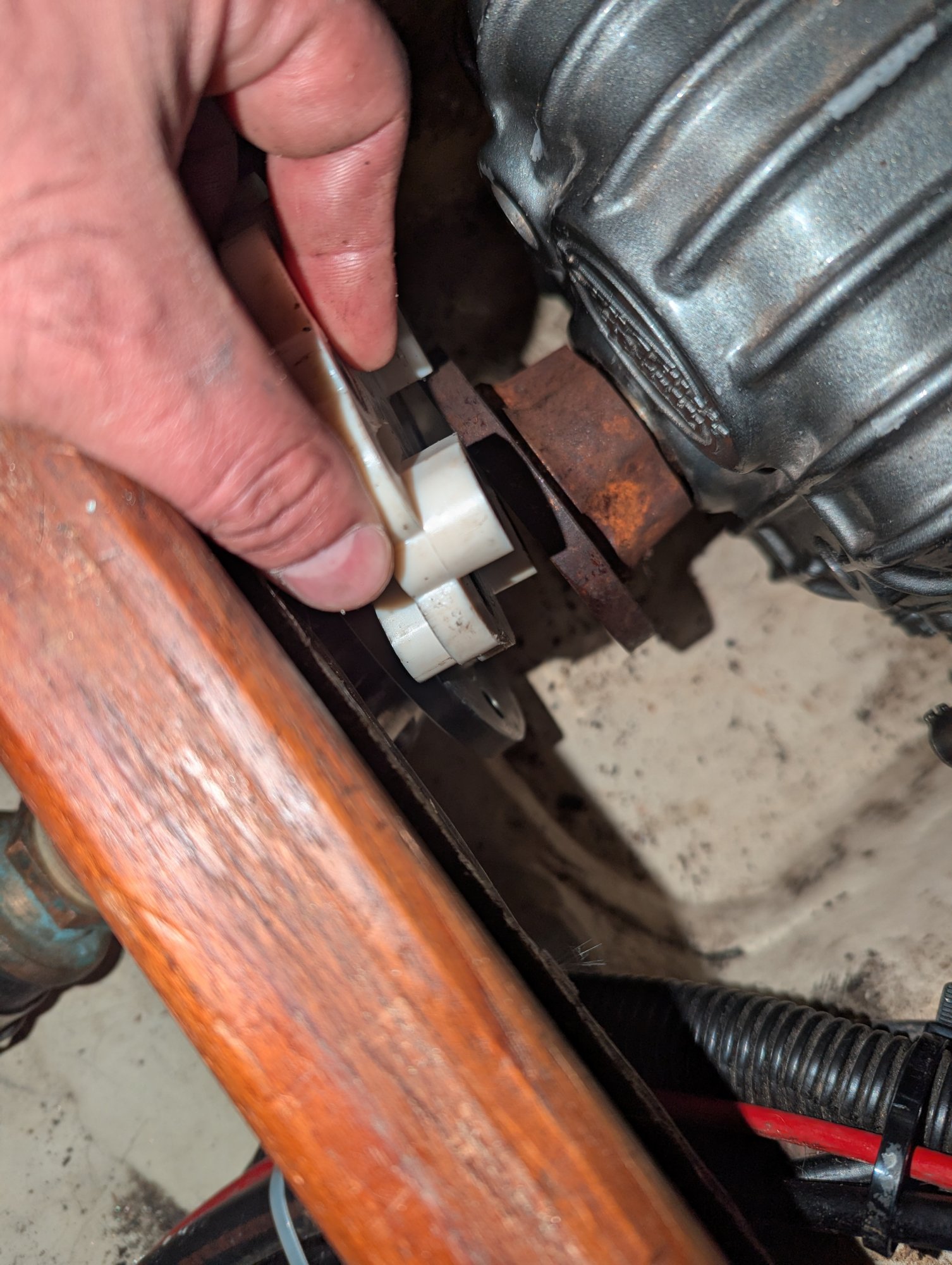

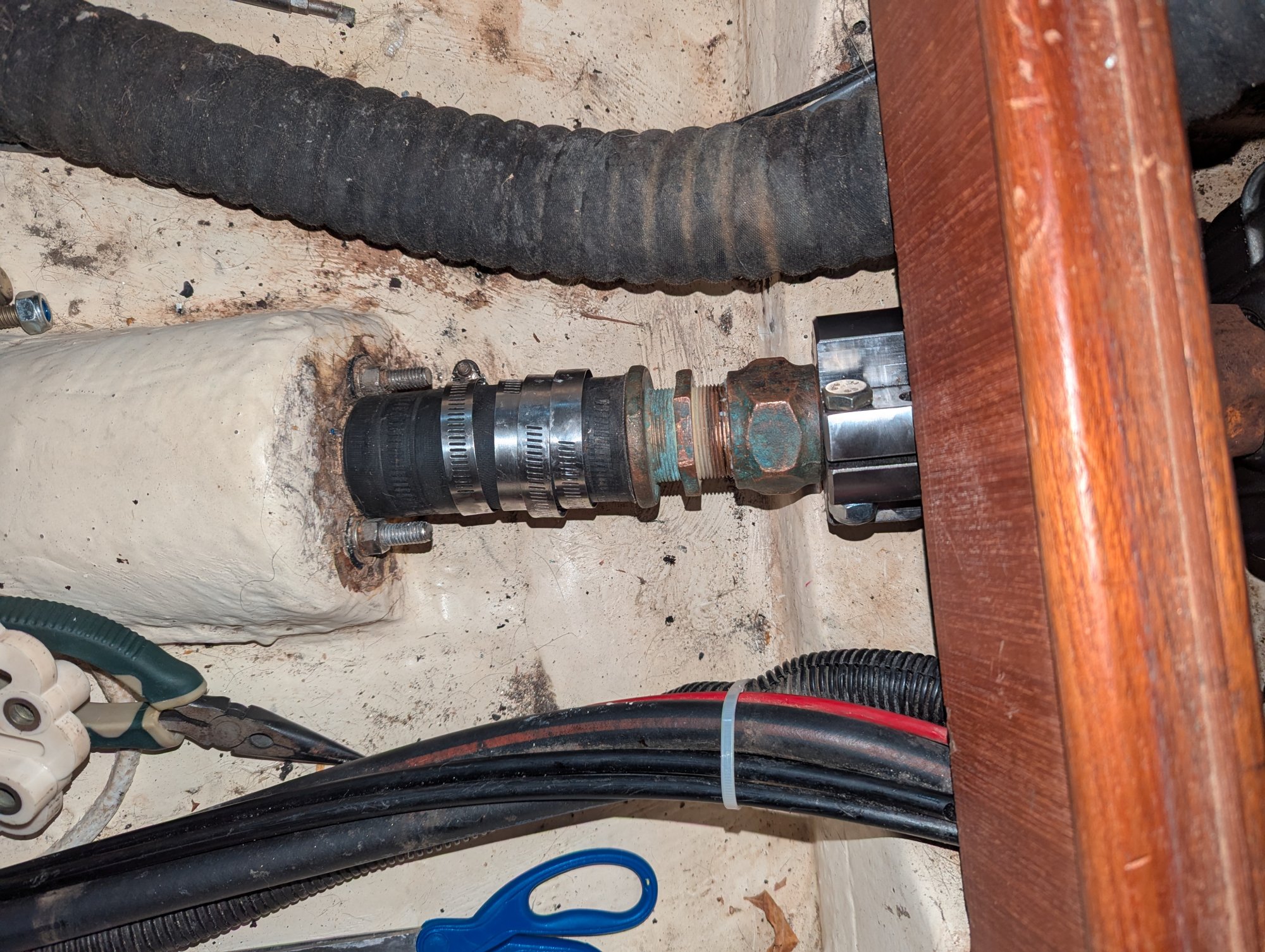

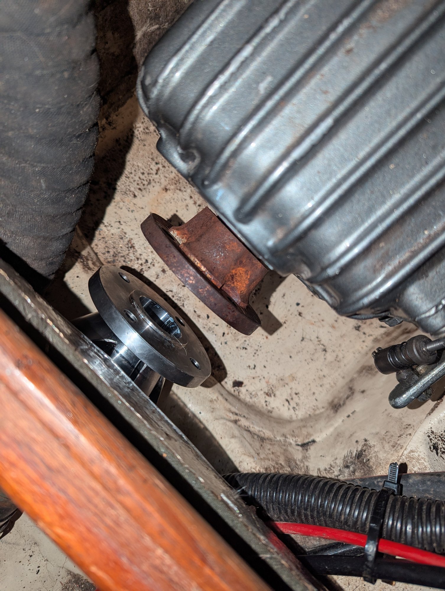

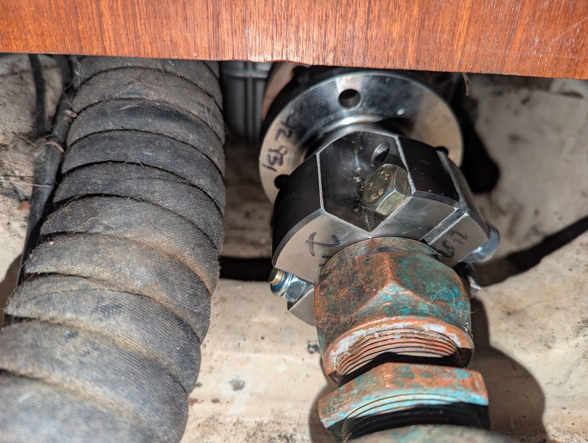

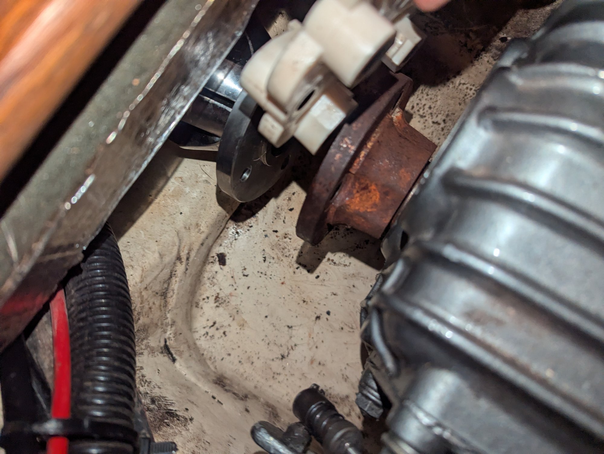

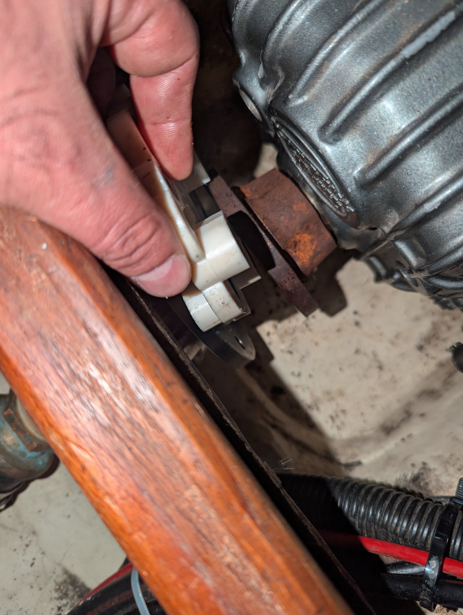

Hi all,
I measured and determined a split coupler would fit on my Hunter 376. Today I attempted an install but ran into a bit of an issue -- the coupler fits, but I'm unable to wiggle the bolts in between the shaft coupling and the transmission flange.
I considered removing the shaft coupling, pulling back the shaft, installing to the transmission flange, then reconnecting everything but given the space this would mean that I would not have room to back off and access the packing nut should I have a leak/need to replace the packing (that is, with out having to pull the prop shaft from the shaft coupler, which would be difficult when in the water).
I will try shorter bolts, but I'm not sure that there is enough room even for those (while still leaving enough room to properly thread the nut). There is also not enough room to feed in the bolts from the transmission side.
I'm wondering if others have run into this and if there is a "trick" or procedure that I'm not considering to make this work. Or, maybe I'm just out of luck (but I'm hoping to find a way to make this work).
I've included some pictures for reference, in case that's helpful.
Thanks!
Doug

Is the white part a damper plate? If so , will it work without it?
It appears that you could shorten the hose by 1" and not suffer any consequences.

The white part is the flexible coupling I'm trying to add. My original setup did not include it, but they are supposed to run quieter and reduce wear and tear on the Cutlass bearing, as well as reduce chances of damage if the prop is fouled.
I'll have to measure and see how much extra space is available between the hose barba there. I might be able to gain .5+ inches.

The split coupling from PYI is heavy duty and a bit longer than split couplers from Buck-Algonquin and other companies. That and the addition of the flexible coupler exceed the space available. This will make it difficult to adjust the stuffing box as you have learned.
To solve the bolt issue, insert the bolt from coupling side with the nuts between the transmission flange and the transmission.

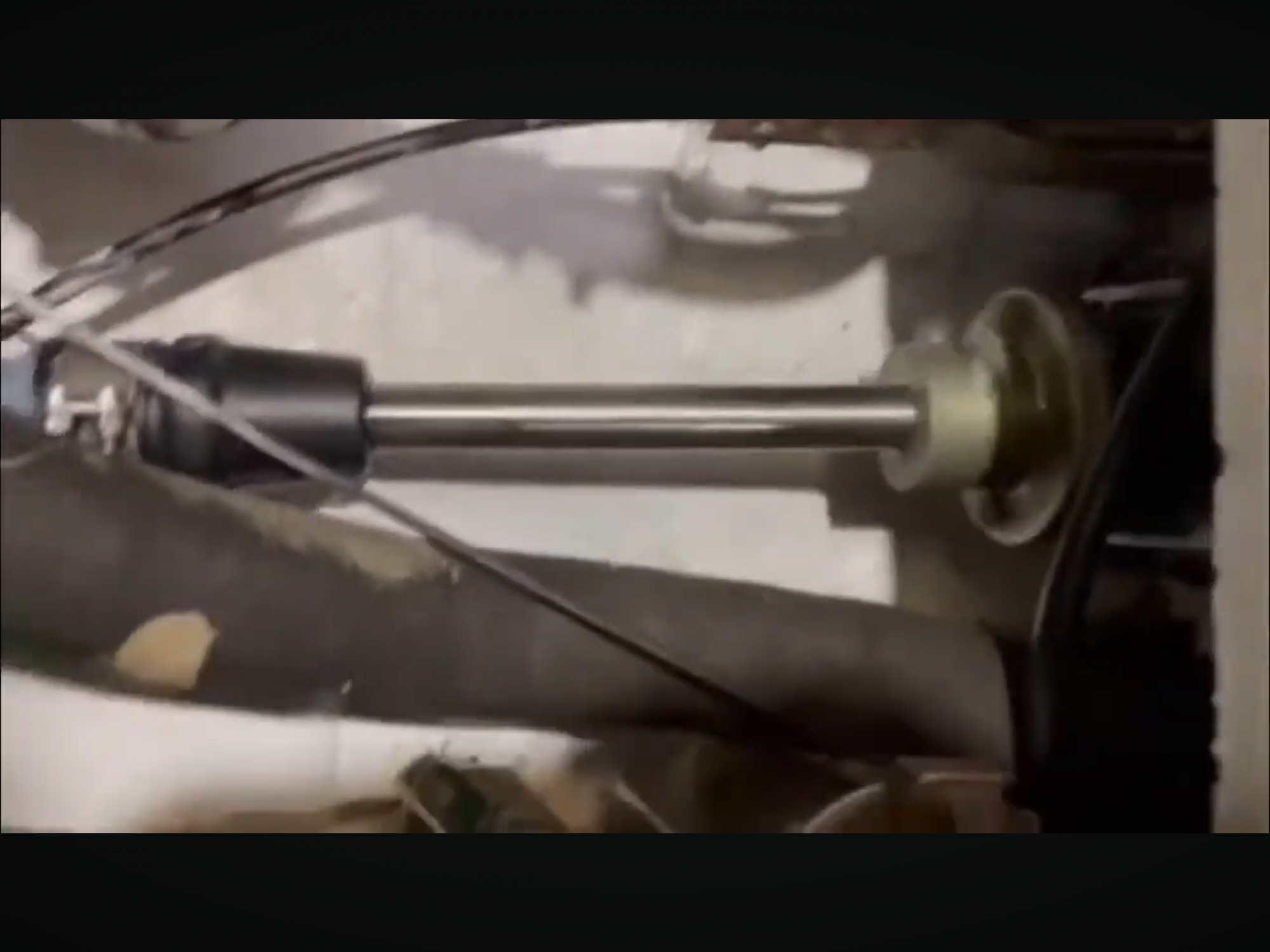

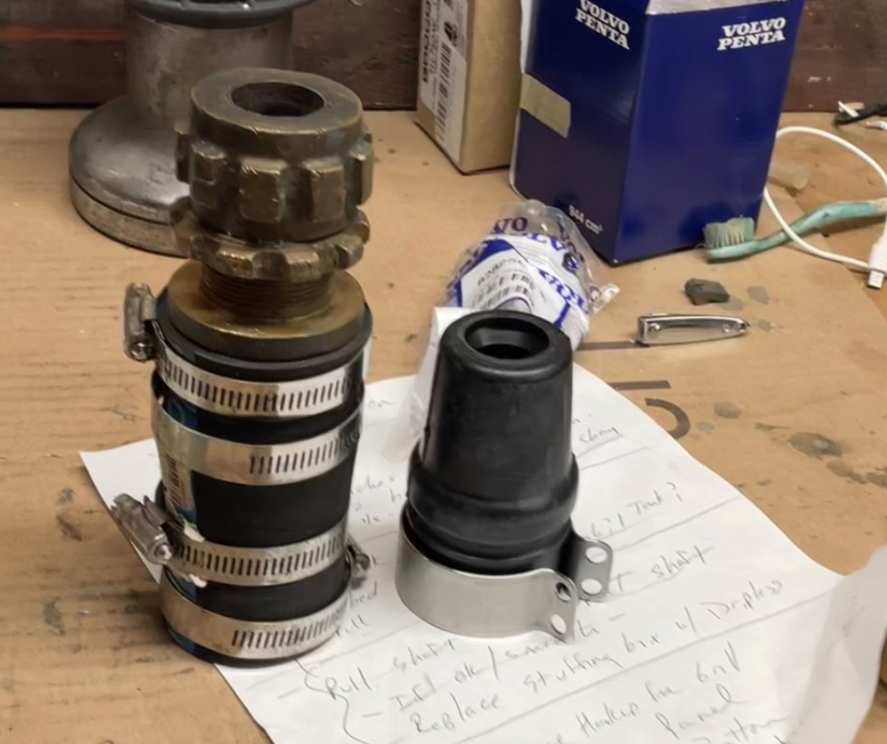

I replaced my original stuffing box with a Volvo dripless seal. I did it because I wanted a dry bilge, but in your case, it would provide you with a significant amount of space…
And you would have an added benefit of a nice dry bilge!

I replaced my original stuffing box with a Volvo dripless seal. And you would have an added benefit of a nice dry bilge!
:plus: That picture says it all!
Doug, The Volvo or Radice seal would solve your problem inexpensively, only $140.
with relatively simple installation.

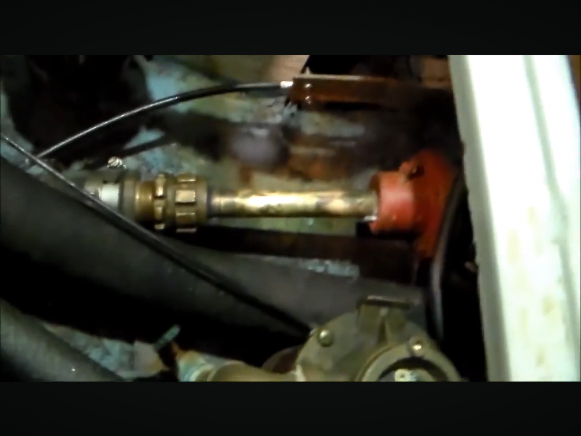

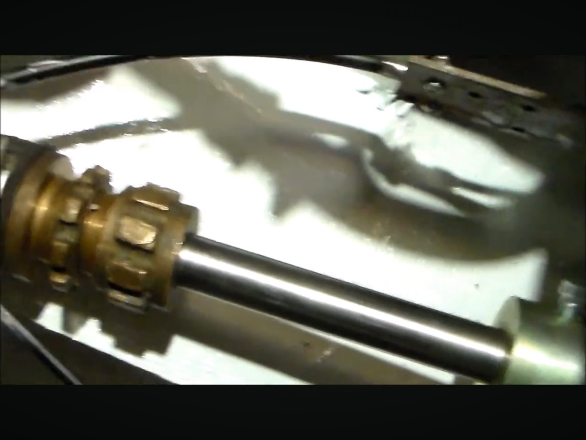

these photos show the progression of my journey…
original shaft & stuffing box. Then new shaft and painted bilge, but old stuffing box, and finally, with Volvo shaft seal.

Hard to find it, but the thru hull handle for the engine and head intakes are down there, so really easy to give the seal a squeeze before heading out.

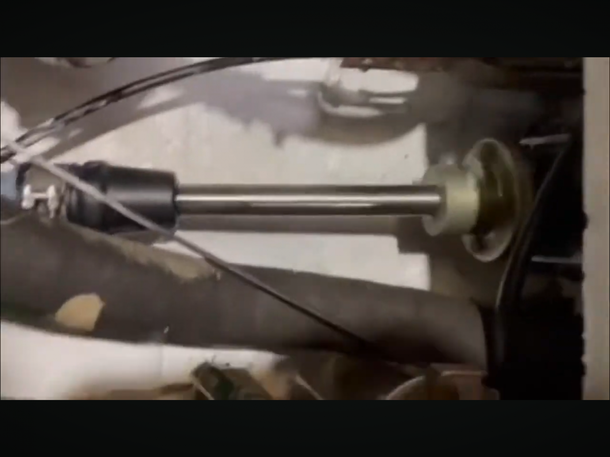

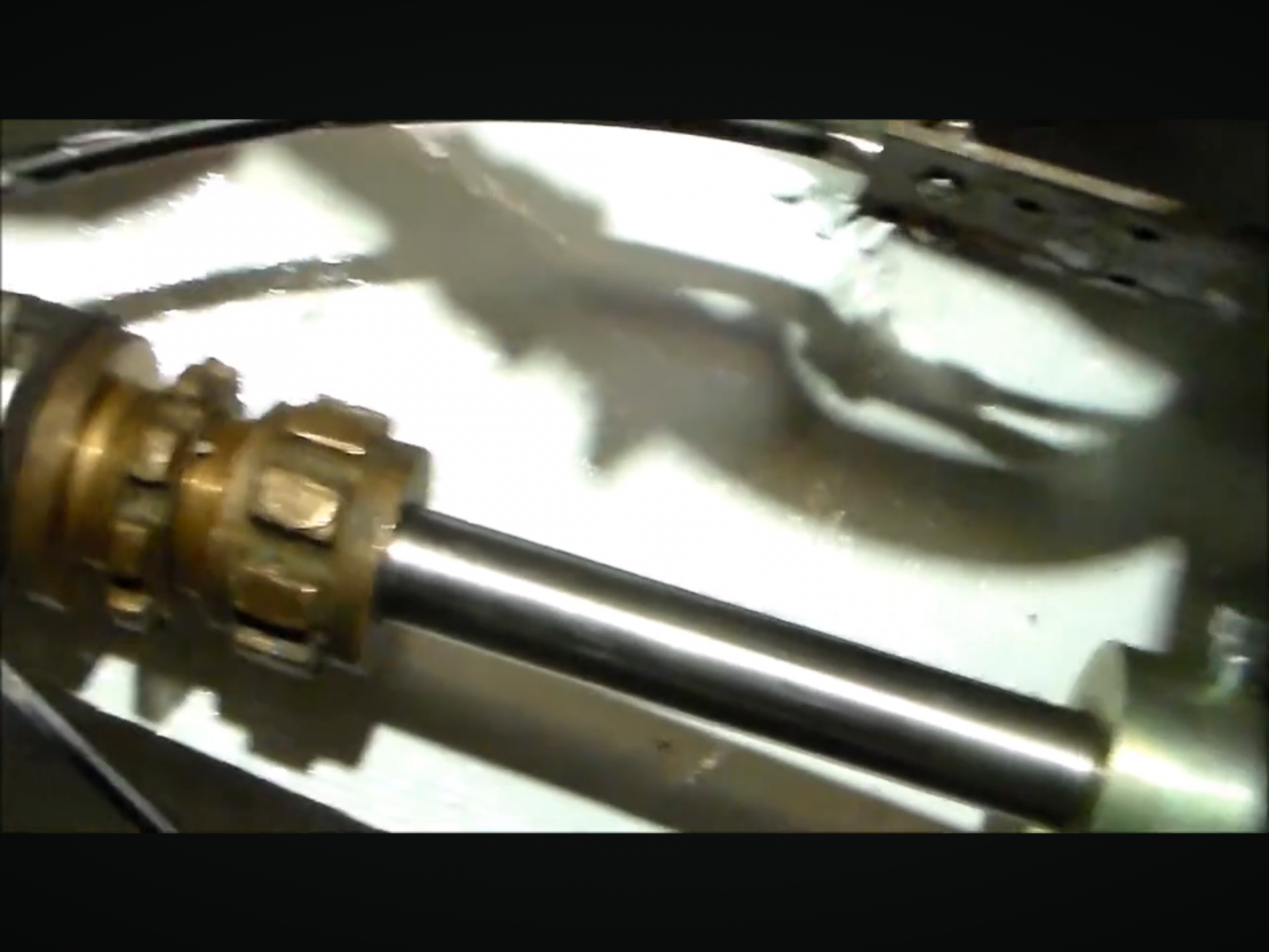

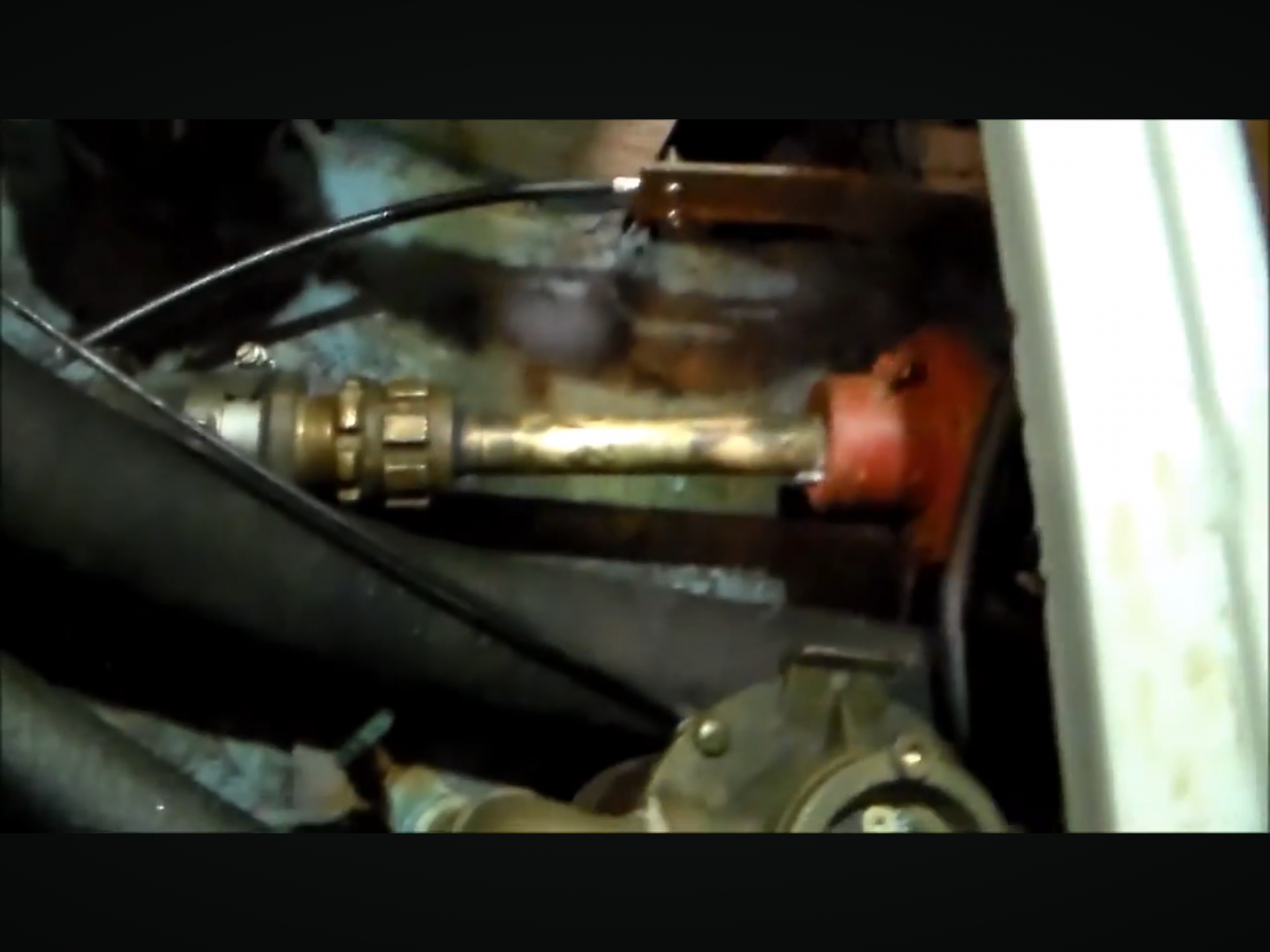

I went through my own saga of a broken injection nipple the first half of this year (Thanks @BigEasy ). I have a non-Beneteau replacement that seems to be working well, and replaced the Volvo seal while we were at it (though next time I'm definitely looking at the Radice).
However, the dripless seal isn't especially dripless and I'm wondering what other's experience is? It definitely drips at forward/reverse idle, but the engine is a bit jumpy at these RPMs and so there's a fair amount of driveshaft movement. (Working on that.) But this is a video at ~2500 RPM and you can see some water is thrown. It doesn't leak at all at rest. (Mud dauber carcass at no extra charge.)
Do others have this behavior?
2500 RPM.mp4

See @Shorinsean video for the location of the nipple & shaft log location; my set up is exactly as depicted in his video.
It's debatable, in my opinion, if a nipple is needed at all. Afterall, there is water that enters the shaft log & Volvo seal by way of the internal shaft tube & cutlass bearing. The only time that I vent or burp the seal is immediately after launch following a haulout. I fail to see how air would be introduced into the system, except when the boat is out of the water. I don't think it's a good idea to drill into the Volvo seal.
