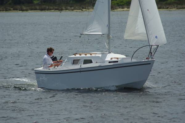

Ohh i doubt that. If you get anywhere close to 90, that huge bathtub of a cockpit will fill up and you're in real trouble. The few sinkings I know of happened like that. He's my buddy Glen getting about as close as he finds comfortable, maybe 45. Like I said, fun boat.

WOW!.... that IS a BIG cockpit for such a small boat. It does look fun. Looks like Glen could use some rail meat.
Large cockpit, and the boom is high enough that even I don't have to duck when tacking (I'm ~6'1").
I suspect Glen was intentionally trying to heel the boat like that (photo op? ;) ) I haven't gotten quite that brave with mine, but I've intentionally pushed it over 25*+ just to see how how the boat liked it..... Tweety just shrugged it off and was wondering when I was going to start really heeling her over ;)
