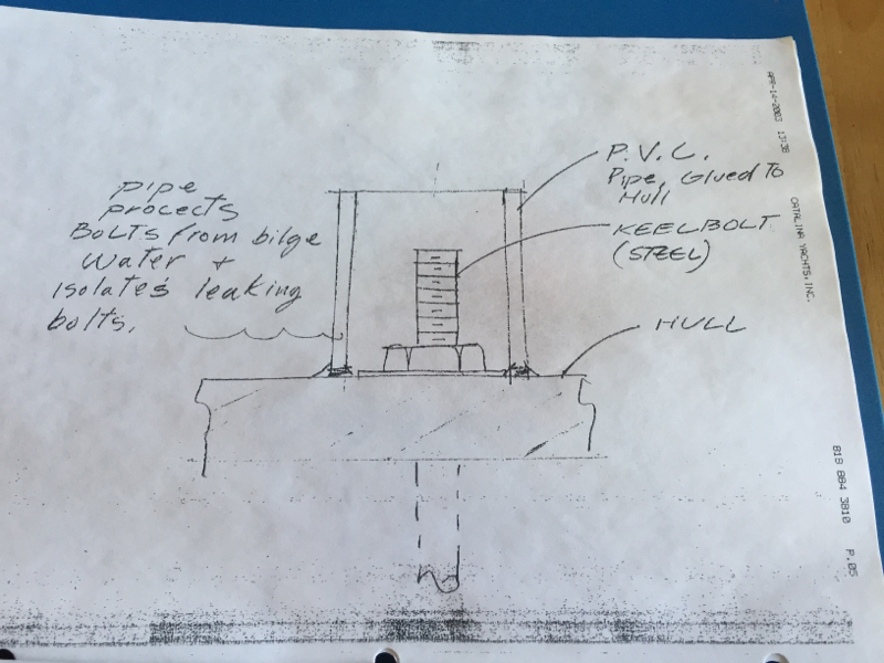

So, what I know for sure.. The keel bolts are leaking a little. Well, more than a little but not a lot. This is what my bilge looks like
Judging from paperwork I found, the PO decided to do this modification
So I sucked all the PVC pipes out with the shop vac this morning before all the cleaning and outside work and when I was ready to leave I looked back in the bilge and found some of the pipes were empty but others had water in them and there was about 1/2 inch of water in the bottom of the bilge. So, next week I will take the torgue wrench and nut and tighten them down..

bolts may not be leaking
Check a few things first. The pipes around the bolts could be leaking around where they are 'sealed' to the bottom of the bilge. Properly sealed, the pipes will fill first and overflow into the rest of the bilge. Since you say some had water in the pipes and other didn't I think maybe the water is leaking under the seal and into the pipes.
I have a Cat 27 as well. Do you have an inboard? The shaft seal will leak a little, and should. Do you have an Icebox and with ice in it. It will melt and drains into the bilge.
I would suggest drying the insides of the pipes(shop vac good idea) and dry the bilge out and well. Pour water into the pipes and see if they leak into the bilge. If they do, reseal. See if the bolts fill first. If so they are leaking. Tightening is not the answer. Do and search and see how to fix this. There is a lot of documentation. It will have to be on the hard to do it. In the meantime go sailing. There isn't that much left of the season. Just make sure your auto bilge pump is working properly.

Love the idea of the pvc tubes keeping the bolts dry. Not likely that they are leaking that much. Was there a big crack of the keel stub on the hard. Definitely torque them next time you have her on the hard.
Jul 22, 2015
56
Catalina 27 MO
thanks. yes, there was a catalina smile on the keel, not too bad, but you could see it for sure.
you mentioned torquing them next time on the hard. can i not just torque them through the bilgue while the boat is in the water?
Sep 23, 2009
1,477
On the hard they are under compression and not tension. I think that would make it easier. There may be other reasons.
