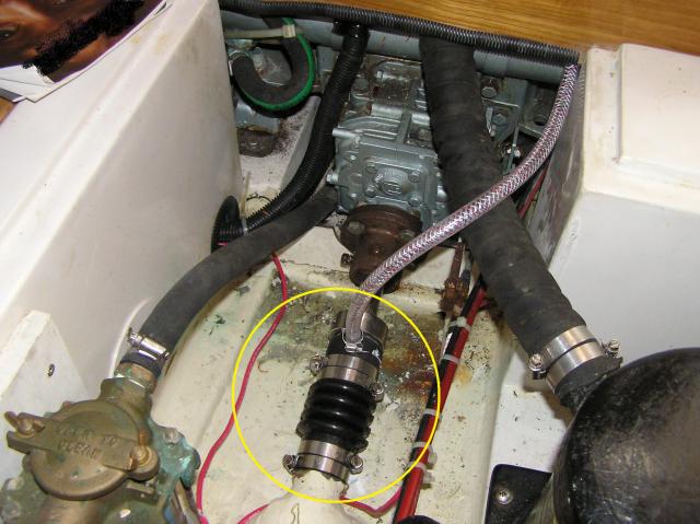

What is in the ziploc bag?

Paul, What is in the ziploc bag?
Paul, We are curious as to what you are up to with the ziploc bac. Please make it sound interesting, things are slow here on the East/Right Coast.

All the spare parts to repair the PSS if this system fails.

Paul,
Now I'm really confused...seems like a replacement bellows would also be a spare part for the PSS (but how would you change it?)...all I need for my old school stuffing box is a piece of flax (or a rag in a pinch). In the picture it looks all you have is a 90 degree thimagee?? What are considered in the water spares for the PSS, and what is the plan in the event of a bellows failure?

Well if you and I were out sailing on the water, a nice summer day, here in Anacortes area with me at the helm and you discovered a salt water leak below, I woud tell you to fix the leak.
And of course you being a reasonable sailor would say" where is your repair leak kit".....my reply "everything you need to fix any kind of leak on this boat is in a red bag in the port lazarette ."......
Then you said and then I said.....still confused?
I'm sure if you had a leak in the hose to your stuffing box you would do the right thing based on sailing conditions, etc, etc, etc
My bottom line is crew and passengers come first....everybody in the dinghy.
http://www.shaftseal.com/en/about/shaftseal_maintenance_kit
paulj :troll:

Truckman, there is always duct tape (I bet Paul keeps a roll in the red bag in the port lazerette)
Seriously Paul, the ziploc bag looks like it only has the single black&white 90 degree Caterpillar looking thingamagigee. What type of spare is it and how is it used?
