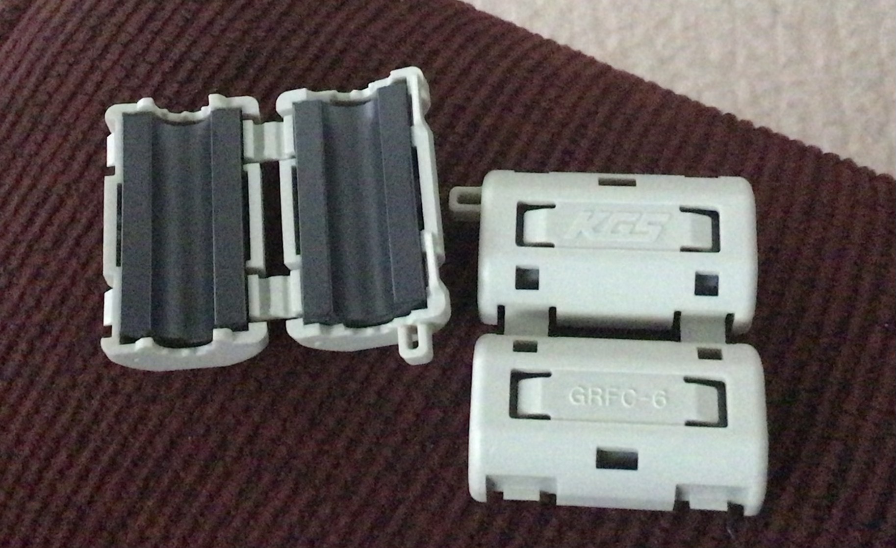

My new Standard Horizon RAM4 Mic has 2 Ferrite Cores included in the box. They need to be fastened to the cable on both ends of the cable as close to the screw connectors as possible. The instructions say to wrap each with electrical tape to keep them from falling off, as vibration may loosen them. Given where they are finally located , how would you know?

As Don described, I wanted to loop the cable through the core twice and pull the ends, which would hold it in place. But the core only allows a single pass through of the cable. I’ll heat shrink them to keep them in place. One thing for sure is these areas are not places you look at after the install. They are pretty much tucked away for the duration.
