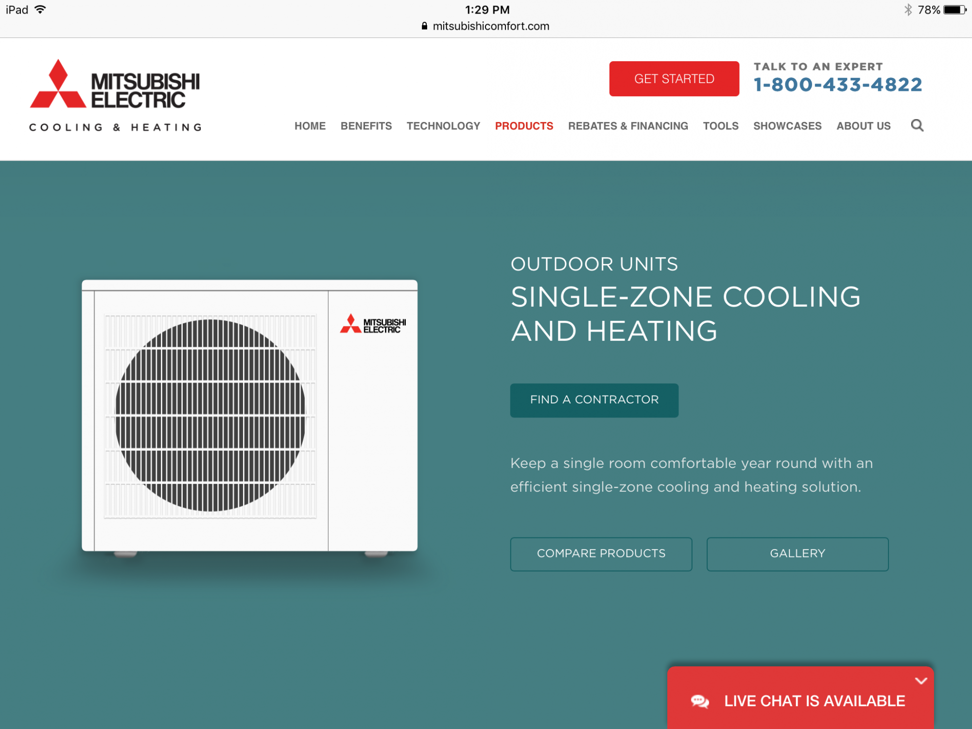

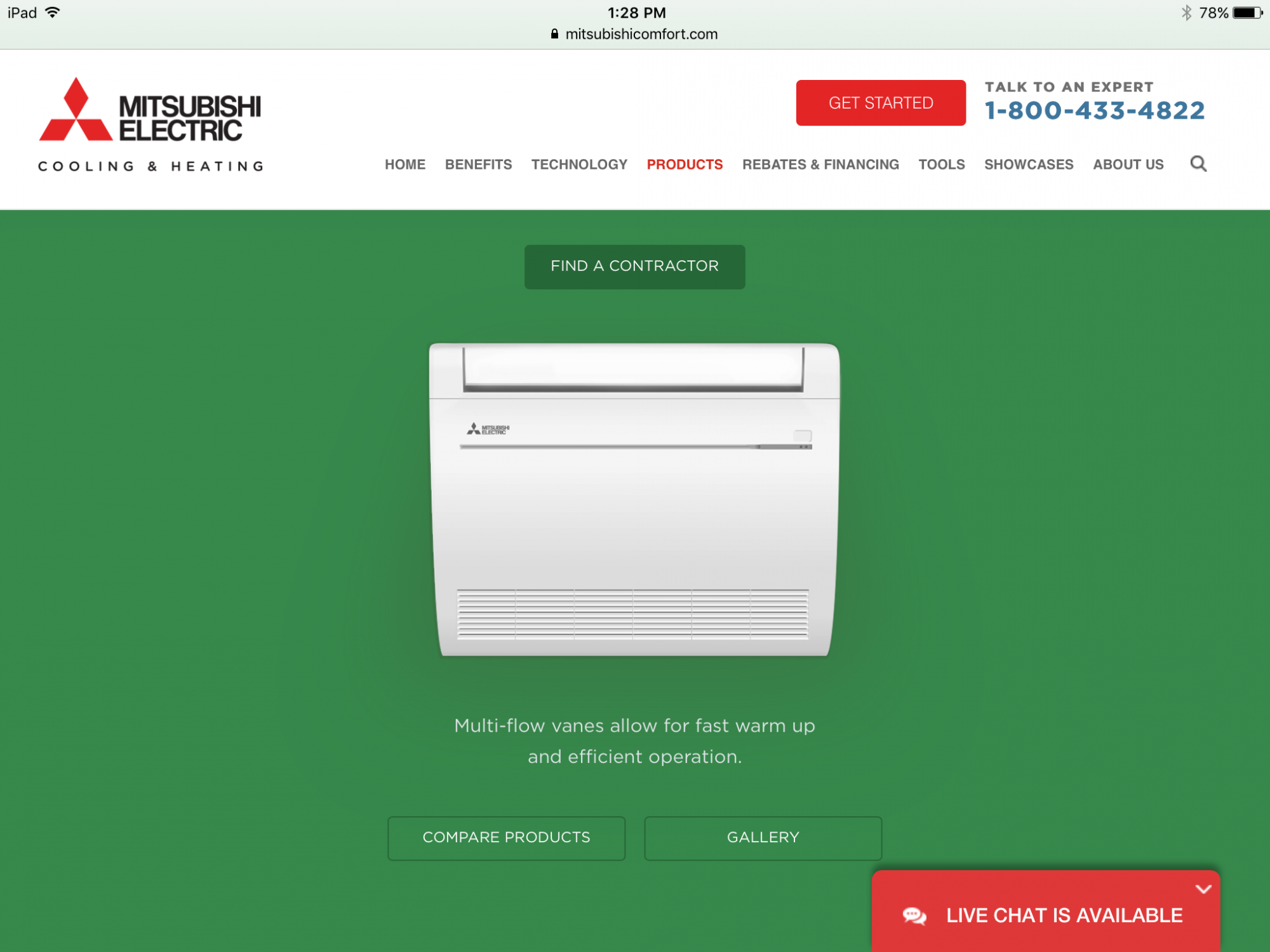

I'm not 100% clear on what you're describing. Do you have any pics of a setup like this anywhere?
Jim26m
Apr 3, 2019
579
Macgregor 26M Mobile AL
This is what he's talking about if I understand him. There is a tubing and power umbilical that connects the two components. You can get different indoor units to suit different mounting arrangements.
Probably would not be my first choice based on what you appear to be doing. These are not cheap, plus, the colder it gets outside, the lower the heating capacity. Can you do it with these? Probably, but might not meet your budget. On the plus side, they are very efficient when the weather is moderately cold.

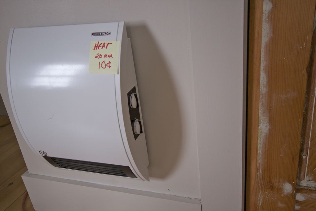

What wattage and how many electric heaters did you have last year? It would likely take 3 or 4 electric heaters to put out a btu equivalent that I'd want as a minimum. Even 1500 watt heaters each require a separate 120V circuit. How many circuits are available to you?
I've used these 2000 watt fan heaters with good results. Not portable though and they use a 220 15 amp circuit. 3 would be close to 20,000 btu/ hr. As well as a thermostat, they have an hour timer that shuts it down at the preset time. They are less than 200/ea.
