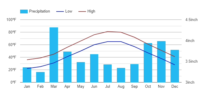

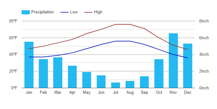

Truth be told, it is much closer than one would think, Phil. Seattle comes in at 147 days/year of rainfall, Boston at 137. Then add a few days of snow to the latter and they are pretty darn close for annual days/year of precip.
But I agree, “275 or so” is close enough.
