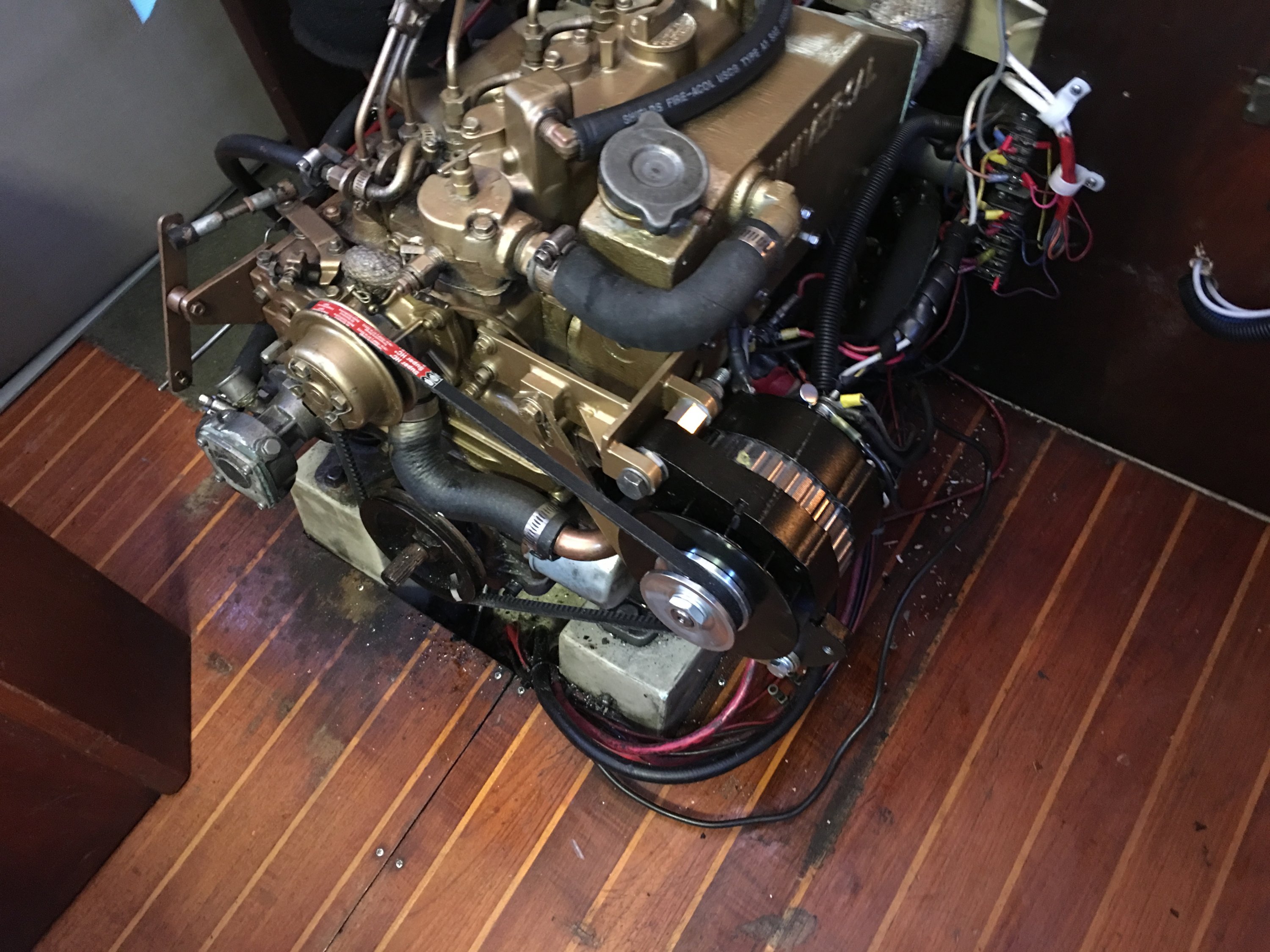

Got a good look at the thermostat housing. Several of the bolts are hidden behind the fresh water pump, which is part of the front cover. I'm not going to pull that. I'll drill and tap a bigger size

got back to the boat yesterday - used a reverse twist drill bit - no luck spinning out the broken studs, but was able to drill & tap to 6mmx1 - with bolts on order. I brought the original alternator (that won't fit nice with new bracket) home to remove the pulley and put it on the new alternator - different shaft size and new alternator has a key - no keyway in pulley -- now I'm off to find a pulley.. Why are simple things so difficult??

Nice Les. Wow. You can see all of your engine and parts with lots of room to tighten or loose something. A lot easier to work on than mine. One of my friends calls it the Black Hole where mysterious events happen. And sometimes a few incantations which children are not allowed to hear.

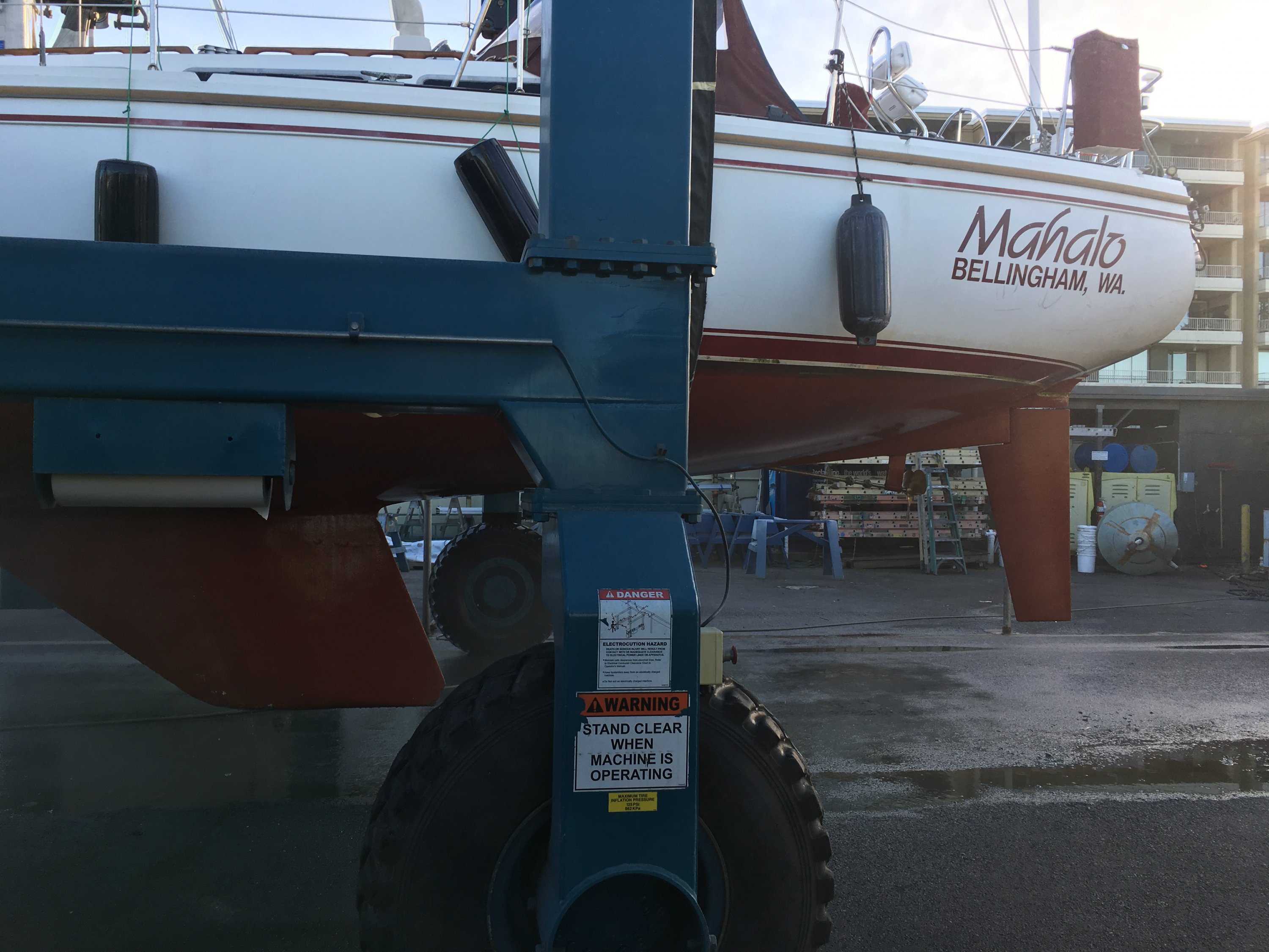

What is the agenda? Paint, thorough hulls, propeller or shaft issues?
22,945
Bottom looks pretty clean. How did the price compare to Everett?
