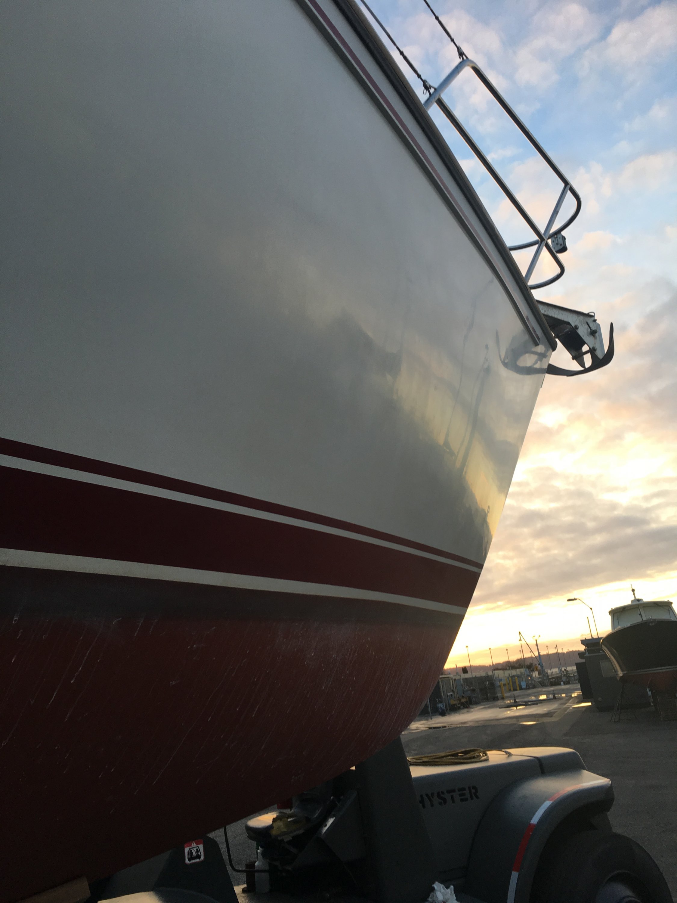

Finished my part of the haul out.
  1. 14/5 and raymarine wind instrument wire run down the mast conduit
  2. Raymarine wind mounted on mast head
  3. Opti mast light installed (nav, anchor, fast/slow strobe)
  4. New spreader boots
  5. New mast boot
  6. New windex vane
  7. Windex light
  8. Polish oxidized hull ( 800,1000,1200 wet sand sand, heavy oxidation compound, polish compound, wax/sealant)
  9. Drilled limber hole for mast
  10. New halyards all around including a spare jib which wasn't on boat when I got it
  11. New spinnaker pole ring height adjustment lines
Dec 25, 2000
5,932
She looks nice and shiny, effort paid off. What does the yard work involve, new bottom paint?
