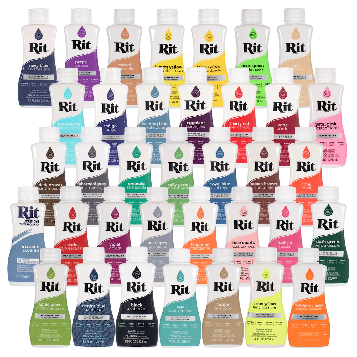

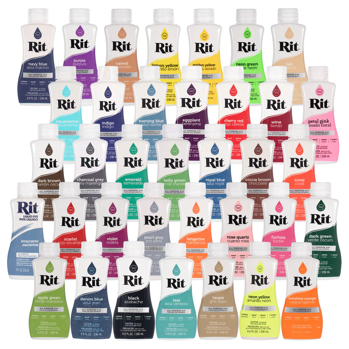

Well I don't have any first hand experience with dying a dodger but I have dyed a navy blue sail cover once. I had so-so results. I used RIT dye. I first washed the fabric with a strong detergent and then rinced it very well. I had a few spots where the dye did not take as well and I think I still had some oils embedded in the fabric but overall it looked better after.
I took the sailcover and put it in a bushel sized tub and filled it with hot water and then added three bottles of rit dye and then put the sailcover in the tub. Pushed it around with a broom handle. I let it soak for three days and then laid it out on a saw horse to dry. Rinced it in the washing maching on cold it looked better than it did before.
I've also used RIT dye on a few black dress shirts with very good results. I think the difference there was I was able to get the shirt very clean first so the dye could take uniformly.
There are a lot of colors to choose from.... I guess I would take the position of... If I'm ready to replace it anyway, I might as well try this first and see if I like the results. But be ready in your mind to replace if it comes out bad...

RIT dye fades rather quickly. My mother was into professional tie dying when I was a kid. The pro grade dies faded a little bit after the first wash but held up after that
