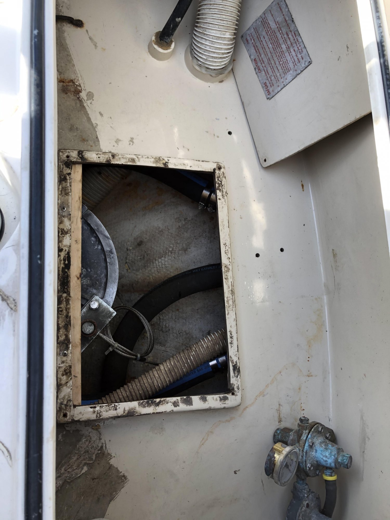

I was in the quarter berth today chasing down a leak at the pedestal and figured that I might as well take a look as long as I had the Q-berth cleaned out. Yep, 32 years is about all they can be expected to last. Not looking forward to it. I have a propane locker mounted in the center of the lazarette which will need to come out before I can even get to them for removal.:banghead::banghead::banghead:

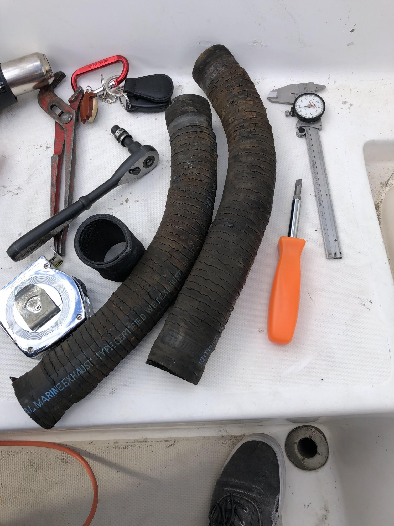

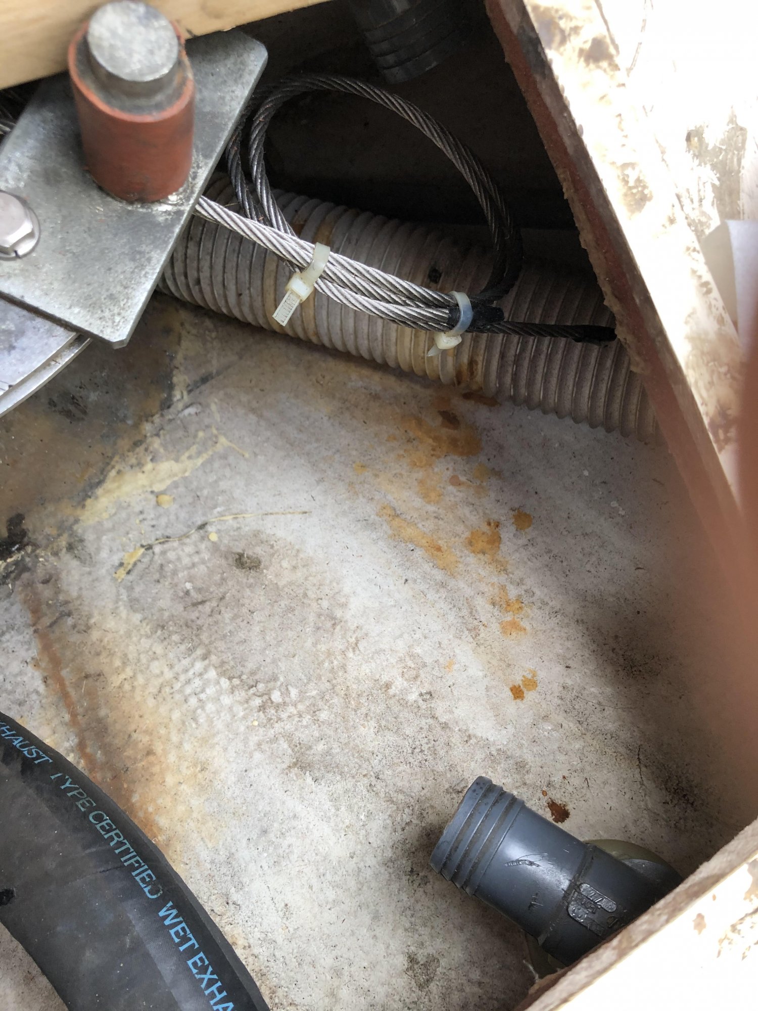

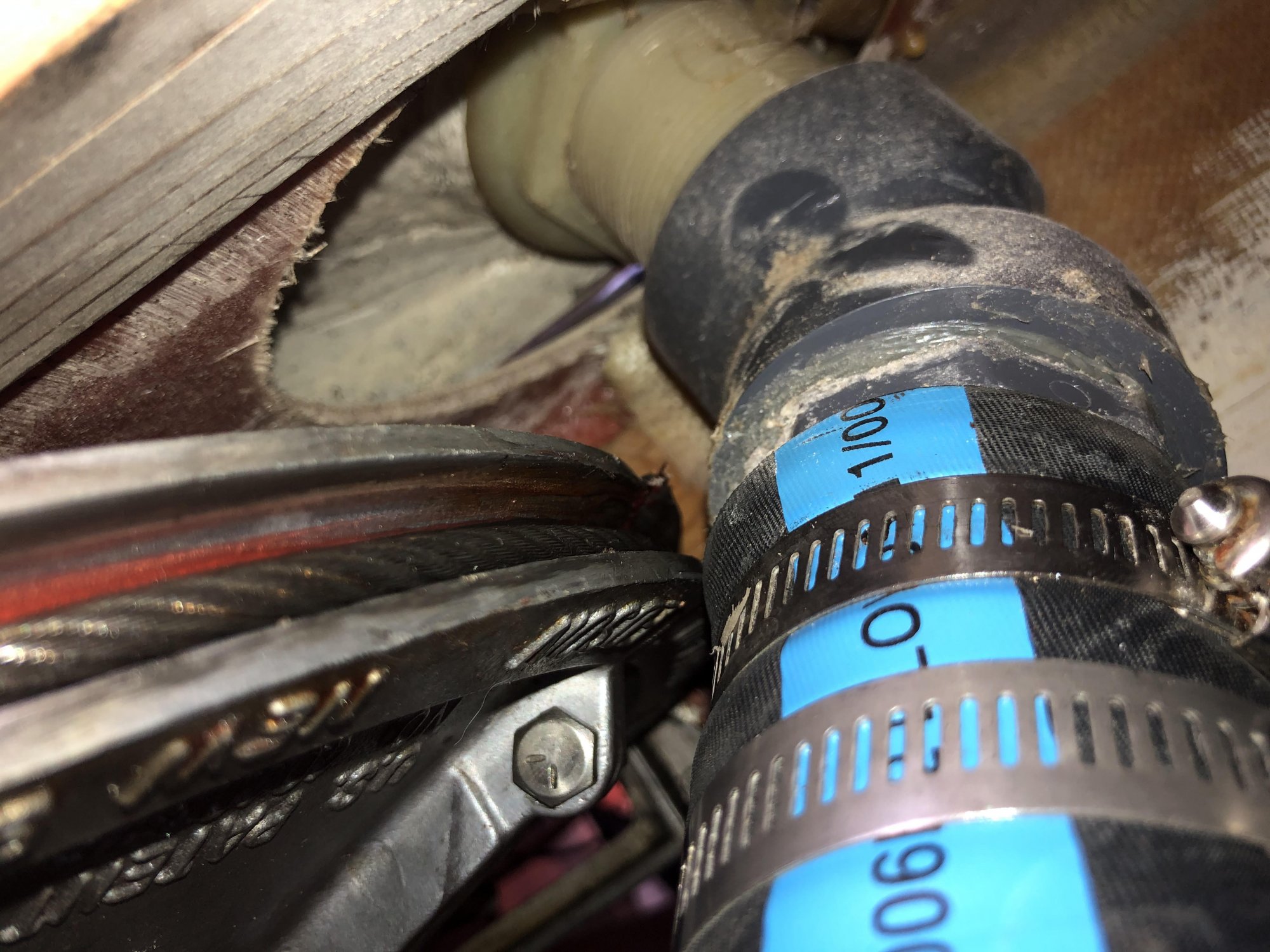

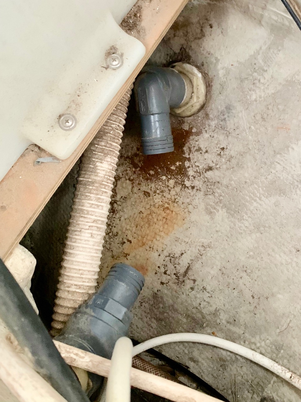

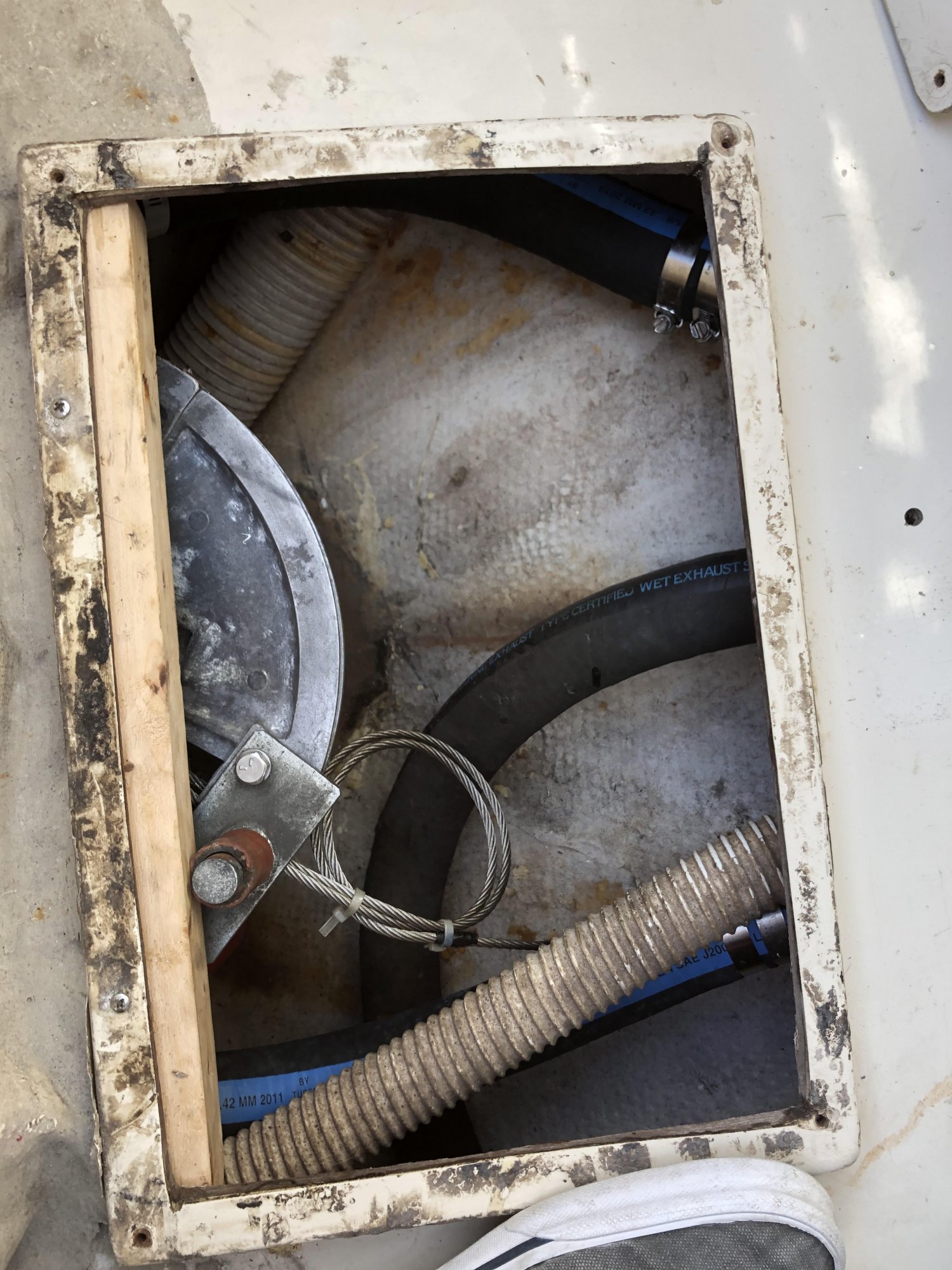

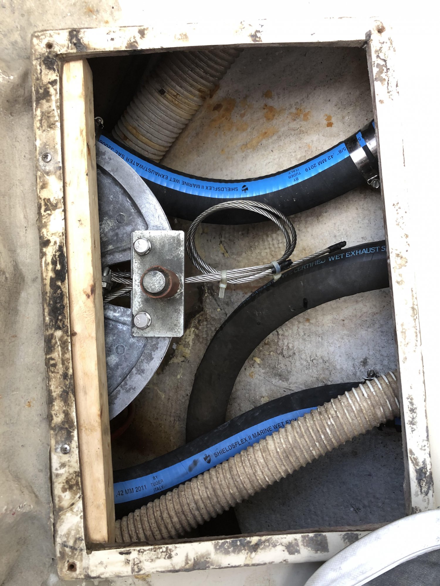

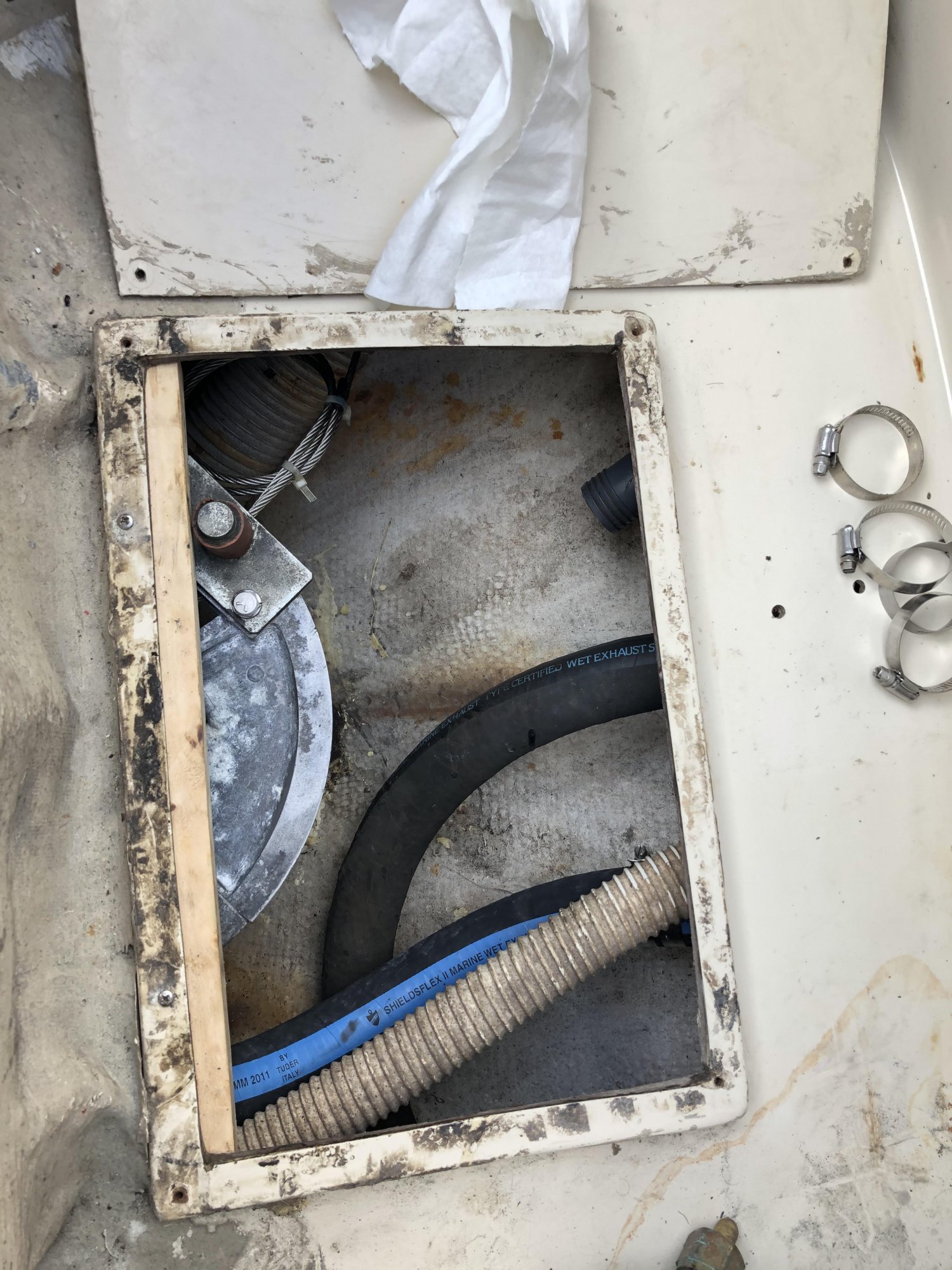

I pulled the trigger the other day. I spent all of $40 bucks on 1 5/8" exhaust hose. The length was 16 1/4" each (the old ones were both the same coming out out) but this is probably very dependant on your boat.
As you can see, the old hose was well past the point of needing to be replaced. Based on my experience with this boat, I imagine that it is the factory original hose. It still bore the 1 5/8" markings. The OD of the nipples on the 90 degree plastic fitting was about 1.625-1.650" (a lot of variation between them.
After tackling the exhaust flapper job, I was ready to be aggressive with the heat gun and dawn/water mixture but I really didn't need either. The cockpit side came off/went on easily. The drain side took a little bit of "hulk" to come off. It was a matter of finding which combination of rotating and rocking back and forth was necessary. Once I made some initial progress I gently used a set of old adjustable pliers to "save my progress" as the nipples would tend to draw the hose back on again.
As has been noted above, you can rotate the drain side onto the hose, but I did not need to do that.
You may notice from my pictures that I needed to orient the hoses so that they would not come in contact with the quadrant.
