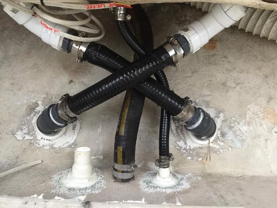

:banghead: I love my boat, but I swear to God that I am going to sell it before I ever have to replace the scupper hoses again.
The Scupper hoses are original and were so rotted that you can cut them in half just by twisting them with your bare hands. (True statement, not exaggerating, my kids think I'm superman now when I showed them "how strong I was":biggrin:)
Anyone familiar with a C30 surely knows about the Hell Hole underneath the stern lazarette that these things live in. I am convinced there is a valiant troll that lives in there whose sole purpose is to protect those hoses and cuts the crap out of your hands when you're not looking. Anyways........
I have tried 4 or 5 different types of hose but always run into one of 2 problems. Either the hose is so stiff it can't make the bends to connect to both fittings, or the hose can flex enough but folds itself in half when trying to make the bend.
I've tried reinforced exhaust hose, trident sanitation hose, non-reinforced exhaust hose, livewell hose, and another one I can't remember.
The one that came the closest was the sanitation hose, but even with a heat gun and silicone spray I could not get it onto the thru hull nipple.
I think my only options left are reinforced potable hose Trident 161 / 162 Reinforced PVC Tubing
or
the really cheap bilge hose Trident 120 Bilge Pump Hose
What have others been successful using and do yo have any tips or tricks that may aid in installation?
(Next I really can't wait until I go to replace the 400' feet of exhaust hose from the water muffler to the thru hull, that is going to be REALLY fun:doh:)

John, I am not quite sure where you got the idea that the scuppers are connected to the sink drain on a C30 cause I have never seen that. If you are talking about the small diameter hose in the photo I posted, that is the drain for the steering quadrant well which is recessed into the floor so it requires a separate drain.
