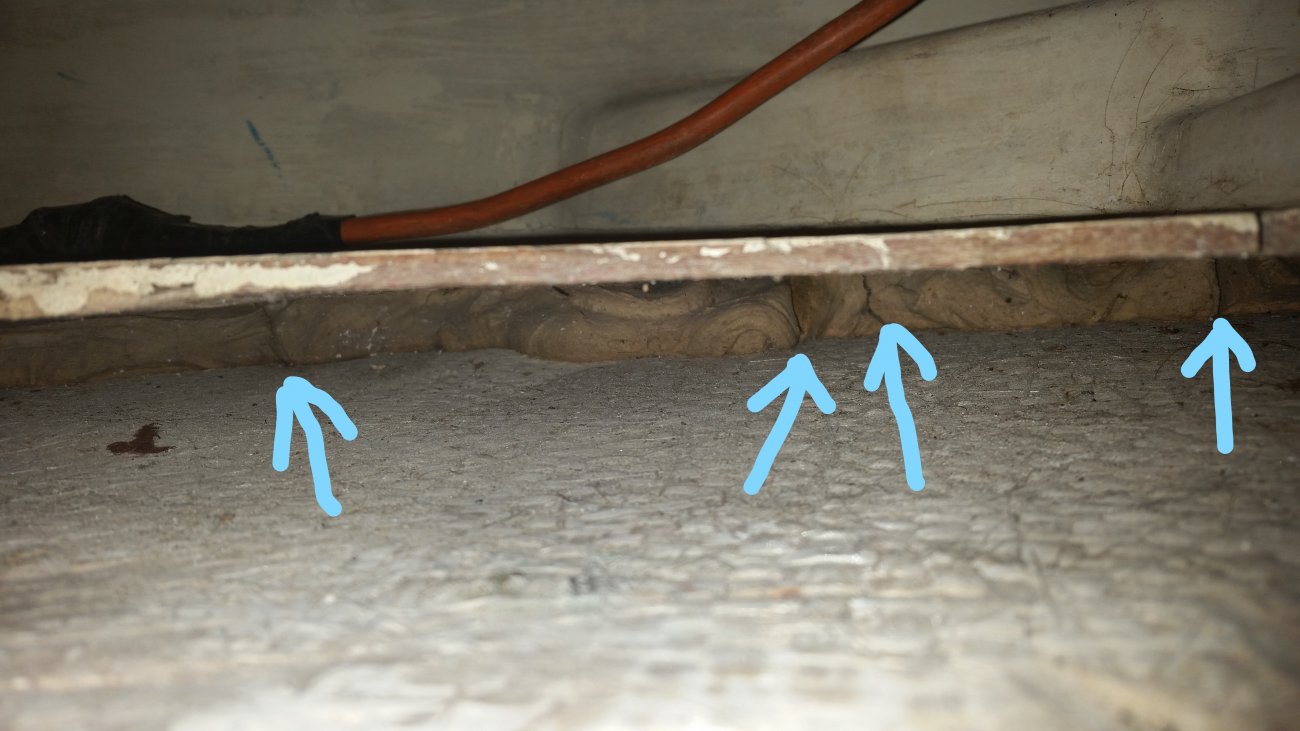

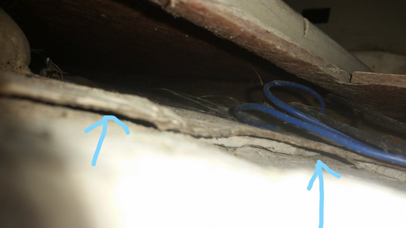

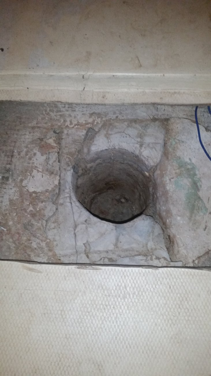

Hey all! Following dlochner's suggestion of possibly doing an endoscopy under the cabin sole, I decided to try to get some pictures first with my phone camera. As Dave posted, I believe when the boat was grounded, the shock caused cracks throughout. I have not seen any signs of any stringers. I am probably wrong on this. But following the idea of a concrete bottom as I was told of the ballast area
(see quidnon.blogspot.com/2015/01/concrete-slab-bottom.html?m=1), I am wondering if this is what I have. It looks like the concrete encased the lead keel area which was then encased in fiberglass. At the companionway entrance is the bilge pump-out sump (this had a handheld pump with hose to pump out any water from the sump, but I have purchased an electric bilge pump to install once repairs are made with backups placed in other sealed-off areas. But that is down the road). This sump area is a concrete makeup complete with cracks--some substantial. But what I did not know was that it seems concrete extended up to where the keel trunk joins the lead ballast which I have been in the process of re-bedding (I'll attach that picture also). And it looks like a heavy fiberglass cloth(?) was applied on top of the concrete which from the pictures indicates to me that it has delaminated(?). As far as supports under the floor, it appears to be some type of epoxy/silica mixture on the centerline in three spots--one just forward of the keel trunk where the portapotty would be located aft of the forward berth; one, about 2 feet forward of the sump and another just aft of the sump under and behind the companionway entrance. In addition, it appears that this bedding compound was placed on top of the fiberglass cloth(?)-- (I imagine similar to that Dave mentioned --1708 cloth--that Boat Works video was using on a Bertram foredeck) --for the length of the settees both Port and Starboard. Then it looks as though the interior of the cabin was lowered in place and pressed into the bedding compound. This is all supposition on my part. However, it looks like it may be more expedient to remove the floor of the cabin from just forward of the keel trunk where there is no concrete present and aft to the back of the cabin area under the companionway entrance leaving the settees in place as the storage areas under the bench seats are fiberglass (I previously removed the thru hulls and fiber-glassed over before having the exterior of the boat painted. A question I have is: should I repair the external area first because water drains out of the cockpit and then travels under the hull to the back of the keel? I am thinking it is getting into the keel area through the external damage and as it dries out, it leaves the bluish-gray residue stains on the back and both sides of the rear of the keel.
My next plans are: to check in to the endoscope as Dave has suggested; try to become a member of the Gloucester Sailors group dedicated to Harry Sindle designs as Joe mentioned in my previous post to look for further info on the construction from other owners of Lockley Newports which from my understanding became Gloucester; study more about concrete slab bottoms as with the Quidnon blog I referenced at the beginning of this post; and, to look for someone in my area who might have moisture reader; also, as Selah is on a trailer and I have a tent over the deck of the boat, I need to try to seal the stern area off from the cockpit drain forward to the front of the keel to redirect any water from rain storms and prevent any more water from traveling that route.
Thoughts and suggestions are all welcome. I know some will suggest getting rid of the boat. I knew from the start, this would be a big project and am dedicated to seeing it through--for me and the memory of my wife. Thanks everyone. (Have fun exploring these pictures! LOL)

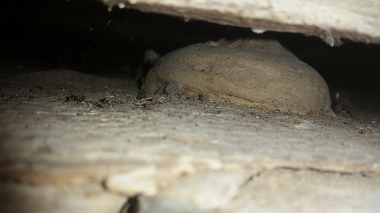

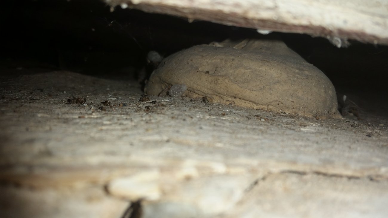

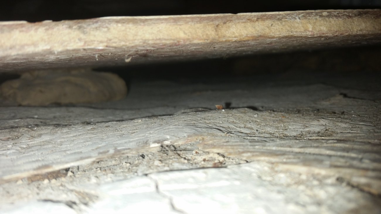

The easy part first. The inner layer of fiberglass is roving. this is a really heavy fiberglass cloth that soaks up a lot of resin. Because it is a heavy cloth it builds up hull thickness quickly. Roving is very different from 1708 that Andy uses.
Fiberglass production boats are usually built in three or four big pieces. There is the hull, the deck, the cabin liner, and sometimes a head liner. Once all the parts are complete, the cabin liner is lowered into the hull and bonded in some way, in your case on piles of what is probably a polyester based bedding or fairing compound. Next the headliner is lowered in place (if it has one, not all boats do) and finally the deck is lowered and secured to the hull.
The cabin liner is more than just a pretty face, it is structural and helps to keep the boat from folding up. Once the rig is tensioned, the tension tries to drive the mast down and to the keel while pulling the sides of the boat together along with pulling the bow towards the stern. To visualize this have some one hold a piece of paper and then take a pencil and push down on the paper, you'll see how the paper depresses as the pencil pressure increases. Same thing happens to a sailboat. The seats and that long row of bedding compound help to keep the bow and apart. The floor and bulkheads keep the sides apart. As you dig deeper into this project realize that everything has to go back in. The floor cross section looks pretty thick and looks to have a balsa core. That suggests to me it does more then provide a place to walk or rest your feet.
The cabin liner and the way it is bedded helps to reduce hull flex. Large expanses of fiberglass will flex, it is often referred to as oil canning. As the boat moves through waves and chop, the hull will want to flex, longitudinal structures stiffen the hull and prevent or minimize flexing.

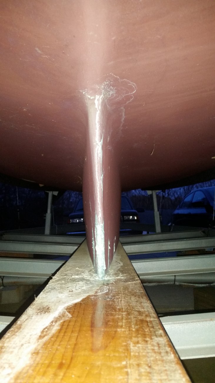

Can you just raise the front of the trailer so water drains aft?
So long as the boat is out of the water, I would approach this from the inside out. That will give more time to dry out the keel area. Although, I would get the bottom paint off the keel to see what it looks like.

The picture that you marked up look exactly as I would have expected.
The cracked concrete and lead was not suppose to have any structural strength so just keep them from freezing and they can get wet and still be okay. That said Dry is better.
Except for the external shot I did not SEE any problems, I don't know what the cable goes to, so I would remove All bottom paint and then see where you are. It is general better to work from the outside, remove problem material there first. Your hull may have been constructed in 2 parts for ease of construction and then glass together when the ballast was added.
Remember most parts have a given shape for a reason and you need to understand that first before you change anything.
Do not add interior baffles or wall just to keep water from getting into the bilge. Water trapped in a lining is much worse than water in the bilge that can be pumped out easily.

As far as tilting the trailer so that the water will run out of the cockpit and not drain/run down to the back of the keel, that is very doable. The only problem is that in an attempt to level out the cabin while I worked on the inside, my son helped me to put the trailer on blocks to obtain the level inside the cabin--I wanted everything to be as level as possible so that my measurements would be accurate. Anyway, if you think I need to make the external keel area priority, I can do this and then when that is repaired, then put the trailer back on blocks. As far as taking the bottom paint off the keel to expose damage, I had originally sanded all the bottom paint off and had it repainted with Interlux Primer and Baltoplate bottom paint after the patch was removed and repaired by the person who painted the Primer. Selah has not been in the water since that was done. However I have seen several places where the Baltoplate has turned loose from the Primer. Another person who does boat painting told me that the Baltoplate turned loose because it was not applied within a short period of time after the Primer was rolled on. In fact, I know that it was probably 2 months before the Baltoplate was applied. Therefore, removing the bottom paint around the keel will not be a problem because I plan to have the entire bottom redone before she goes in the water.

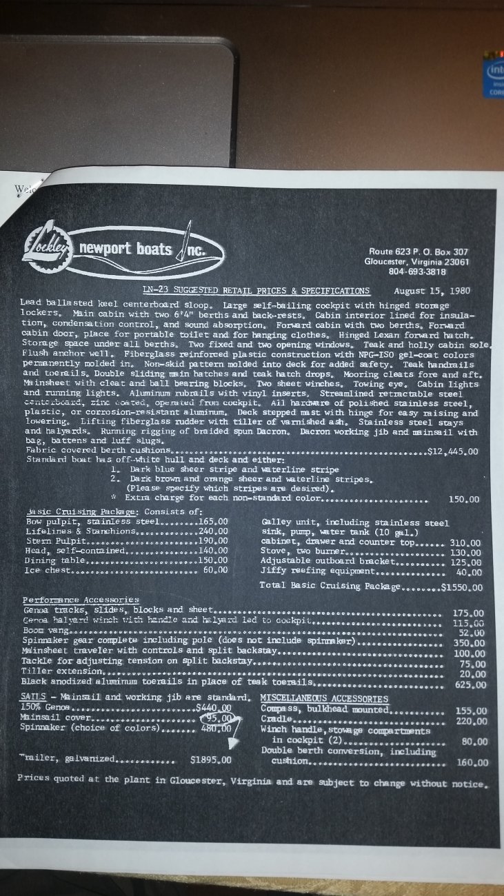

Thanks Mr Condon. I'll post some of the pictures from around the base of the keel trunk before I began rebedding that area. I did go back through all the paper work and found the original
LN -23 SUGGESTED RETAIL PRICES .AND SPECIFICATIONS.
It is dated August 15, 1980.
I will copy to my computer and post tonight for anyone following this refit. And again thank you all who are helping me and raising questions and making suggestions -- it truly means a lot to me. As I stated in earlier posts, this is a learning process for a larger boat that I plan and hope to cruise and live aboard. And, I want to make sure for my own piece of mind that when I sell it for a larger boat, I can do so confidently, and with the new owner satisfied, too.
Thank you, James

Hello everyone. This afternoon, I was looking through the documents that I was given upon taking possession of Selah and some documents that my late wife had found and downloaded. She had located the brochure including LN -23 SUGGESTED RETAIL PRICES AND SPECIFICATIONS. It is dated August 15, 1980.
I hope this is helpful to those who are following the refit of my Lockley Newport. If any of you know of anyone who owned or still sails the LN-23 I would love to talk with them. In the meantime, I have been trying to join the Gloucester Sailor's forum that Joe Blizzard mentioned in an earlier posting but not having success. I am doing something wrong, I'm sure, but will keep trying. Also, Dave (dlochner) suggested an endoscope and the amazon site. It came in this afternoon and am looking forward to having a good look at the bilge area under the cabin liner this weekend. I'll post some of those asap. In addition, Mr. Dave C., the boat was built in 1981 according to documentation and BIN #. And, yes, the boat has been out of the water since we purchased it in 2006, but due to many issues that occurred in those years, the refit was delayed but I am moving on it now (please see initial posting for "Selah" when I joined on Jan. 13, 2019 in Ask All Sailors. Have a good night, all.

I was surprised lead for ballast was used back then contrary to what Harry said. I stand corrected. Emphysema is serious and I am fully aware what mold, etc. can do to you. Once I cleaned out a very moldy boat and paid the price for nearly two months during the winter between shows. I think a phone call between us might be suggested. Send me a private email via forum email as I have a lot of questions trying to help you.
