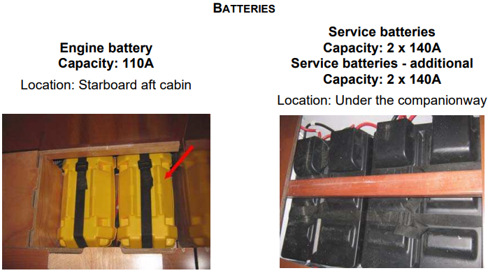

Please post are these for the house, the current number of batteries (4 as shown below from the attached manual?), manufacturer, voltage (6, 12, etc.), type (lead acid, AGM, gel, lithium), group (24, 27, 31, 4D, etc.), amp-hours (140 as shown below?), dimensions, budget and any proposed upgrade preferences/requirements then the forum can make recommendations on where to source them.

sfbay - yes they are the 4 beneath the companion way, house set. The issue is that the boat was made in France and they used European Exide ES1350 (4) AGMs and the difficulty is finding batteries here (4 of them) to fit in the space. Sorry i was not more specific with question folks! The 4D AGMs at WM and Fawsetts are different sized and may only be able squeeze 3 in without modifying the space. Just curious what worked for other Beneteau 48 owners.
