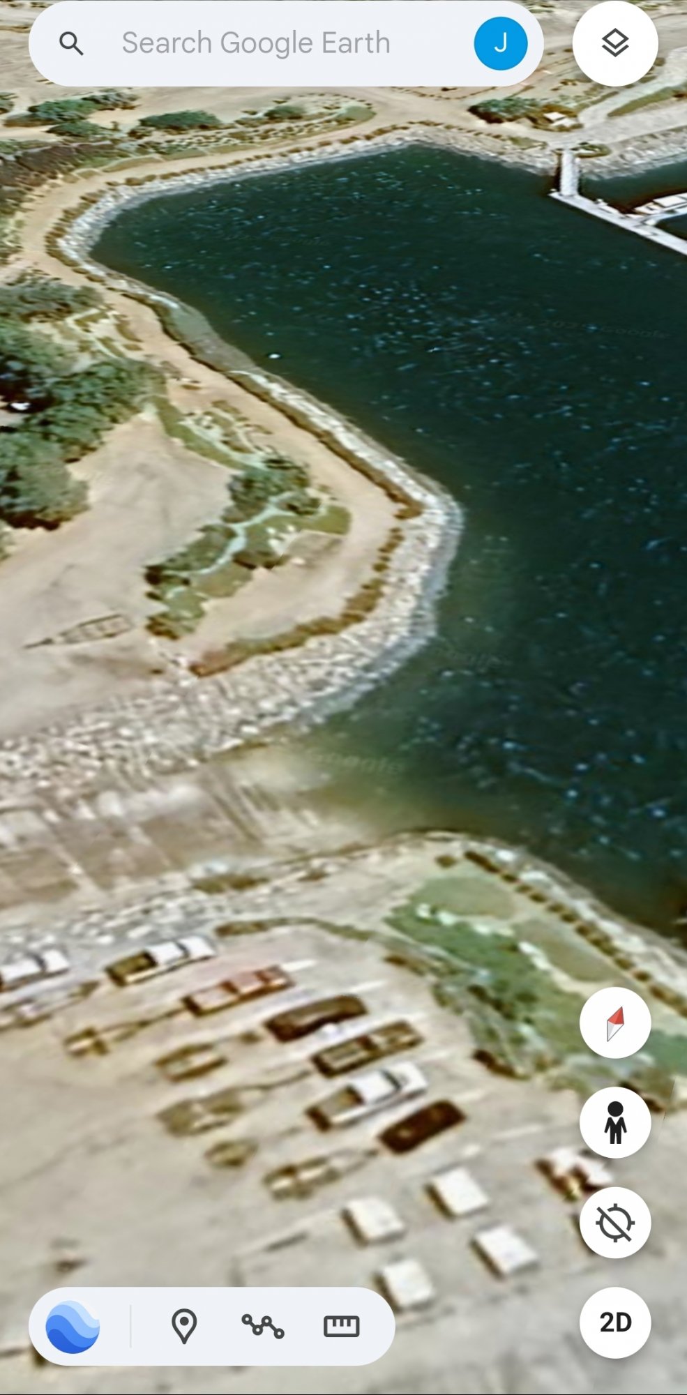

The place I'll be launching from (launch and retrieve every outing) is just a gravel/concrete ramp, no pier, no dock, no slips at least not for the public.
The only other nearby option is just the beach.
So, not really an option.
