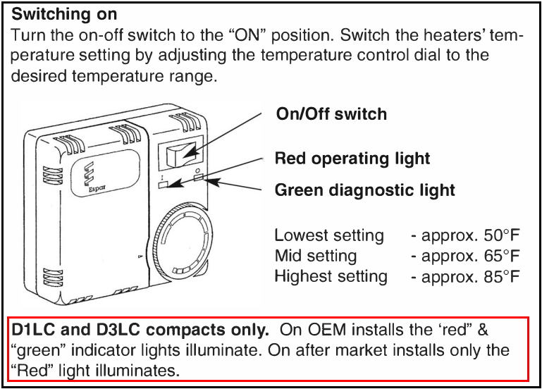

Your thermostat be it digital or analog will or should show a code. If analog then the green light will flash a number of times which can be looked up in the tech manual. If digital it will show a number again indicating the fault. The following website should have the technical and trouble shooting manual for your model.
Eberspacherdirect.com/technical-library/
When my espar on the Catalina 30 had a problem I noted the green flashes looked in the manual the owner had left for me and determined the problem was beyond my skill and technical talents. Removed the unit took it to the dealer who determined after careful examination that replacement parts and service would be prohibitive and therefore I purchased a new one that was about one boat buck since they would use my old unit for spare parts. Sold the boat about 6 months later, espar working nicely.

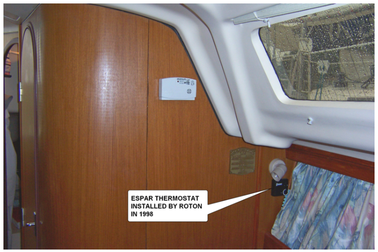

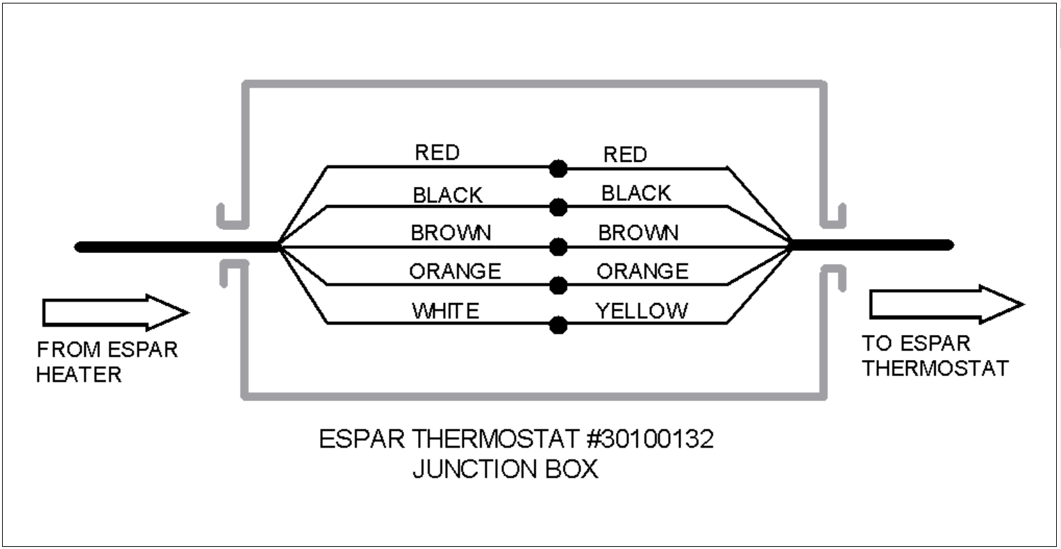

A week ago I was in the process of re-locating the stat as it had always had poor responce due to (most likely) being in a location with poor air movement and close the hull which is covered by a wooden veneer liner as shown below :
I was in the process of moving the stat to a more open area and well away from other sources of temperature error. I took my time and spent a week installing 8 ft. of additional cable using a junction box :

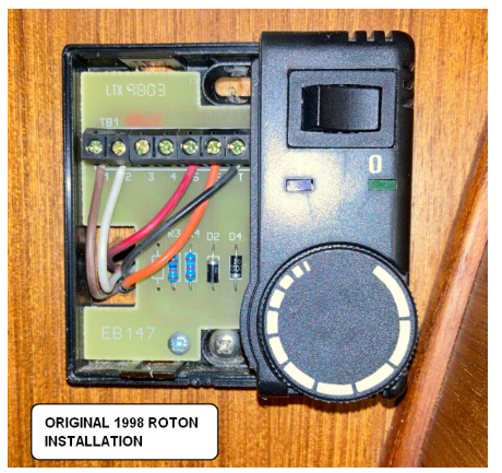

Nice and neat (lucky) as only one original colour from the Espar harness changed ie. white to yellow.

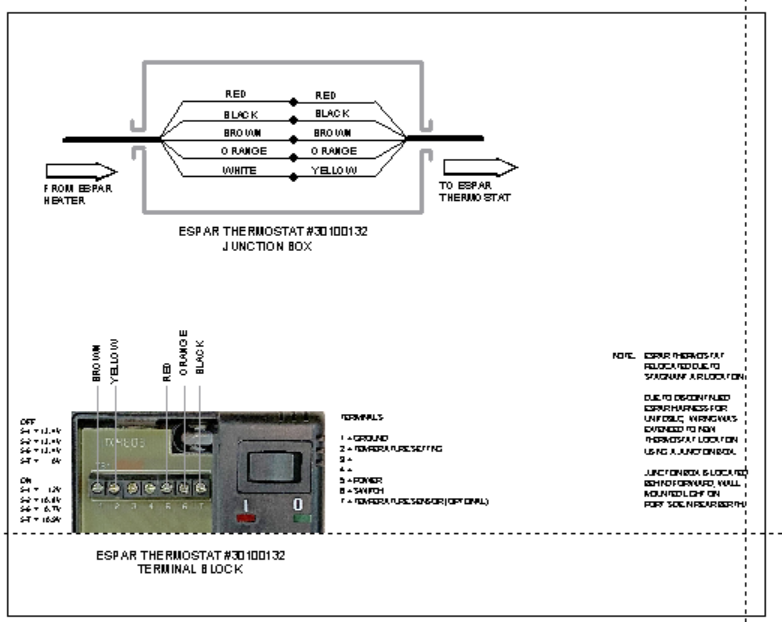

Just to be sure, I took a picture of the original wiring connections by Roton Industries in Vancouver which worked well for some 26 years :
The stat part number (PN 30100132) is the closest guess I could make with Espar's infinite selection of stats all separated by a vast array of part numbers and the last 2 digits are the only ones to change. Physically, all of the stat exteriors with PN 301001 _ _ look the same and they never tell you what the difference is between stats. All I can say is that mine is the simplest one they have to control a three level burner and the stat has no means of self analysis.
Once the new wiring was in place and the thermostat was relocated to its new location, the thermostat was wired according to the original photo. The single wire to the (+) battery post was once again connected and the heater turned on. The battery was fully charged at this time. The heater went through its startup as it always had before. I let the boat heat up for about an hour as it had cooled off while the thermostat was being installed (and it was freezing outside). After about an hour, I noticed the boat was getting warmer than need be and I turned the thermostat set point down. The burner stayed on high. Again I turned the set point down. The burner stayed on high. Finally I turned the set point down as low as it would go, but the burner output did not decrease from high by the sound of the fan and the ticking of the fuel pump. An IR gun showed the temperature of the thermostat body to be around 65°F and a wall mounted thermometer in the area showed the same. Just to be sure of what I was seeing, I directed a hair dryer at the thermostat until the body showed 80°F without any decrease in the output of the heater. At that point, I manually switched OFF the thermostat using the OFF/ON switch. After that shutdown, there was no sound or amperage draw when the ON switch was turned on at the stat.

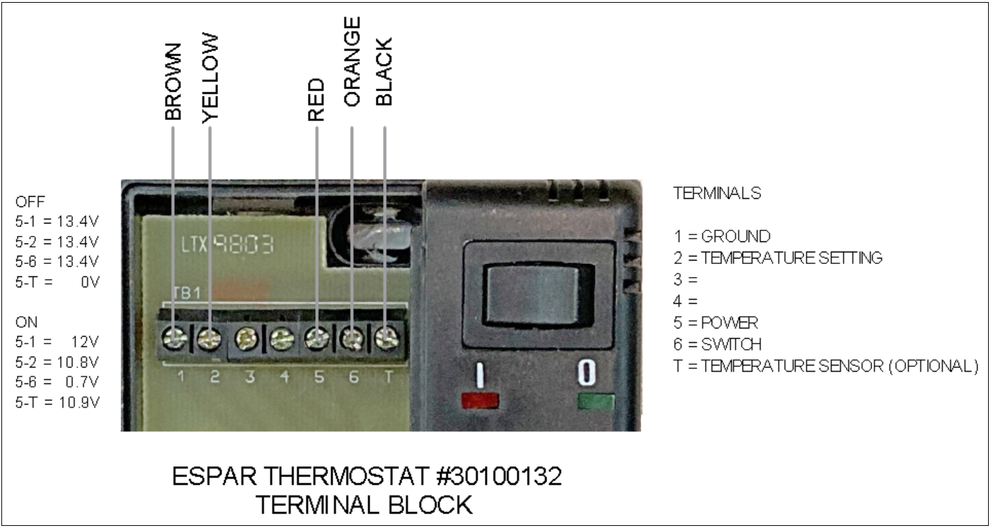

The wiring to the stat and the purpose of each contact is shown below :
The figures on the left side are voltage readings from the battery connection (5=POWER) to the remaining terminals when the stat switch is turned OFF and below when the switch is ON. The voltages seen when the switch was in the OFF position are due to the battery charger being on and at the float stage. This terminal check was not done in relation to any of the above tests.

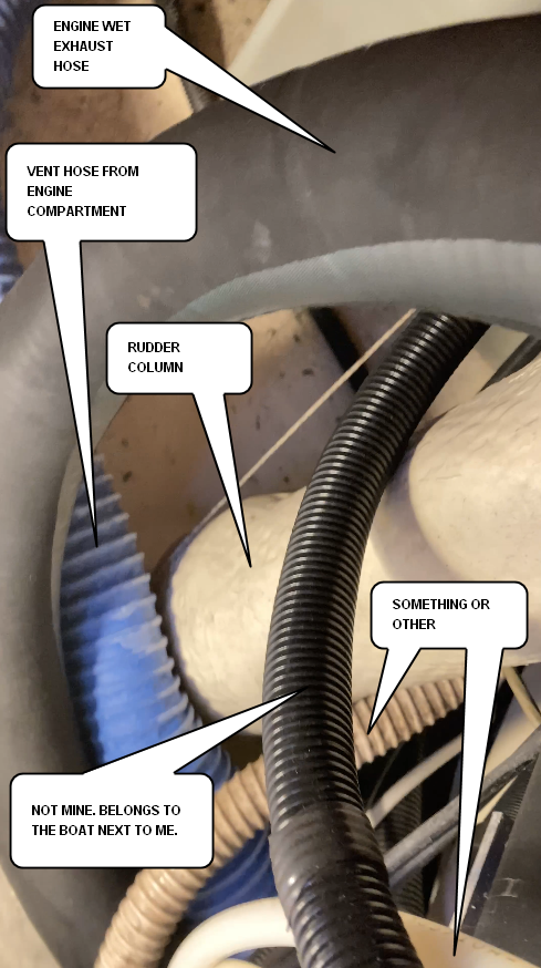

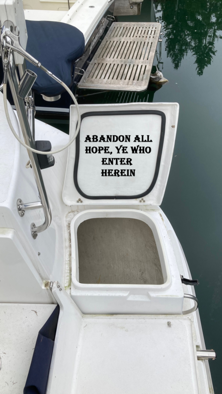

There are those that say this lazarette was the original "Black Hole of Calcutta" (BHOC). Stick your head in there and you too will believe. The interior is crowded with hoses, wiring, and rudder columns of every shape and dimension imaginable. This is what you're met with inside :
I was solo on this trip as all the members of my boat crew were off attending other social activities on this day. Seems that whenever I need help, these people are always tied up with every sort of social undertaking imaginable ............. births, deaths, weddings, divorces, funerals, Bar Mitzvahs, you name it, they're going to one. One couple was married twice in the same year and then once a year later, another one has been to a great aunt's funeral three times (same great aunt every time), and another attends their nephew's Bar Mitzvah every year (same nephew). I can't keep track.
Seeing as how I was not about to enter the BHOC by myself, I used my cell phone with the video set to 4K and 60 frames/second. Stuck it on the end of a selfie stick and jammed it into the BHOC. With my usual luck, I was not able to get close enough to the heater for a good shot. I moved very slowly at suspected label locations but was not able to get near it at the correct angle due to everything getting in the way. This one frame was as good as it got in the wet snow mixed with rain :
Just not able to get the camera high enough due to the obstructions. Also, not being able to spreken ze deutsch (or English for that matter on a bad day) I can't see if there's a field for a model number elsewhere on the label. Lot's of junk to remove before I can even think about venturing down into no man's land.

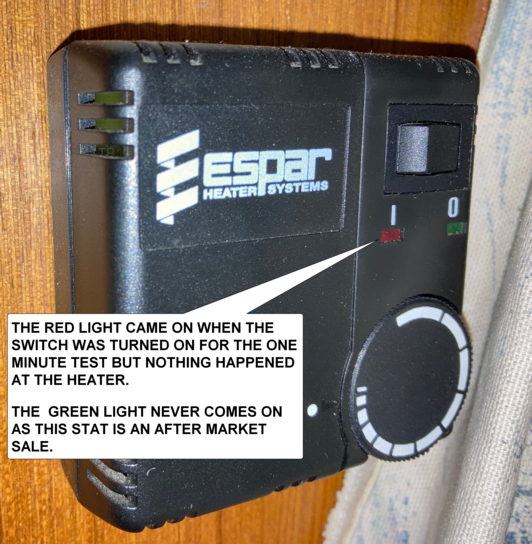

@Windpilot No. My stat is old enough that it doesn't have any form of self analysis. The glow plug sounds like a good candidate for an "experimental replacement" seeing as it's relatively cheap. Thanks for that idea.

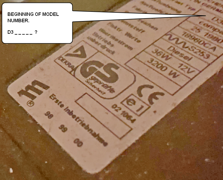

@Hello Below Thanks, I do have your installation manual for the D3LC and many more different D3LC installation manuals as well. Each one has another little nugget (but only one) in it so you need the entire bloody collection of manuals to get all the tips and tricks for the D3LC heater. I always thought these people were so bloody organized with their train schedules and brewing of beer. How did Espar go so, so wrong with their manuals ?

WOW :) My 2 cents.... when it does come back, find a better spot for the heater. It really should be cleaned every 1-2 seasons.
The off switch with the T-Stat is ok, just don't disconnect it from the battery (breaker / main batt switch) until cool-down has completed.
On some Hunters, that swim grid lazarette cover/box can be completely removed? Not sure if the 310 has that feature or not?

If the green light illuminates you've got diagnostics. I'm after market install so no diagnostics for me.
This is from the original purchase of the Espar heater. It was only identified as a D3LCC back in 1998.
I will look at extending the support arms for the heater to bring it out to a more accesable location, away from some of the crap. Not like there's a lot of traffic down there.
Right now it's part of the FG body of the boat. Wait until I get the damned chain saw and maybe things will change :cuss:.
The charts in the link show a difference between the two Stats.
ELECTRONIC THERMOSTAT MK2 WIRING DIAGRAM
Please find attached wiring diagram numbers SK 0394 and SK 0393 for the MK2 (301) type
electronic thermostats: Part numbers
  • 301 00 132 12 volts
  • 301 00 133 24 volts
Thermostat Installation
Instructions
P/N 30100154 (12v) This would be the Espar branded stat mentioned by Len with the lights. It is like you 30100186 model (does not have the green light
P/N 30100153 (24v)
For Heaters
D1LC compact
D3LC compact
