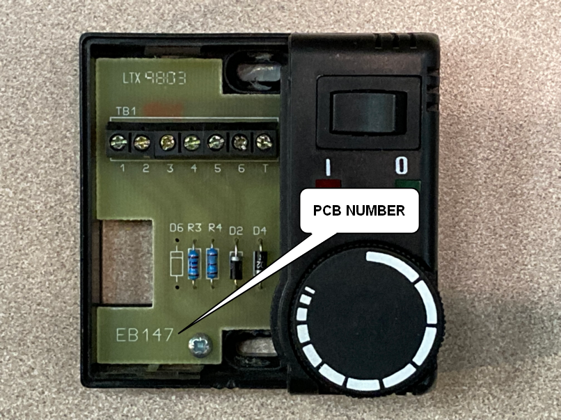

Several days ago, one of the SBO members here sent me a PM which revealed reams of information on Espar burners and stats which I had been unable to locate by picking and poking through the net for weeks.
One staggering item found was that each stat does, in fact, have a means of identification :
All right now, settle down, settle down. Don't get excited because it doesn't do you a damn bit of good. As far as I can find, Epson has never published a list relating PCB numbers to stat Part Numbers so you're no further ahead.
IMHO, the member who located this and a plethora of other material deserves the credit for this real life find and I will leave it to him to inform you of how he did it. I had spent days searching the web and hadn't even scratched the surface before getting his input.
Not all of the information has been useful (eg. as above) but it does show what a useless crowd of idiots Espar employs in their technical information department. In a recent reply to an e-mail I had sent to Espar looking for stat information for my burner unit, I was given what I consider, IMO, to be a wrong reply by someone who knew less about Espar stats than I did just based on the Espar literature I had collected. And that's scary.

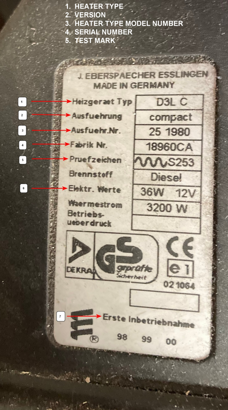

First thing of any use was a good shot of the label on the burner body :
A little digging for a translation and this came out making some sense. It tells me I am the owner (for better or worse) of a D3L C (C for compact) heater with a 25 1980 model number. Getting closer.

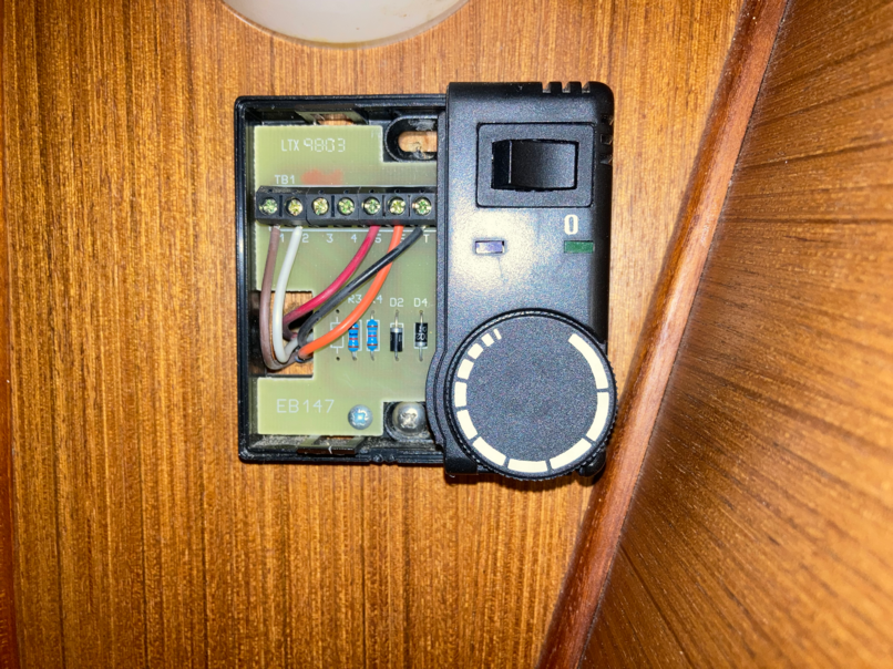

For the answer to that age old question, "Thermostat or Heater ? Thermostat Heater ?" I turned to AI with a photo of the stat and they were able to identify that :
The red wire (#5) was connected directly to the battery (+) post and was the line supply to the OFF/ON switch and the orange wire (#6) was on the load side of the switch and fed the start signal to the burner. This I was also able to confirm with Espar literature. So ................. if we connect the #5 wire to the #6 wire, we eliminate the stat from the circuit and the burner fan should start up. It didn't start (GRRRRRR) so we can eliminate the stat as the cause of the problem and move on.
AI also issued such reminders as check for (+) voltage in the orange wire back at the heater and check for a good ground as well while I was back there. If everything looks good for wiring to the heater, bad news because the heater has to come out. It's still too jammed to do any detailed work while the heater is in place.

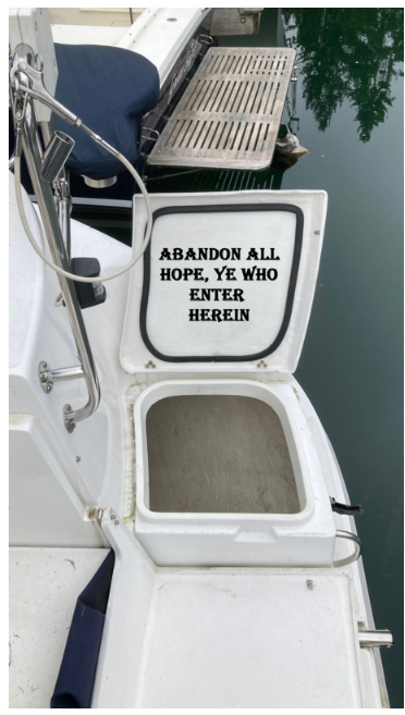

Talking about getting stuck in the lazarette, when I first went down the hole this time to see what was what, I didn't bother with a safety watch. C'mon, what could go wrong ? That's easy. I dropped my foamy which I would lie on as microscopic relief from the discomfort of being down there. What could be easier than leaning over the edge of the lazarette and grabbing the foamy ? Easy peasy.
Nothing really. All was gong swimmingly until I reached in about 1/2" too far and teetered over the edge of the lazarette. A vision of "scrunch" if ever there was one. My face was plastered against the bottom of the hull. My arms under my head. My phone was in the cabin. My body plugged the opening and it was highly unlikely anyone could hear me. Anyone who could hear me would likely run like hell in the opposite direction for fear of whomever or whatever posessed such a violent language. I hung like that, upside dowm, for about 15 minutes before figuring out that the only way to escape would be to do a handstand push up until I was high enough to either fall to port side or fall backwards into the water. I fell to port side and lived to tell about it.
I now have a 20' length of line with a knot every foot, tied to the pushpit and hanging in the lazarette before I go in. And my head NEVER EVER goes in before my feet.

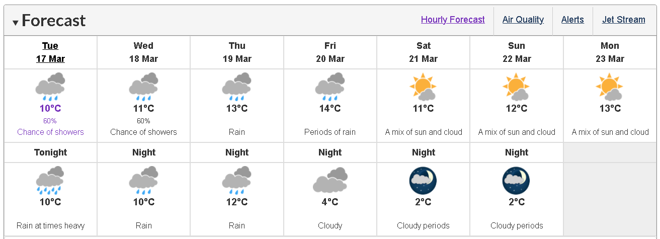

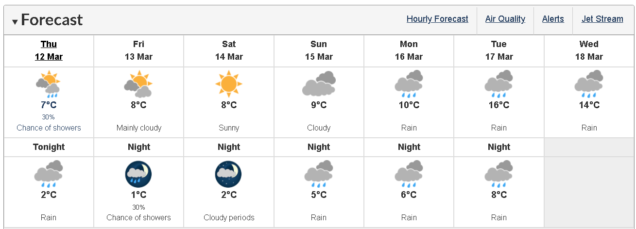

The coming weekend holds the bright sunny promise of sunshine and warmer temperatures :
Yes yes, I know, last weekend held the same promise and although it was sunny, it didn't get above 4°C (39°F) so that's no fun. This will be better because it definitely can't get any worse.
