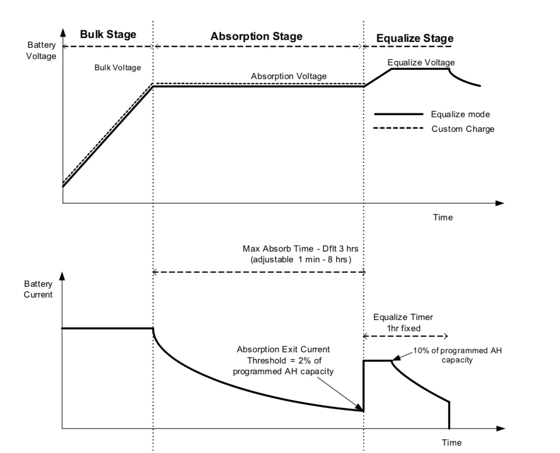

Now follow me, using that graphic, which is correct, and I will tell you the VOLT and Amps and some time factor too.
1) Voltage went immediatly to the max of 15.9 VDC and flat lined.
2) Current draw , just like the graphic, as the intense Reversing Chemistry started to "kick the plates awake" [main reason to do this]
Your explanation has things I don't understand.
This graphic is NOT showing a flat lined voltage.
Number 2 problem - you can't flat line a battery that is deeply discharged with voltage. The power supply can't do it. The voltage will increase over time as the battery can accept charge. If you did try to push as much amperage into that battery to flat line at 15.0 vlts you'd fry your battery from over temperature.
So explain to me, an ignorant layman - how the front part of that graph showing oscillating voltage and current, is represented by your statement of 15.8V flat lined.

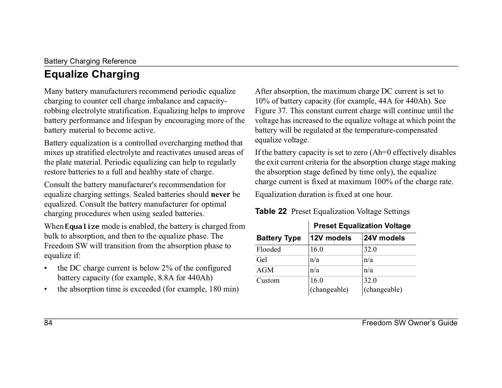

If you look through the manual that @JamesG161 posted, the equalization process on that charger is a manual process and is timed - it goes a maximum of 8 hours. I prefer my method, but then that also requires a lot more work and owning more than one charger/power supply.
As far as I'm aware, there is not a charger on the market today that has a routine that is "intelligent" when it comes to equalization, neither marine nor automotive. It seems to me all manufacturers have their own why of putting equalization into their literature/products. You'll have to decide for yourself if the pulse charging is what you want or not. If I had to stick to one charger that did it all, I'd prefer the charger that @JamesG161 posted. But that's your decision.

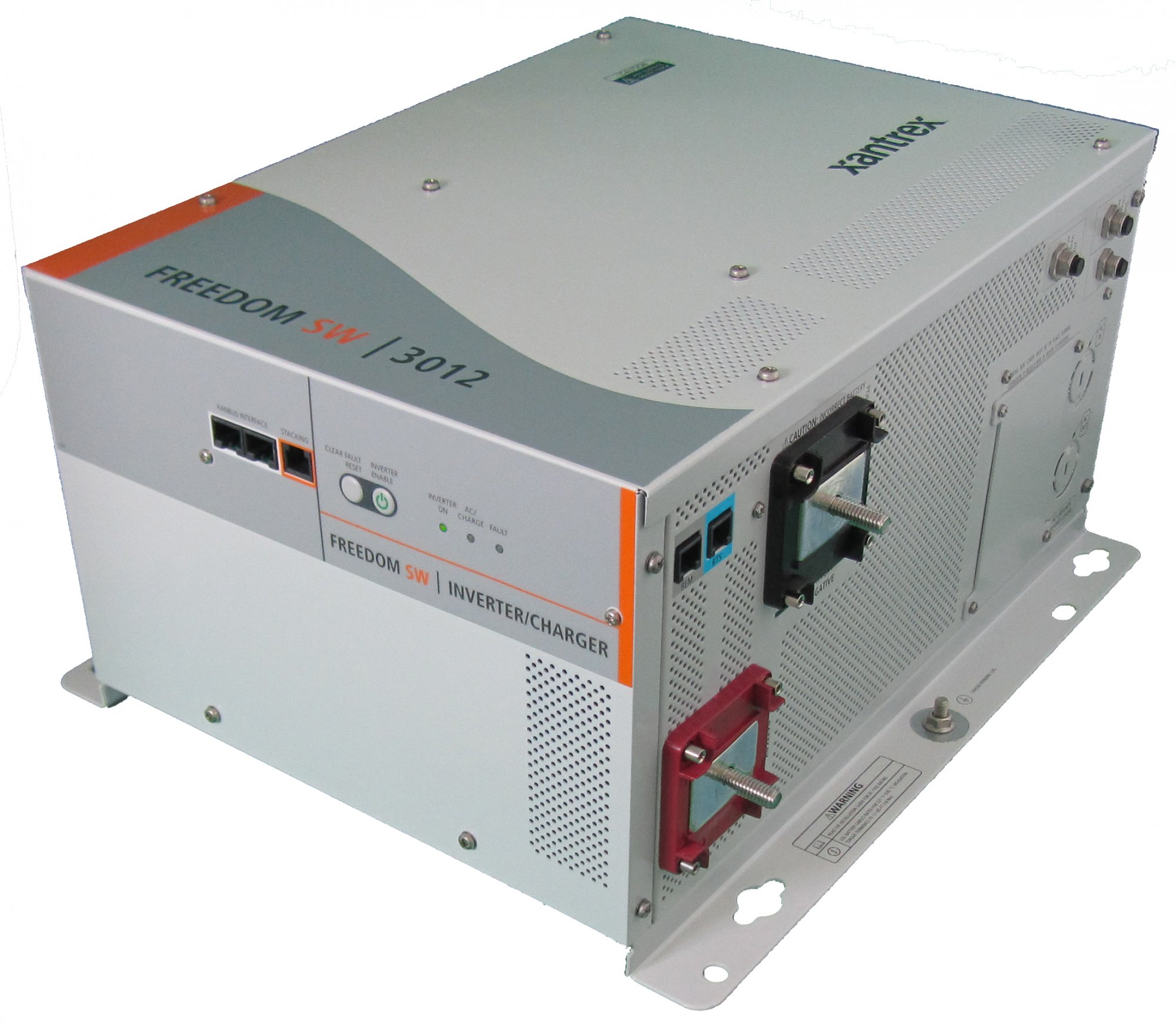

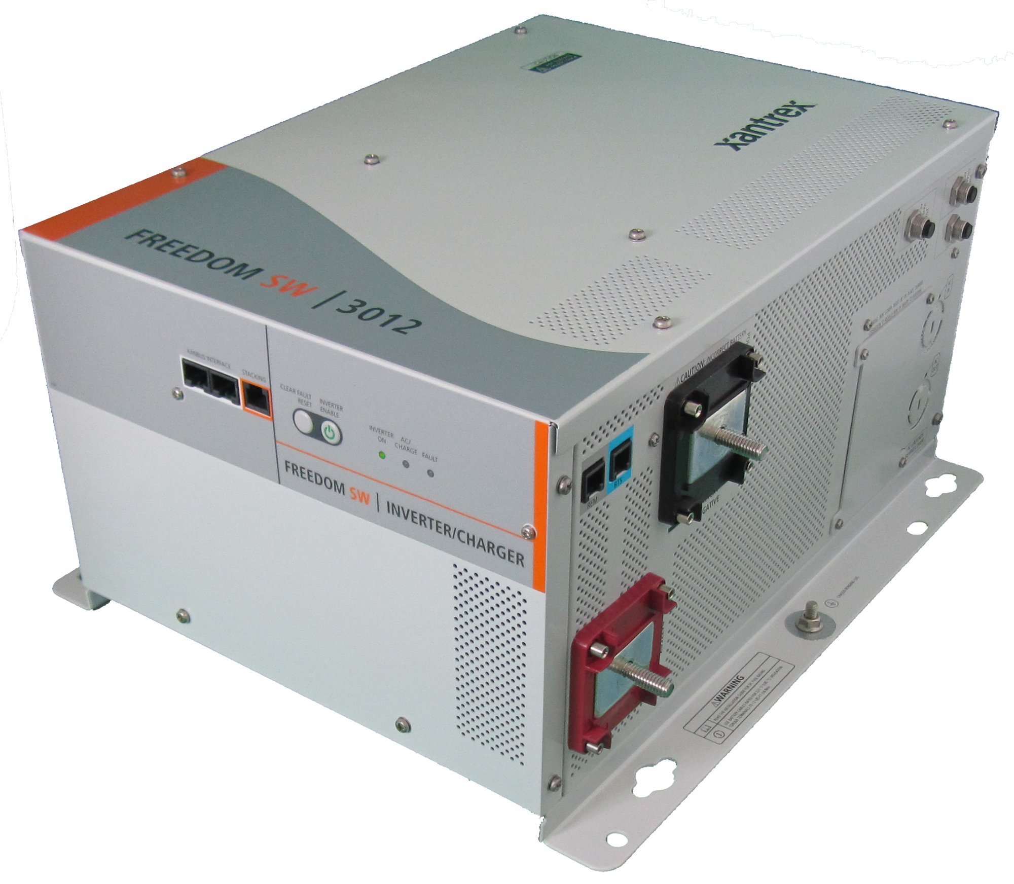

Due to damage from Hurricane Zeta, I had to replace my Freedom 20... to this newest Inverter/Charger
Freedom SW 2012 100 Amps DC.
This has Ethernet controls and New Interface and much more adjustable to fit most Lead/Acid batteries to equalize.
From that manual's Graphics...
And the instructions...
